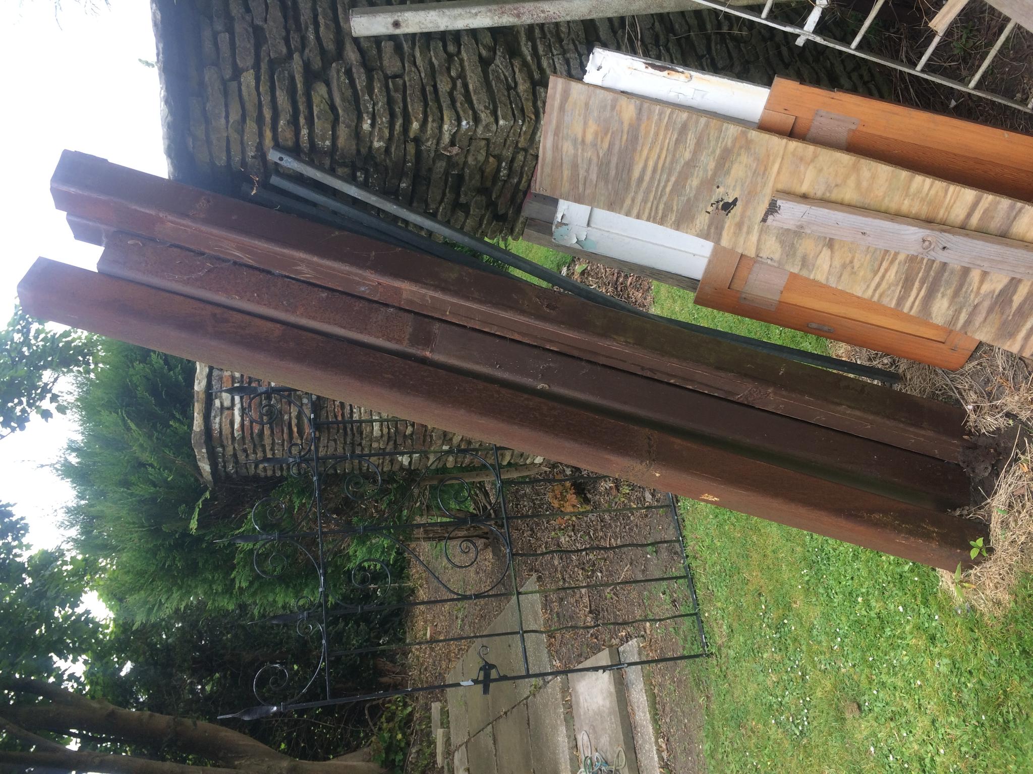

    Right well I have finally moved back to the uk, I thought it was best to wait until I was back so I could have a bit of time to re asses, think and deside what I had room for and also take a look at the steel that I was given. It is 100x100 x5mm wall so a little heavier than what people have said so hope that is ok and I have nearly 20m in total so should be plenty there although was thinking of making the legs of something a little lighter weigh?
    I have decided on a work area that will allow a max 1220 x 600 to be cut but with the focus on aluminium and forget full sheets for the moment.
    I don't really want to do the hole epoxy level thing so will need to figure the best place to build the adjustment in to the axis's
    If it is easier and up for the job I will use aluminium extrushion for the gantry.
    So back to the drawing board and to start planing how to do the frame.
ID:	21555   Click image for larger version.

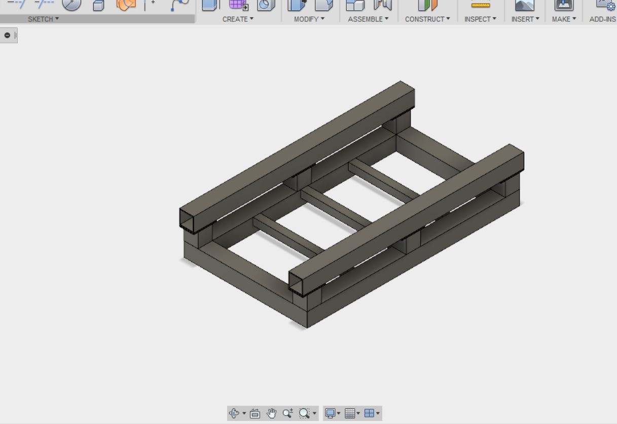

    just trying to get the basics down see what you think.
    the frame is the 100 x 100 x 5 steel tube i was given
    I have the two top rails mounted on plates on top of the short verticals to allow for shimming. I will see get the top rails machined flat before so and maybe one with a straight edge down it for the linear rail to butt up to.
    I need to obviously put some diagonals in somewhere I guess
    at the moment I have the 3 cross members at 50 x 50 x 4mm with 330mm centers ?
ID:	21603   Click image for larger version.

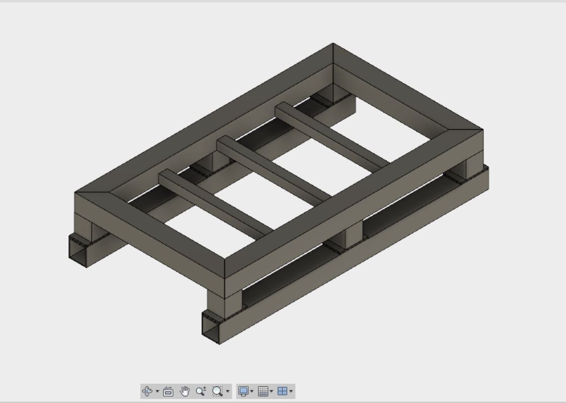

    I did a little more adding the rail detail and some diagonals.
    I keep reading about everyone using the aluminium L style gantry, is this only suitable for wood cutting? would I be better off with a steel arrangement for cutting aluminium?
ID:	21605   Click image for larger version.
