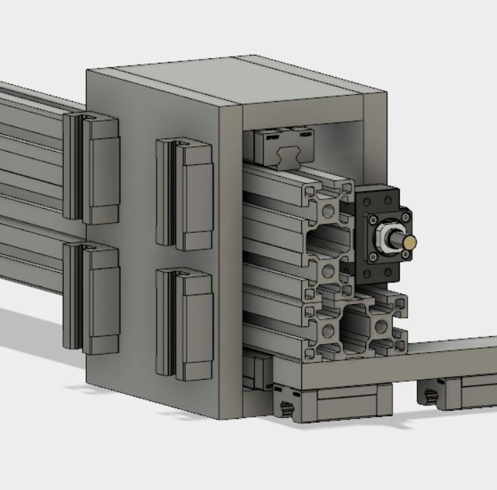

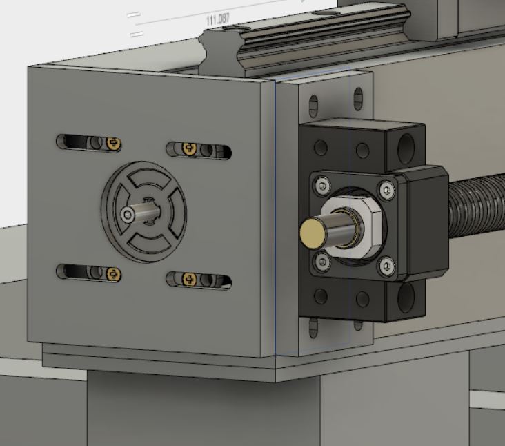

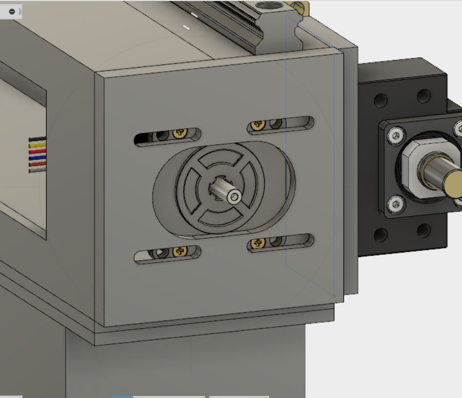

    yes I have that recess drawn in there it should be fine getting it in and then will just tap the holes on the motor
    like I mentioned I'm a bit worried about getting the bk blocks all lined up so thinking maybe make some plates up like in the pic just to allow 1.5mm ether way incase the holes are not perfect. but now just thinking maybe I would be better making a bracket from angle ali and using a fk support instead?
