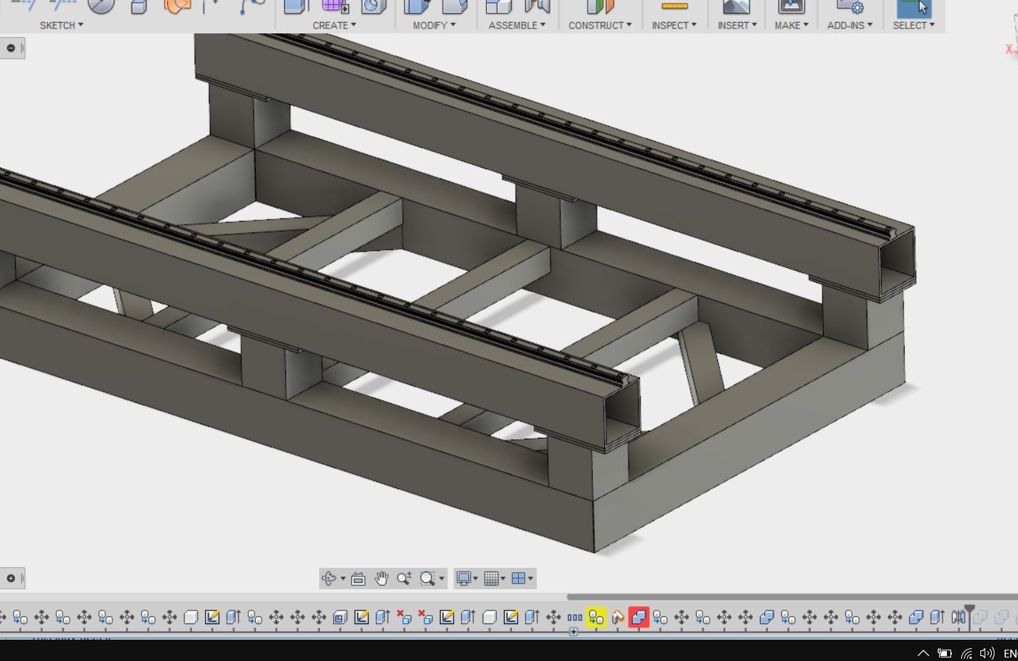

    I did a little more adding the rail detail and some diagonals.
    I keep reading about everyone using the aluminium L style gantry, is this only suitable for wood cutting? would I be better off with a steel arrangement for cutting aluminium?

  2. #32
    I have put a gantry together using 45 x 90 kjn extrusion as I think dean said you can bolt bk blocks and bearing straight to it I have it sitting on 20mm plates on the carriages and 20mm end plates.
    I have only put the drawing together to get a bit of a idea if I'm going in the right direction, dimensions may need to be altered.
    Any one got any comments on this? does it need to be beefed up or made in steel to get high quality cuts on alli?

  4. #33
    Does any one have any comments on what I have done so far?
    Can any one offer any advice on what ball screws to go for for the x y and z axis?

  5. #34
    It looks like a solid design to me. I dont think you'll have any problems with your frame not being rigid enough. I think twin ballscrews, one each side is a better design than one down the middle. They're easy enough to synchronize either with belts or just dual motors. But, I've never built a machine with ballscrews so judge my comments accordingly. Its very possible I may be totally wrong :)
