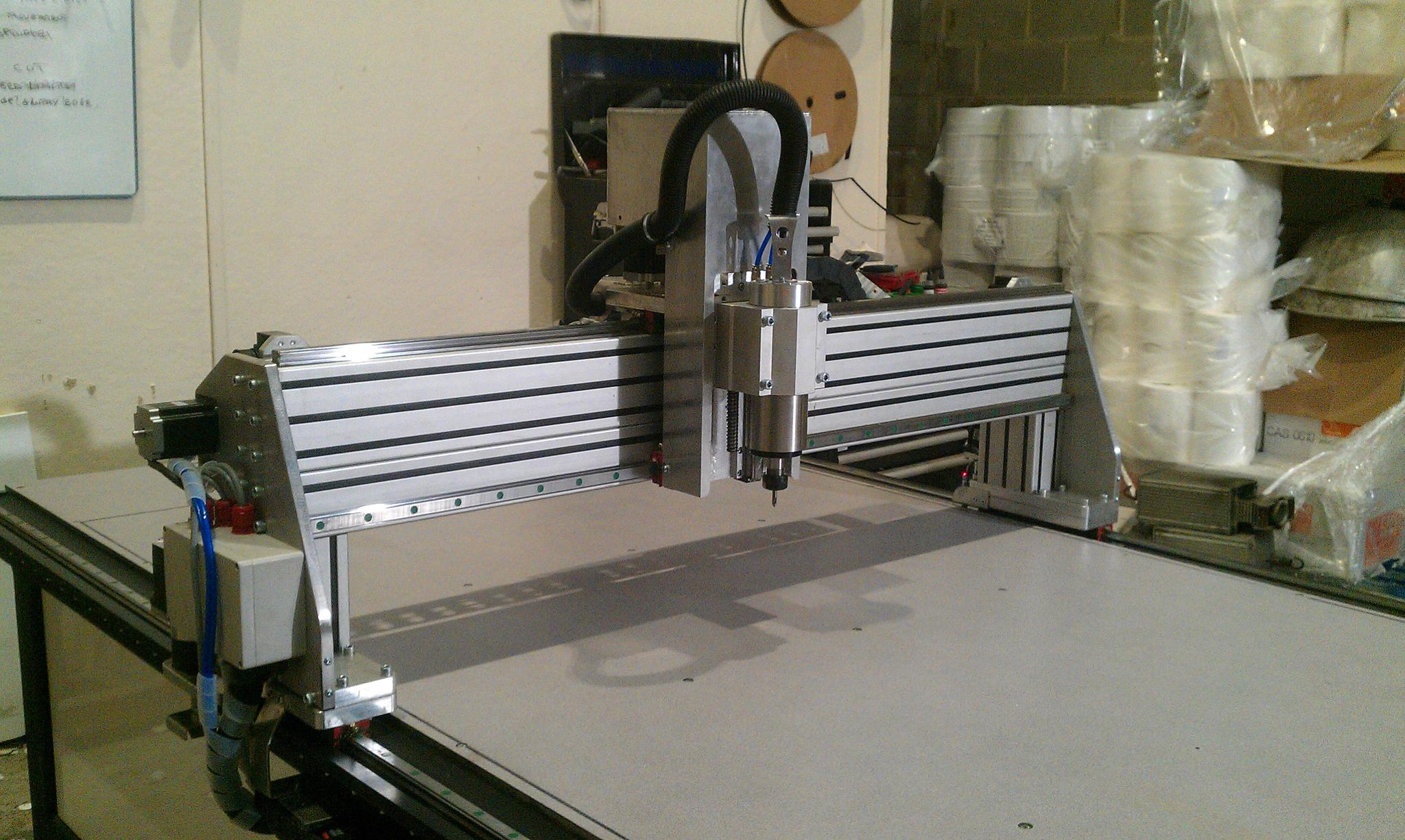

    Hi Charlie,
    Here are a few that work fine. Bit heavier profile 120x80.

    dean could I ask how wide you go for you y/z setup? 200ish?

    Go for it take what you like and if not sure just ask.

    Yes, 200mm is about right.
    Just note that in these pics the rails are on the back plate and bearings on the front plate. This is because these machines required deep material thickness's with long tools so Z axis needed to lift high. They also only going to cut wood or softer materials.
    If don't require thick material or long tools then Stronger Z axis can be made by putting rails on front plate and bearings on the back plate.
    This pic uses rails on front plate notice that it's highest Z position. Also notice Charlie 90x45 profile in L config.

    I wont need this machine to use particularly long tools but 120mm z travel minimum would be nice . Do you think this is doable with this design with the rails on the front plate ?

    Yes If remember correctly the machine in pic below is 120mm and that is using short gantry sides. Most I've built allow 150-160mm. That is total travel so got to factor longest tool to get actually Max material thinkness.
    Also if using the 120x80 setup you can gain little clearence and extra travel because bottom rail is on front not underside of profile.
