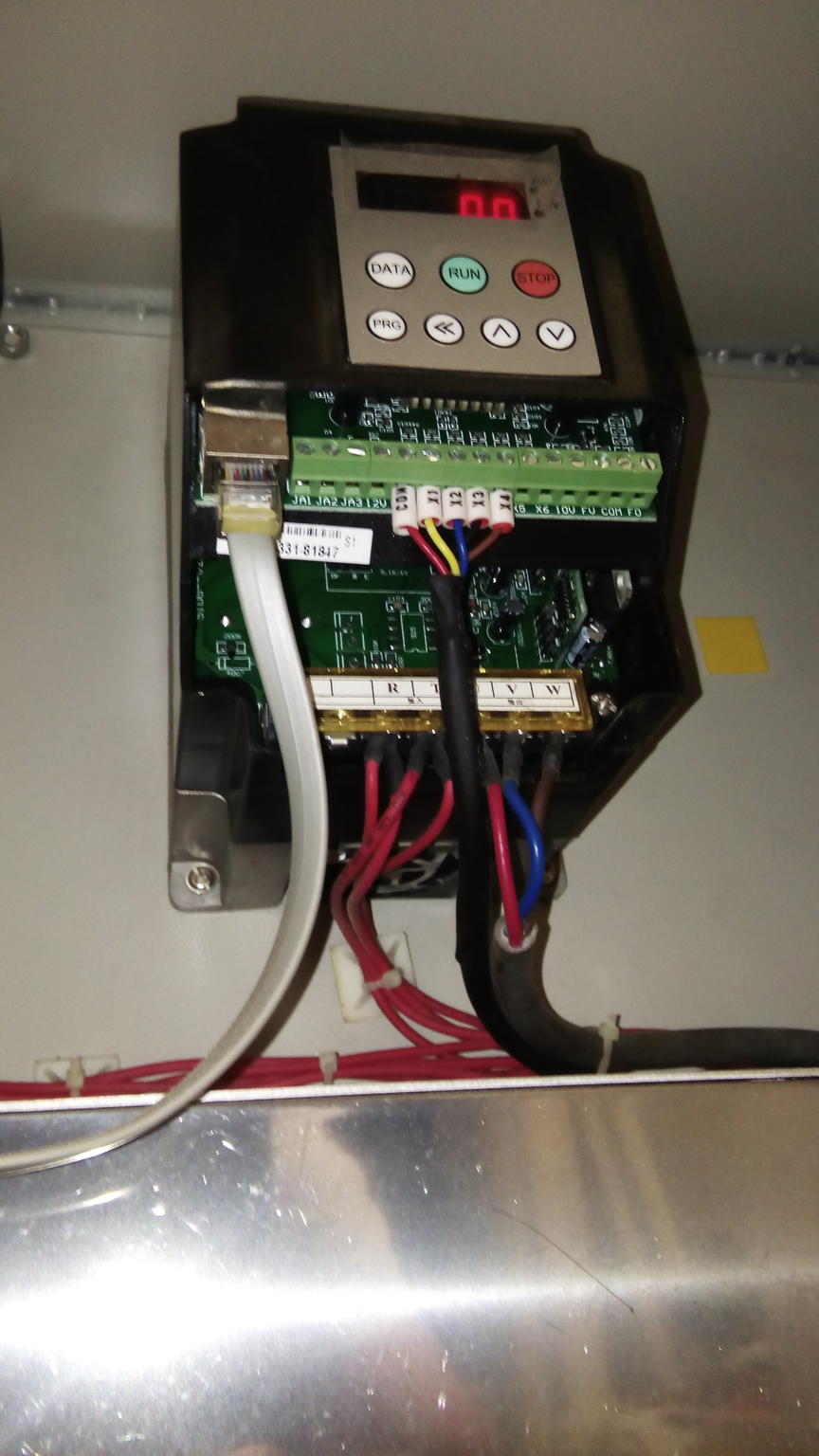

    then things like the vfd which I'm having issues with as it doesn't seam set up properly as I can only get 9000 rpm out of it.

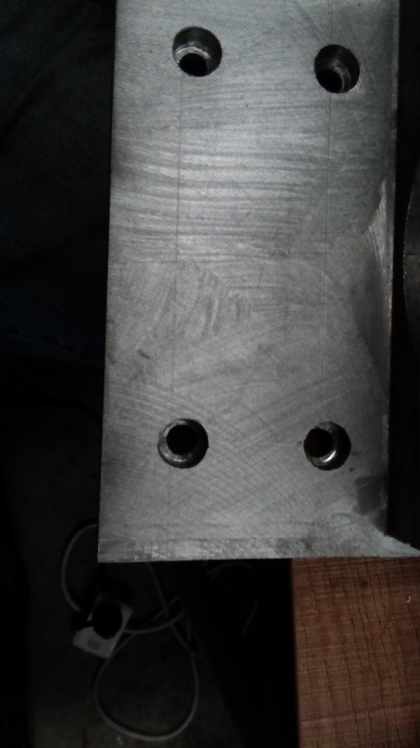

    Then again last night I went to mill the bed level with a 25mm bit and found that the z axis wasn't vertical (in the side to side plane) it was leaving a slanted cut on the bed width ways running down the length as it went. so I took the spindle mount of to see if it could be adjusted and found the holes and counter bores that were there looked like they were done free hand by a blind guy. The centres of the main holes were about 5mm of there target that they had scored on to the mount and then the counter bores for the head of the bolts were not even vaguely close to being centred with the smaller holes and they had just been done with a normal drill bit as you could see the taper at the bottom still! so a half hours work with the dremel to try and sort the counter bores I got to what I thought was the z axis vertical.

    I have spoken to the chap on CNC zone but not been able to sort it I'm now lead to believe that the vfd may already Maxed out.

    Many parts are cast, so thats why the holes are off centre.

    Spindles and VFd normally are Not a problem. Most VFDs have a Voltage input adjustment so it make regulating RPM very easy. All must be properly grounded also or you will never get stable RPMs
    Obviously all should be properly aligned and centered as i wouldn't trust a cheap machine has that right. meanwhile Locktite on all possible parts so to avoid future problems.
    Start with posting model of VFD here, i or others may help.

    The pic of the motor mount plate is bellow not sure if it was cad or not but you can see how shocking the holes are and no its not the camera angle making it look worse it was that bad!

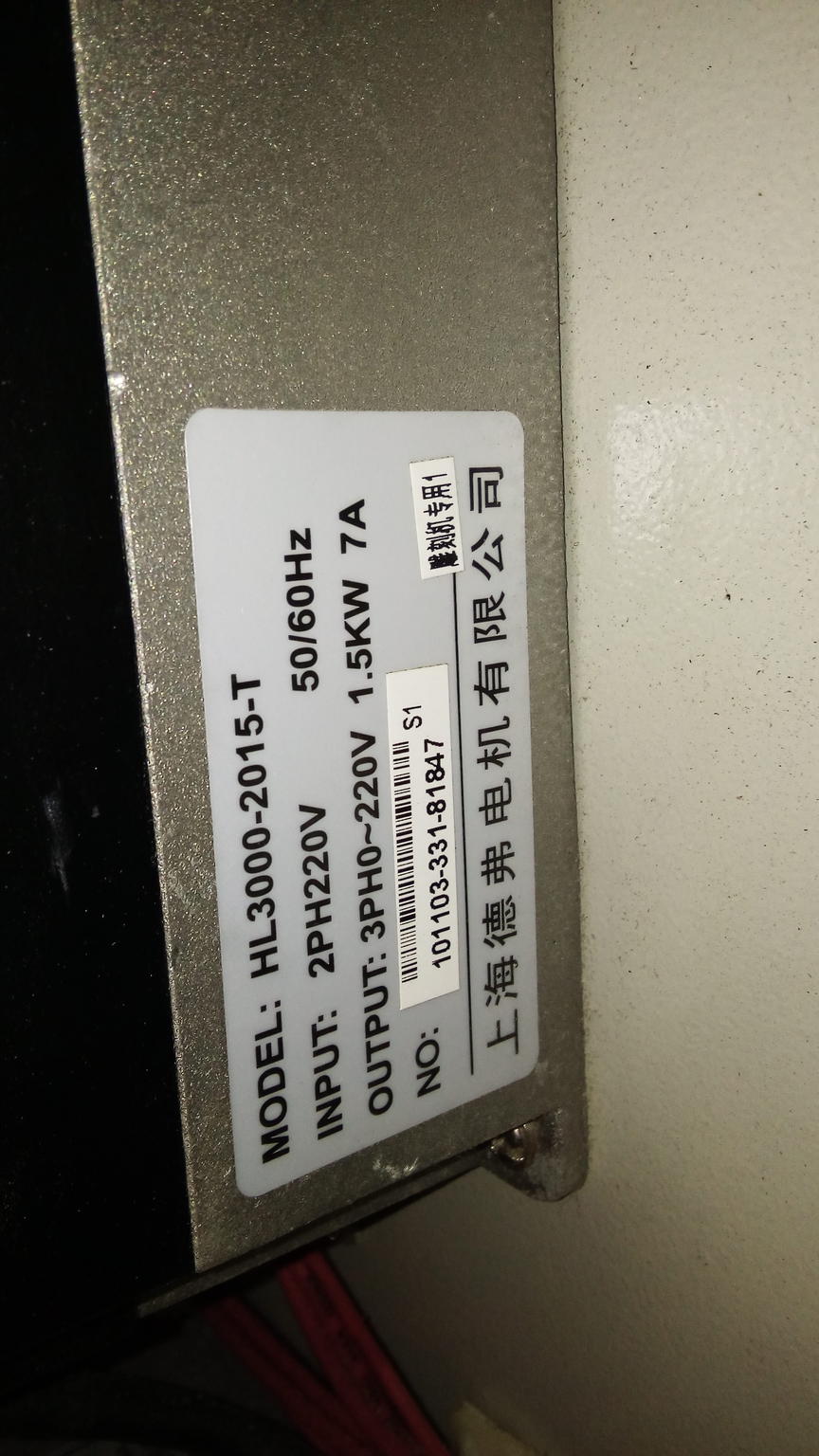

    The vfd is hl3000-25-t I have a manual I was given I will add the link. A chap on cnc zone has been trying to help but no luck yet, I'm not sure its us doing something wrong or the setting at the moment we have tried all sorts.

    So now is MODBUS connected? Bahh, then thats the problem, combine shady BOB and connect it using Modbus and chinglish software and manual and....
    For me is a no brainer. DDCSV1 controller for 150 euro, no Mach# or 4 PCs etc., connect to VFD , via analogue voltage control and voilaaaa.

    yes its that one! sorry I'm not 100% sure eactly what Modbus is/does. I will try take a few more pics of the wiring when I'm next there.

    Don't start changing anything without knowing that it must be changed and that it solves the problems. It may however help if you'd install a trial version of Mach3 and run that as well. Are you using Modbus to set the set the spindle speed? Are you sure that VFD is a real Modbus capable VFD? Most cheap Chinese VFD are NOT real Modbus. The manual pages are just lousy scanned picture, not pdf, so you must read every word, can not search. It also seems incomplete because the communication is not described. So, if you run Modbus I would suggest to go back to basic digital control, in fact, start with manual control from the control panel. Take the next step when that works.
    Could that be that spindle is only controlled by the buttons? Then thats easy, i can look at manual and tell you the things that has to be changed from default to what values. But the Rj grey cable where it goes? The telephone like cable? Thats the Modbus. But in manual i dont see modbus control. Where goes that grey flat cable???
