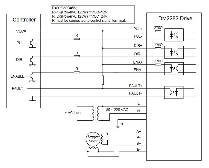

    I’m looking at 2 different drivers for a 8,2Nm Nema 34 stepper.
    Options are the Leadshine Am882 or DM2282.
    I calculated the maximum stepper voltage to 66V. (8 wire, 4,2mH, 6,4 A in Bipolar parallel.)
    The PSU that I would build for it would give about 75V, I guess it won’t hurt but... (Writing this made me see that the DM2282 seem to be the better choice all things considered.)
    One question remain. I haven’t really got what the output voltage to the stepper would be using the Leadshine DM2282 mains driver??

    Regarding the DM2282, the manual says "theoretical output voltage of 80~220VAC" and that it has a "motor auto-identification and parameter auto configuration feature" which should take care of the output voltage for you.
    The Am882 needs DC power supply and the way I interpret the manual that you have to be more careful with that one. I think the output voltage will be the same as the input voltage, according to my measurements on my driver.
    I am not sure which one I'd chose, but probably the DM2282 because that does not require a rectified input voltage and can use the AC directly from the transformer.

    The way I interpret the manual of the DM2282 is that it can use DC or AC supply. The DC input range is 115~305VDC and the AC is 80~220VAC. It is NOT the mains you normally connect to the input directly, but through a transformer.
Name:	DM2282 connection.JPG
    I see two major reasons for this, one is personal safety, the other is that the mains in Europe is NOT 220V, so I would not connect it directly to the mains. Basically, if you want to build a PSU, that's fine, but regardless of which, you don't need it if you use the DM2282, you just need a transformer, but if you build one you can still use the DM2282 because it can use both DC and AC supply.
    Here is a link to the manual, in case you have not seen it yet:
    http://www.leadshine.com/UploadFile/Down/DM2282d_P.pdf
    My guess is that the output voltage will be (if using AC as supply): 1.41 x the AC supply voltage. If DC supply is used then the output will be the same as the input voltage if measured as I measured the voltage.

    JW, either drive would work. If you never run the motors at high speed (or not for long periods of time), then a higher voltage should not be a problem. A higher voltage would give better acceleration/performance, but the big risk is overheating the motor. That could be counteracted by reducing the current, but then you would lose torque.
    You do realise that even though the DM's are high voltage drives, you still need to provide an appropriate input voltage? So the only thing you would realistically save, is a bridge rectifier and capacitor(s), as you'd still need an appropriate transformer.
    Yes, it is VERY important to use a transformer since 230VAC x 1.41 = 325V and that is VERY high for steppers and extremely dangerous to use in our DIY machines. I am not sure that the steppers will survive that, not even for short periods.
    Yes, i realise that, now. I thought the DM2282 had a built in PSU ready for mains DC.
    As i mentioned above, optimum would be about 66V for the stepper and the PSU would give about about 68V IRL if use a 50V transformer.
    AM882 can be supplied with up to 80V and handle 8,2A so the figures add upp pretty nicely.
    Leaning towards 3x AM882. (Can they be bought fair closer than China i wonder?)
