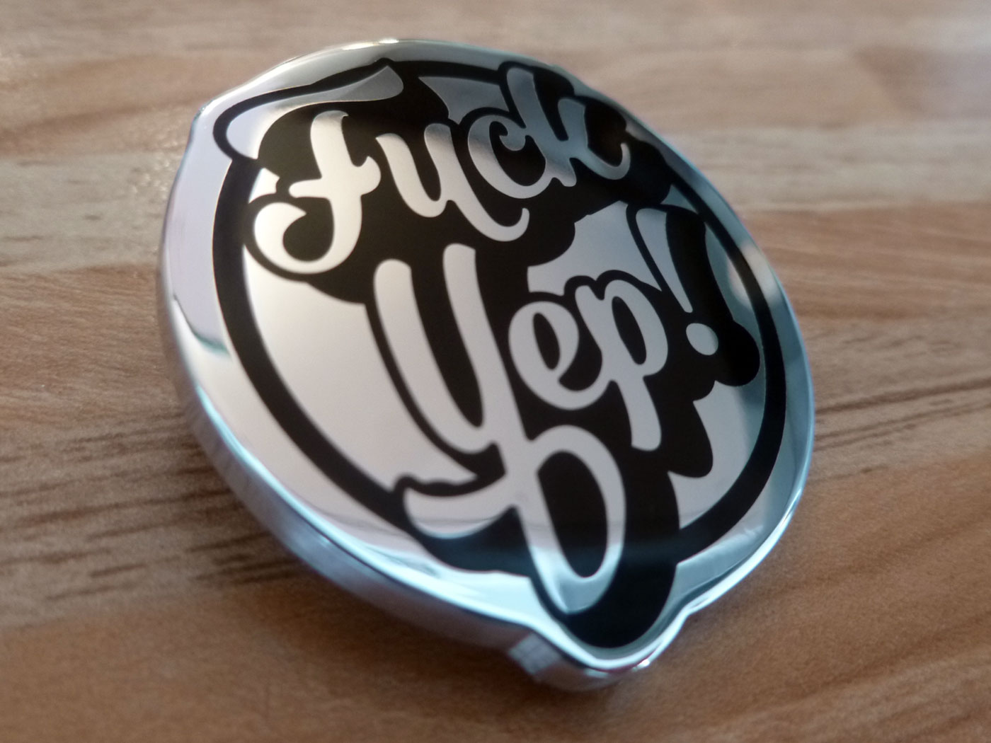

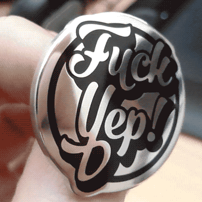

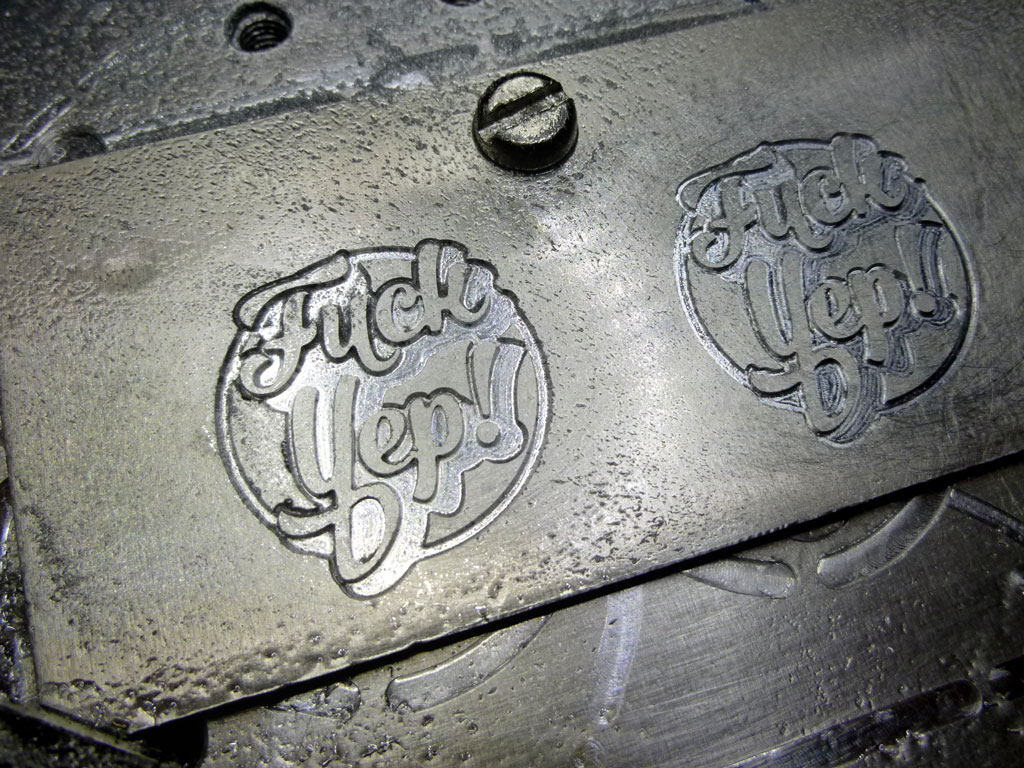

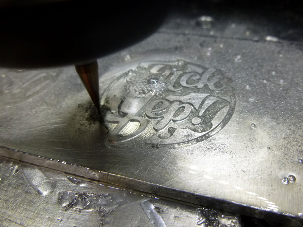

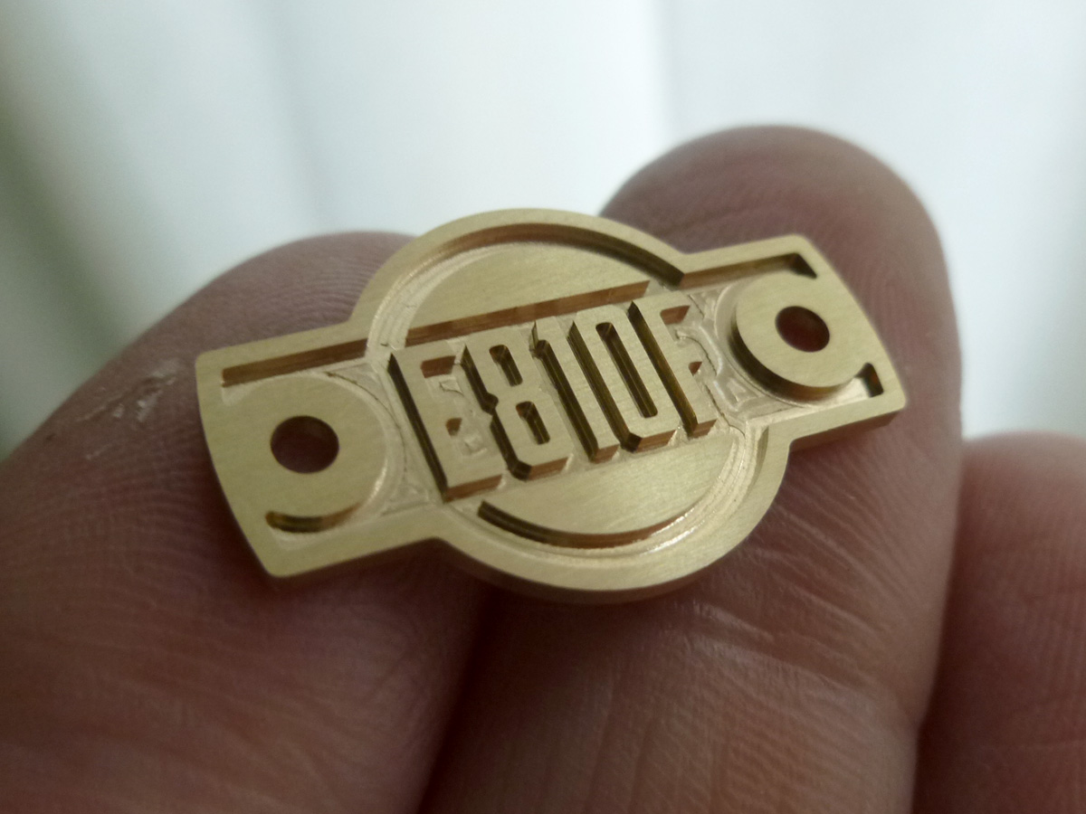

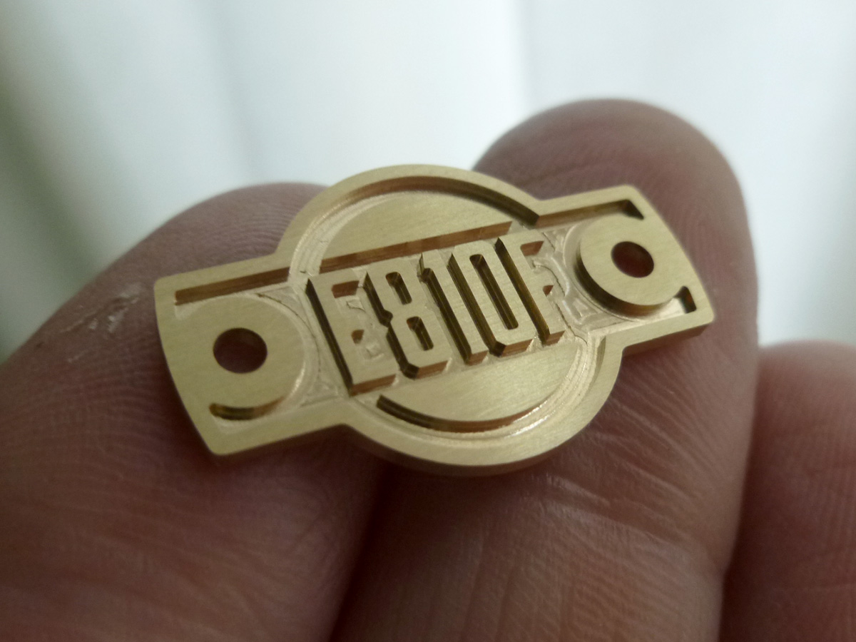

    I've been wanting to make myself a couple of badges for a while. Picked up some brooch backs off ebay and had a bash at making over the last few days. Results are good, I'm getting to grips a bit with the epoxy and polishing techniques, but it can still be a bit hit and miss.

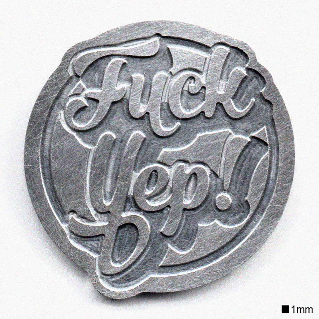

    Here's one I made - 3 tools: 2mm pocket, 1mm pocket and then a 0.5mm profile. Would have been nice to experiment with Fusion 360's REST machining feature here, but I'm not confident enough to switch to using it and in fairness, until I've worked out which parameters I can 'ignore' in 360 the Vectric software is a LOT more user friendly...

    From 3D viz through to final badge. Of course, it's massively inefficient to make a load of badges this way, but as a one off the quality is great and it's always excellent to be able to make your own stuff..!
    Wal.

    Hehe - You're absolutely right - 'Yeah' is the official standard - I went for the slightly awkward 'Yep' because it looked better (and I'm a bit awkward like that..)
    The finish - took a while to polish that in, damn micro-scratches...

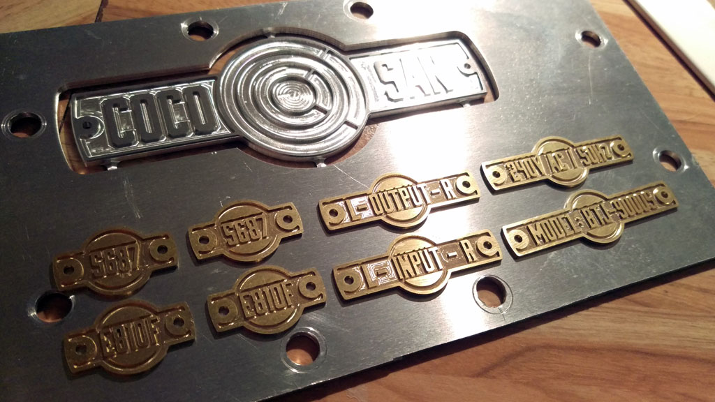

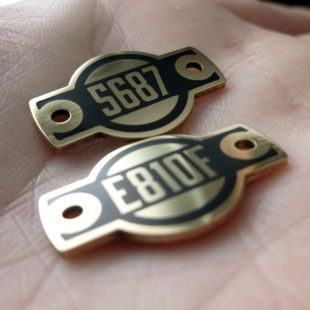

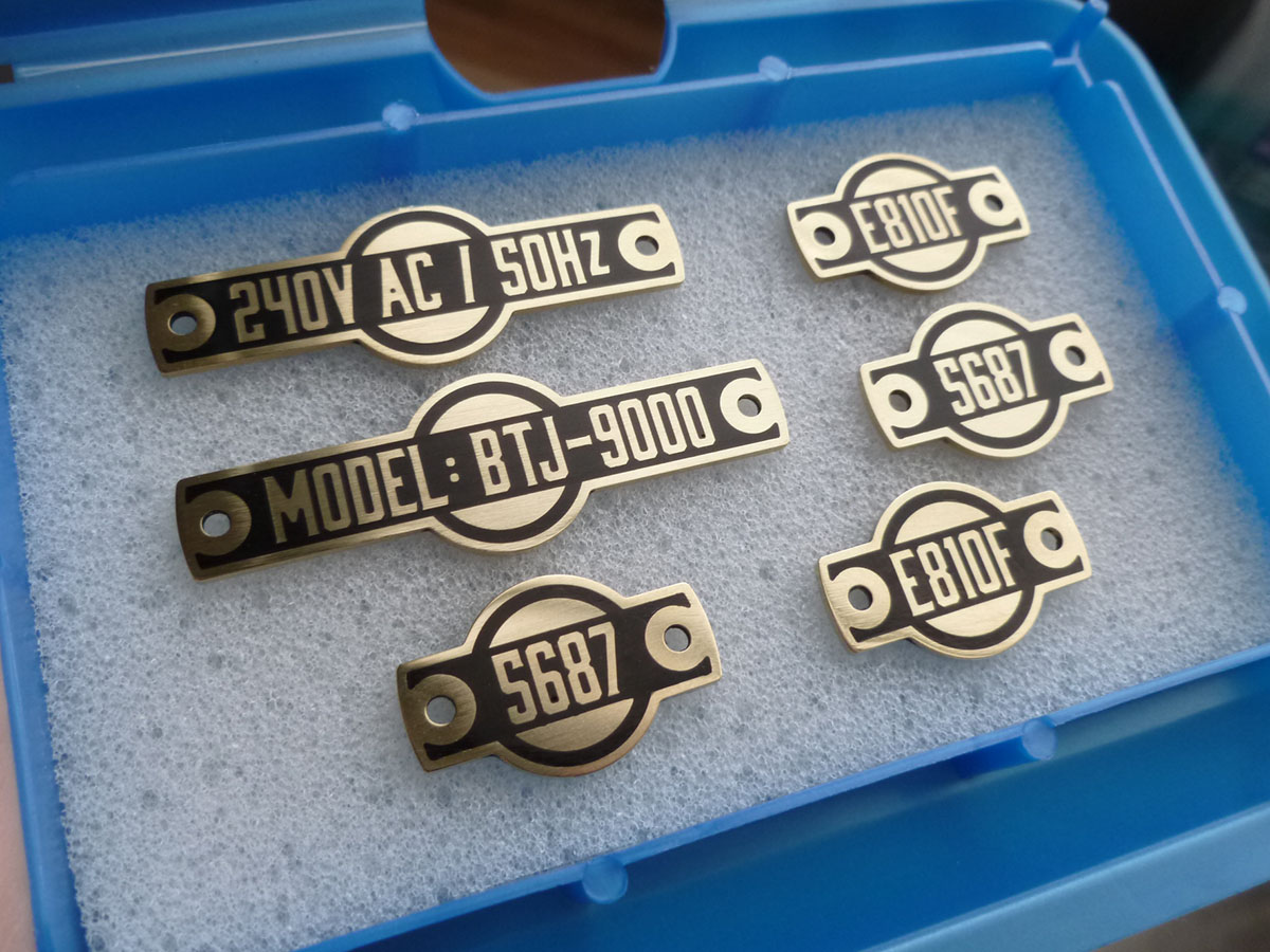

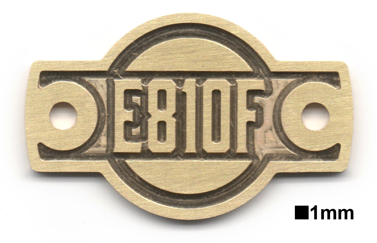

    Some miniature plaques made for a friend who builds high end hi-fi amps. The small ones will sit next to their respective valves (viewable through the glass top) and the other two will be mounted to the chassis at the rear of the amp. Heh, the badges for this amp cost about what most people spend on their stereos - well, maybe not, mates rates and all that - but still...

    Not quick to make, though...

    Wal, these are very nice and inspiring. What is it you fill them with and how deep are you milling them?
  12. #10
    Wal's Avatar
    I use cold enamel - like this:
    http://brightenamels.co.uk/documents...e%20(2016).pdf
    It's good stuff, but can be tricky to mix in small quantities, ie. 0.1gm colour + 1.9gm resin +1gm hardener. Too much/too little of one or the other and it doesn't set properly..!
    If I'm using >0.8mm cutters I'll cut to a depth of 0.75mm, anything under that I'll keep to around 0.5mm - in both cases it's probably too deep, but I get paranoid about belt sanding through the epoxy..!
