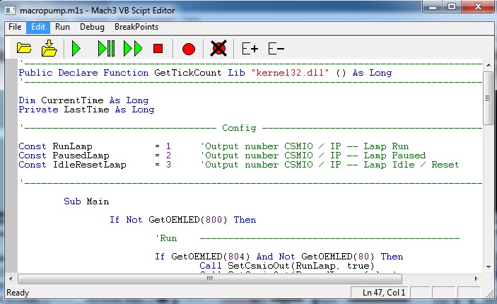

    Ah but he's not using the IP-M so can't talk directly to the controller like you can and bypass Mach3. Now your going to see little of the beauty of Cslabs controllers.
    To do this you need to turn on Macro pump option in mach3 config and use macro to talk directly to the controller to tell it to turn on the output when goes into reset. You will need to re-start mach3 after selecting macropump.
    Here's one I created to watch cycle start, feedhold and reset then turn on outputs when active. You can use it for the same job just don't use the cycle, f-hold outputs.
    I've set it to use output #1 but you can change it to any output# you want to use by opening file and changing the constant "idleresetlamp" found near top of file.
    Don't change the file name it must be called Macropump and put it in the Macro folder for each profile that uses it.
    Let me know if any probs but use it at your own risk I take no responsabilty if doesn't work or messes up.

    Hi Dean
    I follow your suggestion and got it light flashing before Reset is pressed.
    I changed output pins. So far output 0 is taken by HV Enable, output 1 by spindle relay, and I did not want to change it, only added output 3 for 'Lamp Idle / Reset', so when 'Lamp run' spindle should start
    Here is what I changed in pin configuration
    In General Configuration Run Macro Pump is ticked.
    in Output Signals Charge Pump signal is used with Port 10 and Pin Number 24, (Output 3, manual page 11)
    Had to replace my blinking Led to standard one:)
    I presume this macro is kind of light tower?
    Light stays on after reset, which is kind of industrial standard for reset condition.
    How to disable that light?
    What have to be changed in script please?

    Quote Originally Posted by Tom J View Post
    Tom Charge Pump and Macro pump are completely different things so if you have set the Charge Pump Output this could be why having troubles.
    Charge pump isn't used with Cslabs so clear this Output.
    Yes this is stripped down light tower code.
    Shouldn't do that it should go off. Clear the Charge pump output above and see if turns off.
    It did not, but not a problem as I changed IdleResetLamp to false when in 'Idle' so light goes of now.
    I modify the GetTickCount CurrentTime and LastTime so lamp flashes exactly like in Mach3
    Thanks Dean like always great help from you
