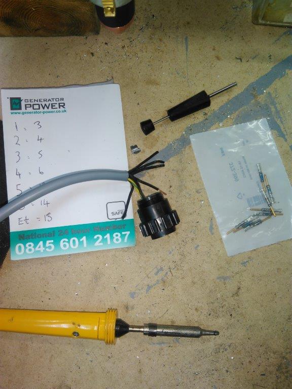

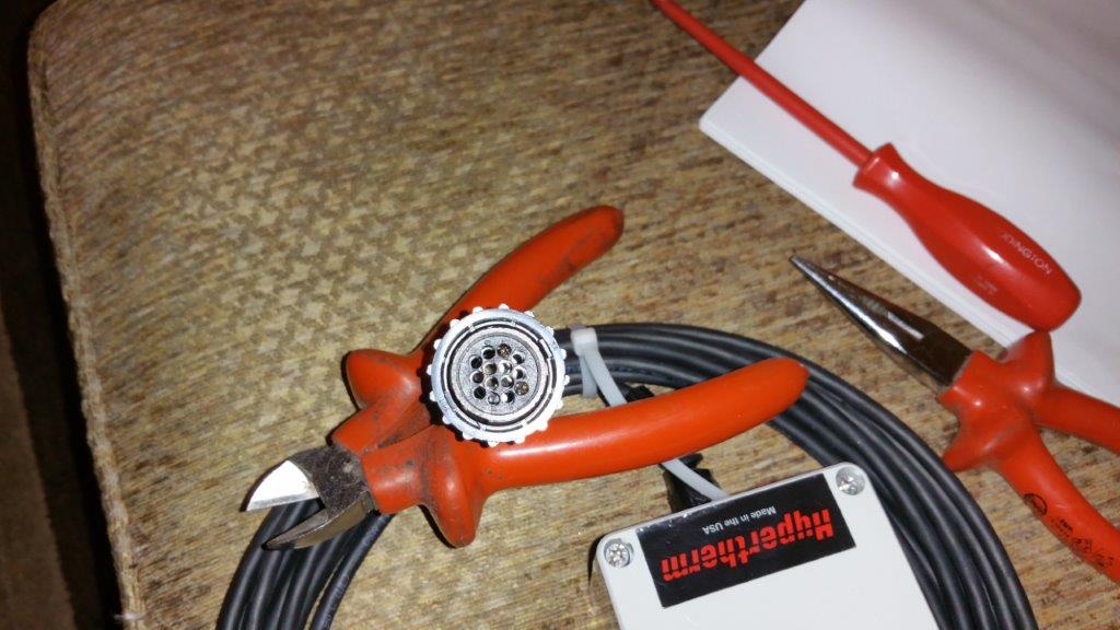

    I have bought the T45M and it came with the lead as shown in the photos below and i have a feeling that i will need another cable as this one only has 3 cores even though it shows 2 used.

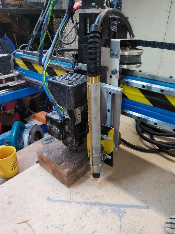

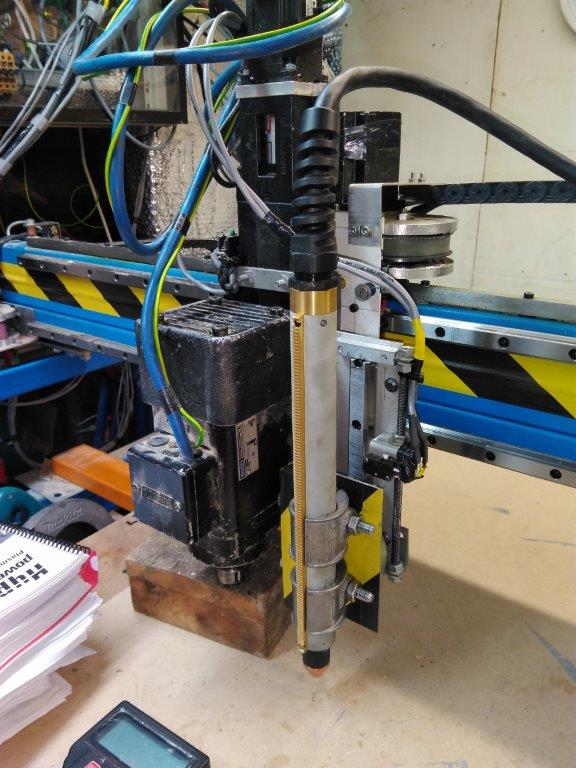

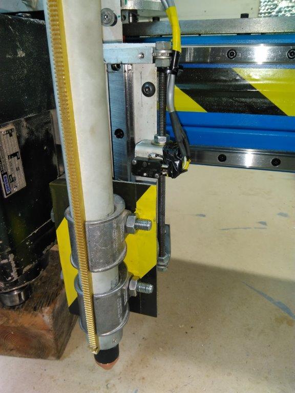

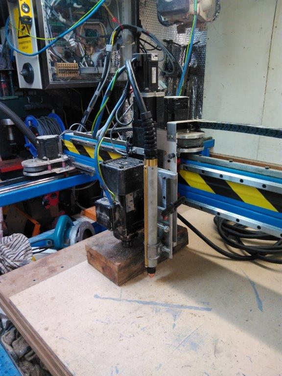

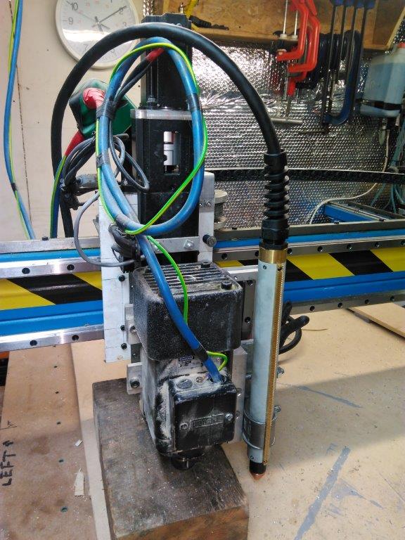

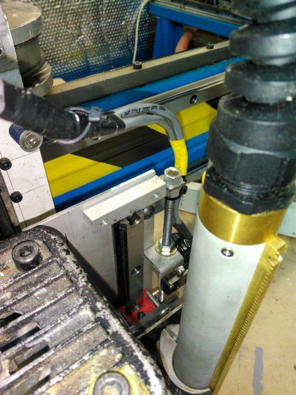

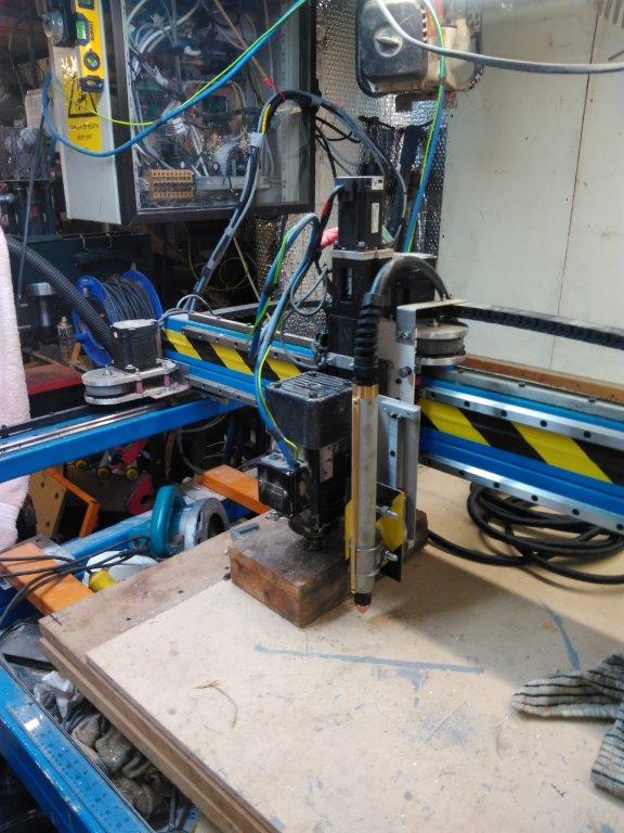

    Back again............done some research and have built a floating head and added it as a probe.
    This works brilliant but i cant seem to get the torch to fire with the cnc bob/thc whichever does it.
    See pictures of update below

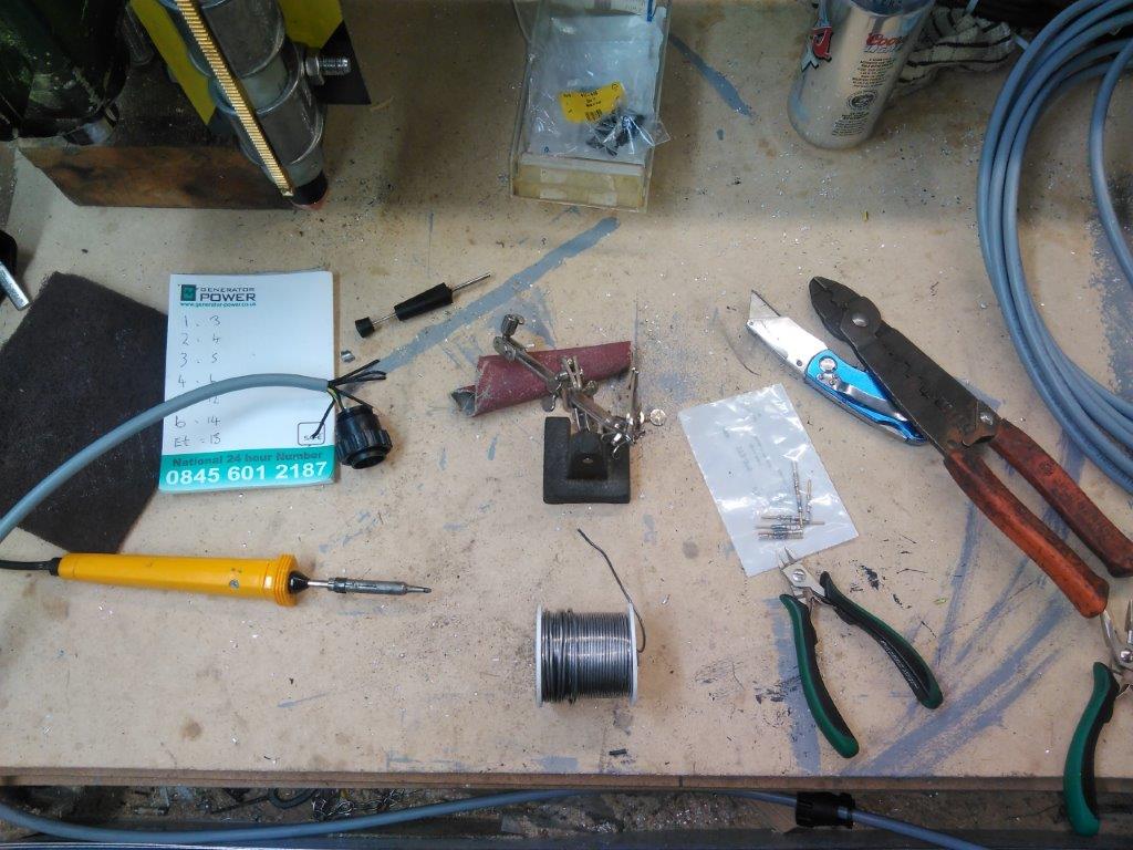

    I have bought a new plug and connectors / pins and have wired the plug to suit the diagram as requested.
    The machine wont fire from program and i think i must be missing some gcode or macro input as i have tried every conceivable combination of pins and outputs but nothing seems to work.
    I have got the full bought versions of sheetcam and mach3 so these shouldn't be a problem. the post processor i am using is the purelogic with fr one which was one off 7 available and it doesn't tell me which one is the best.

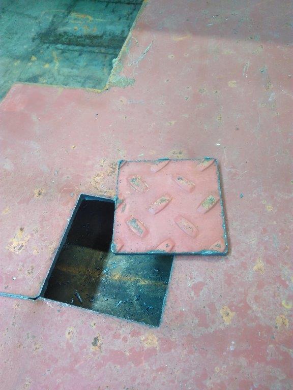

    I have used the independent button to start of arc and cut the following square as seen but i would like to get it to fire via the software / program.

    I think i am looking too deep into this firing sequence as i have used g31...g28.1 and even the kitchen sink but nothing works.....The purelogic THC uses ethernet to communicate with the bob so i wonder if this has anything to do with it.
    All boards and thc boards show up as requested but when i run the program.....it follows the gcode perfectly but no life from the hypertherm....
    Please has anyone got any ideas or comments / insults to be able to help me????

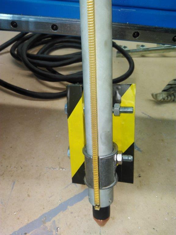

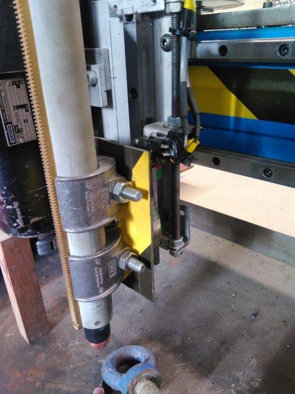

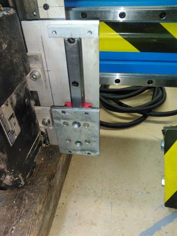

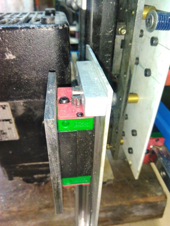

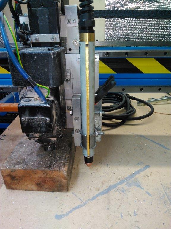

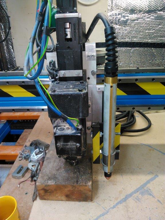

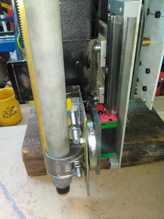

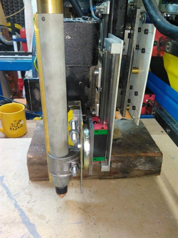

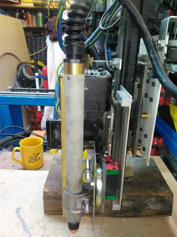

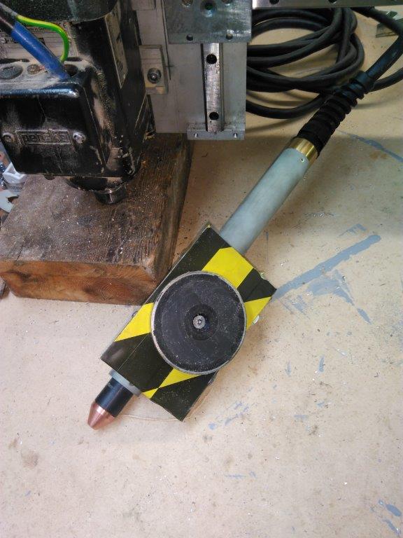

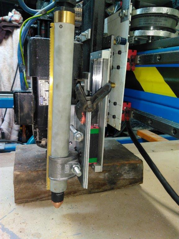

    The magnetic base was taken from a magnetic car aerial which was obviously stripped of all plastic bits "and drill through the centre and attached to the torch holder.
    The torch is held with two 1.25- 1.5" BICC cable clamps which fit perfectly around the torch.
    The torch is very "stuck" once attached but also detaches if it comes across an obstruction. There will be a micro switch attached to stop motion in case of a collision but that is to be attached.
    I used this type of magnet so that i have an infinite number of angles to choose from if needed.
    The torch and spindle occupy the same z axis as the is plenty of room on the table for both and i just cover it up when plasma cutting and remove the torch when i router with the spindle.
    Hope this helps anyone if they are looking for ideas.
    Cheers Tommy

    Hello Warwick....not had it firing from mach yet only from pendant button. I made my own plug as the cheapest i could find was £86 + vat from a uk source for a 6 pin version. I got the plug wire and pins from RS for less than a Tenner so this was a massive saving.
    The lead i made has continuity etc but i think im struggling with the pin outs.
    As the pictures show i have a purelogic THC which is made for the hypertherm 45 and this is connected with an ethernet lead so not real sure what pins i need if any. My floating head has a micro switch on it which i have configured for both Z home and Probe scenarios but nothing happens.
    I think i am missing some code / script as all the ones i have used have worked for finding top of material but i think i am missing the trigger scripts if that's what you want to call them.
    So basically if you have any ideas or could share your scripts etc, i will be very grateful as no doubt, once it works it will be looking at me straight in the eye.
    I do have the RS codes for the leads if anyone wants to make their own and save a massive amount of money instead of buying a hypertherm one.
