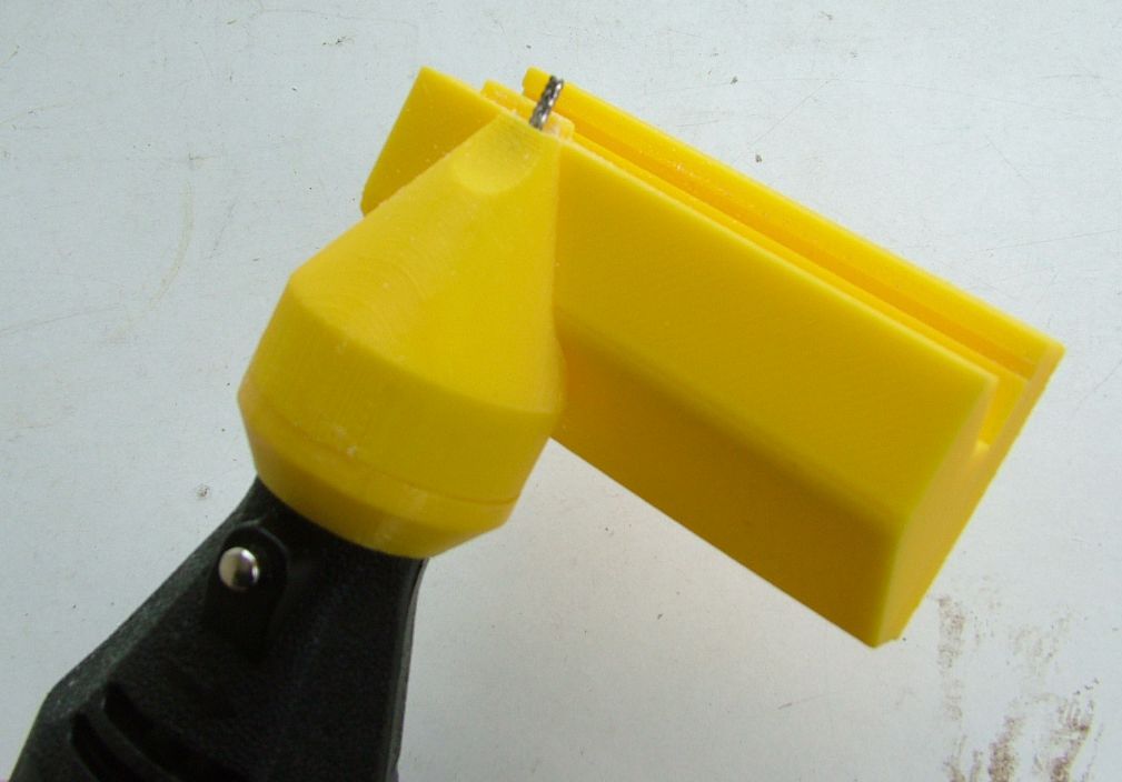

    there are things I could usefully make where tensile strength and surface finish aren't major issues
    Do it!
    I have 1400 faulty circuit boards that need a very precise trim to put them right. It was so easy to make a Dremel attachment and regain control of a tricky situation. The M19 thread for the Dremel nose had to go on a separate piece to get the grain right. Print time around 4 hours...
