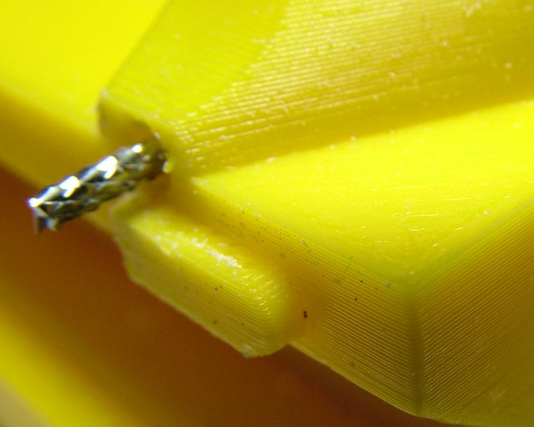

    The only way to tell is by extreme close up. This is 0.2mm layers of ABS Plus on a printer that has the folded steel frame and profile rails.
    Show is what you've got

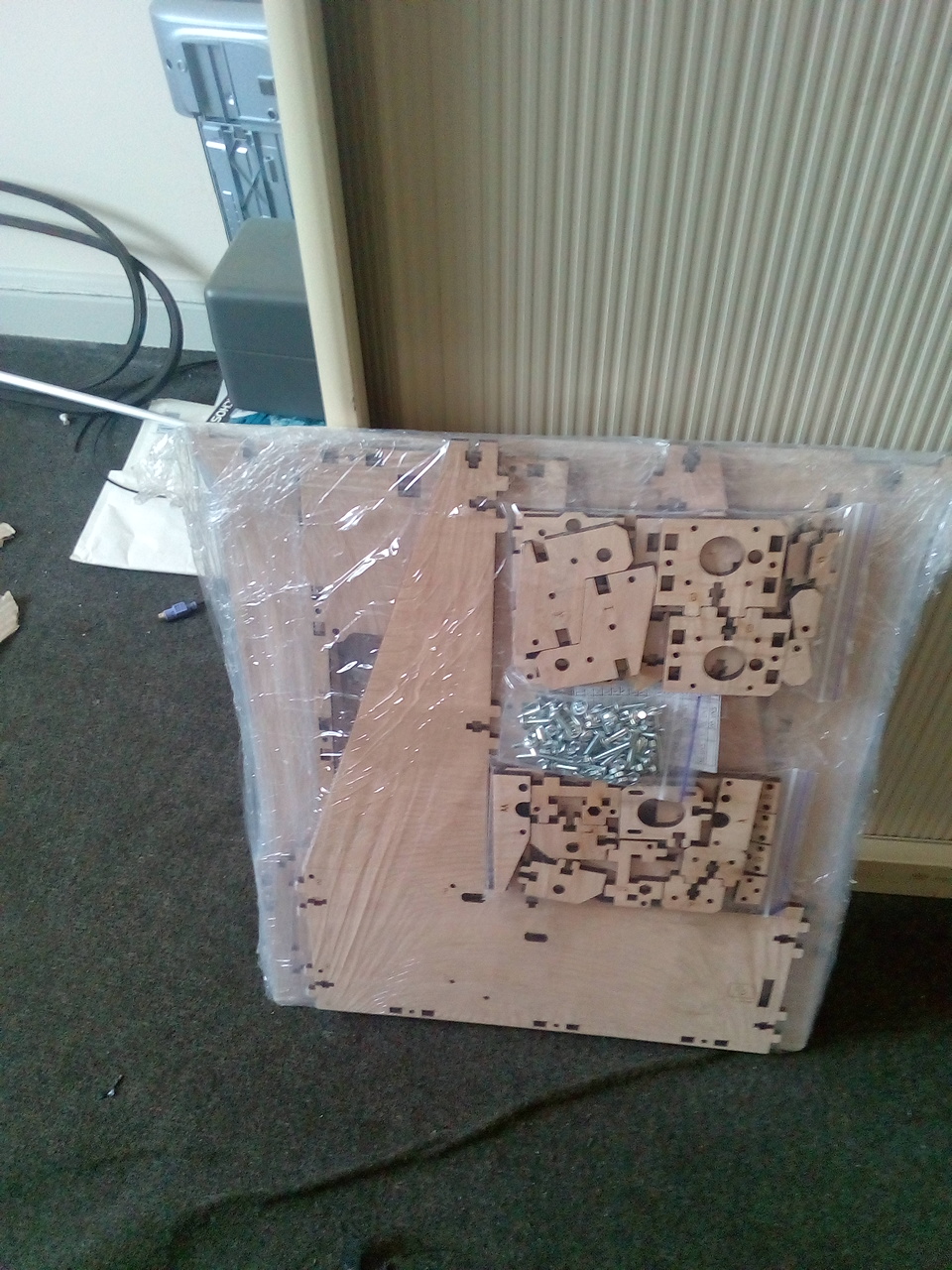

    I finally got my Graber I3 frame from Ukraine took about a month to arrive. I'm going to beef it up with metal corner brackets and modify it to take 8mm lead screws for the z axis instead of 5mm threaded bar.

    Anyone with access to a cnc could easily make their own Prusa style frame from ply, mdf or aluminium.

    I'm going to beef it up with metal corner brackets .
    Would you be better with more traditional methods for a wood frame?
    Wood corner braces bonded in place with Cascamite, or even Gorilla Glue might provide more rigid triangulation over a larger area than metal brackets.
    Pinned and glued is almost always superior to metal brackets and bolts and screws with structural wood projects.
