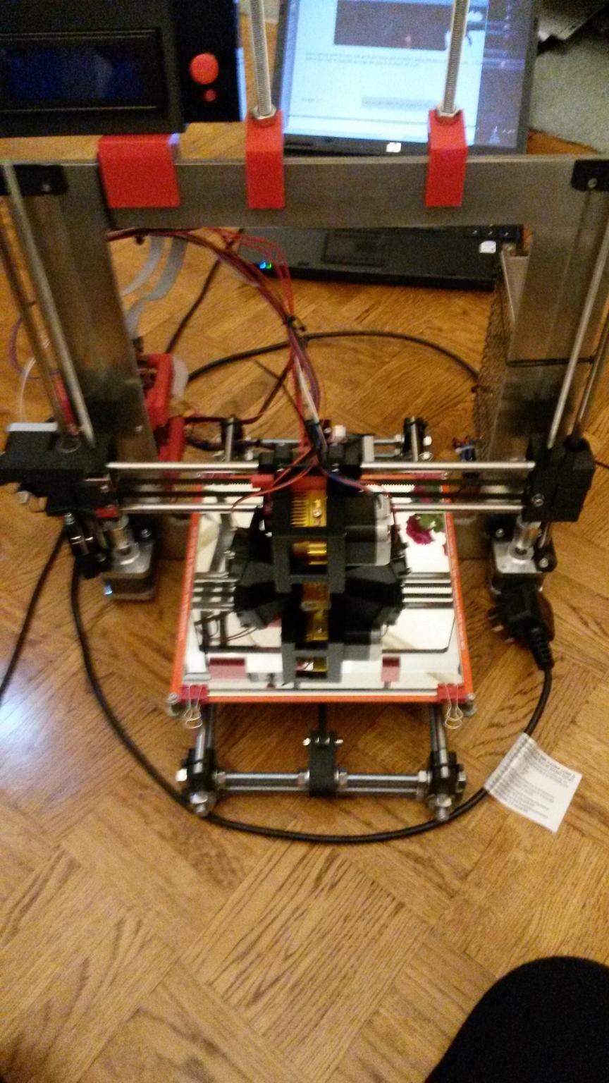

    Shipping from Factory 3D was quick, I ordered on Friday and it was delivered at lunch time today.
    Packing is very good with plenty of padding where required and individually packed sets of parts for each assembly stage covered in the instructions.
    The instructions are clear and easy to follow and everything goes together with little drama.
    I've finished the build but won't have chance for power up and testing until later in the week,

    Looks a nice Prusa, wondered what was going on with the extruder until I realised it was a mirror lol.
    You have the mk2 heated bed it takes ages to heat up for ABS but for PLA it's pretty quick. I recommend getting some cork board to insulate under the heated bed, this will really help with heating up times. Another solution is to change to the mk3 aluminium heated bed and power it with 24v but this is more hassle as if you send 24v to the ramps board without modifying the ramps first it will fry the arduino but there are a few ways around this.
    If you use the mk3 and 24v heat up times to 110c are ~ 2minutes, if you use the mk3 at 12v you will see no difference in heat up times at all. The Mk3 also has the advantage that being aluminium you can use a cheap inductive sensor. But I bet you already have autoleveling.

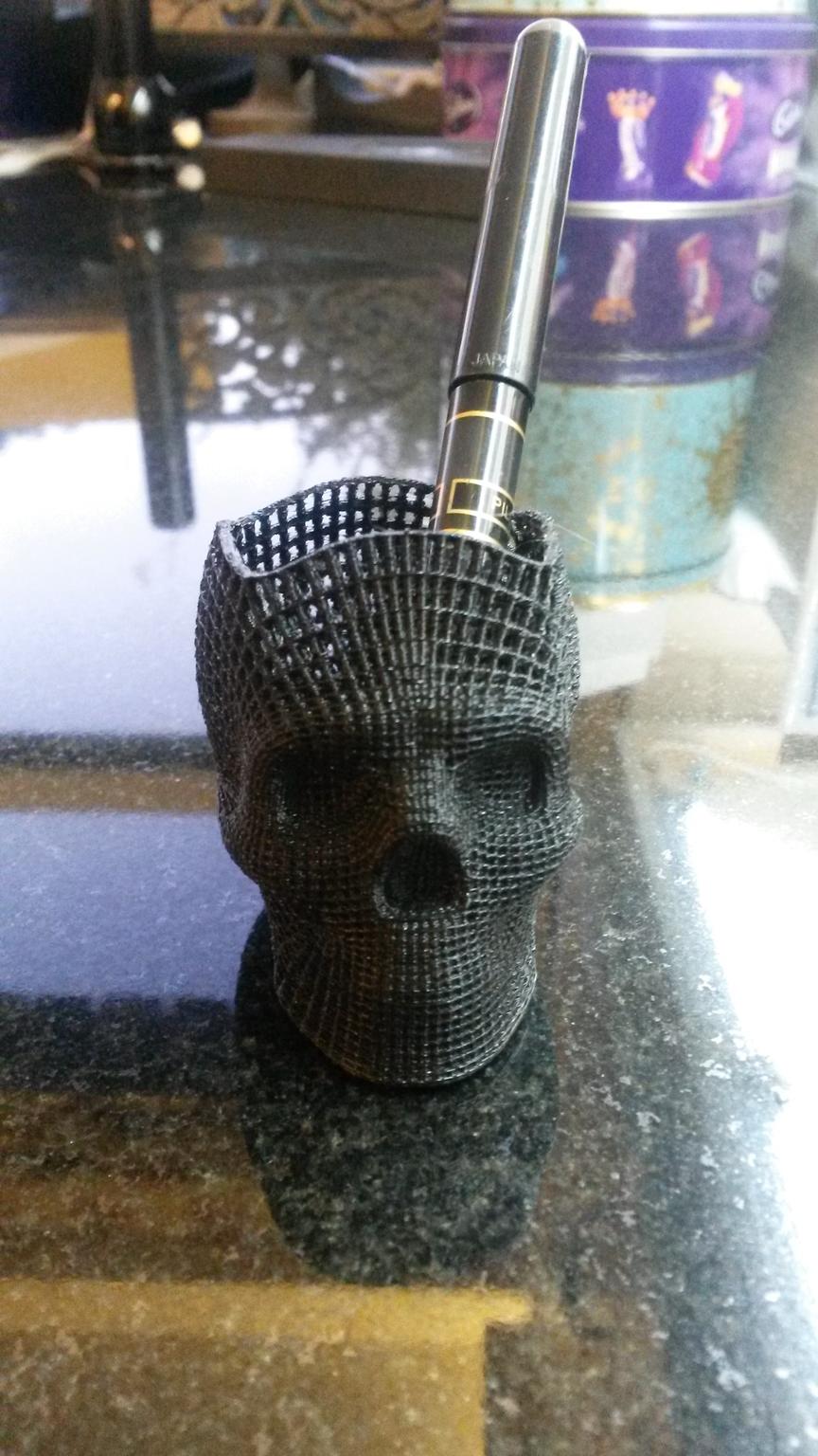

    My second print with the Factory 3D
    I don't know enough about what I'm doing yet to be fiddling with any settings, this is just with all the defaults as it came out of the box ;-)

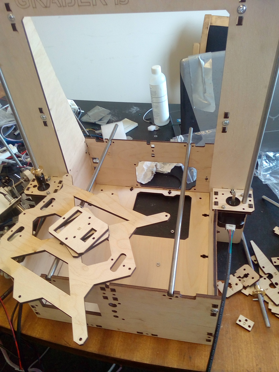

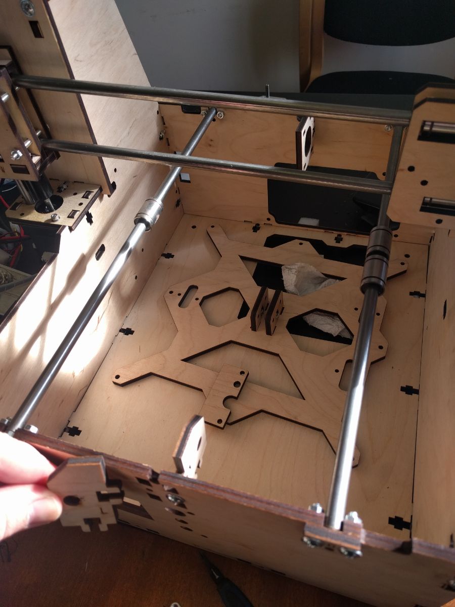

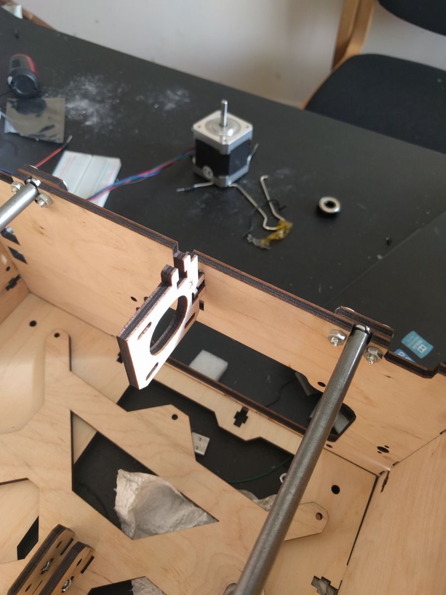

    Got my frame last week so yesterday I started to strip down my mendel and rebuild in the plywood frame. Immediately there were issues lol but nothing too severe got about 1/2 done.
    Issues were

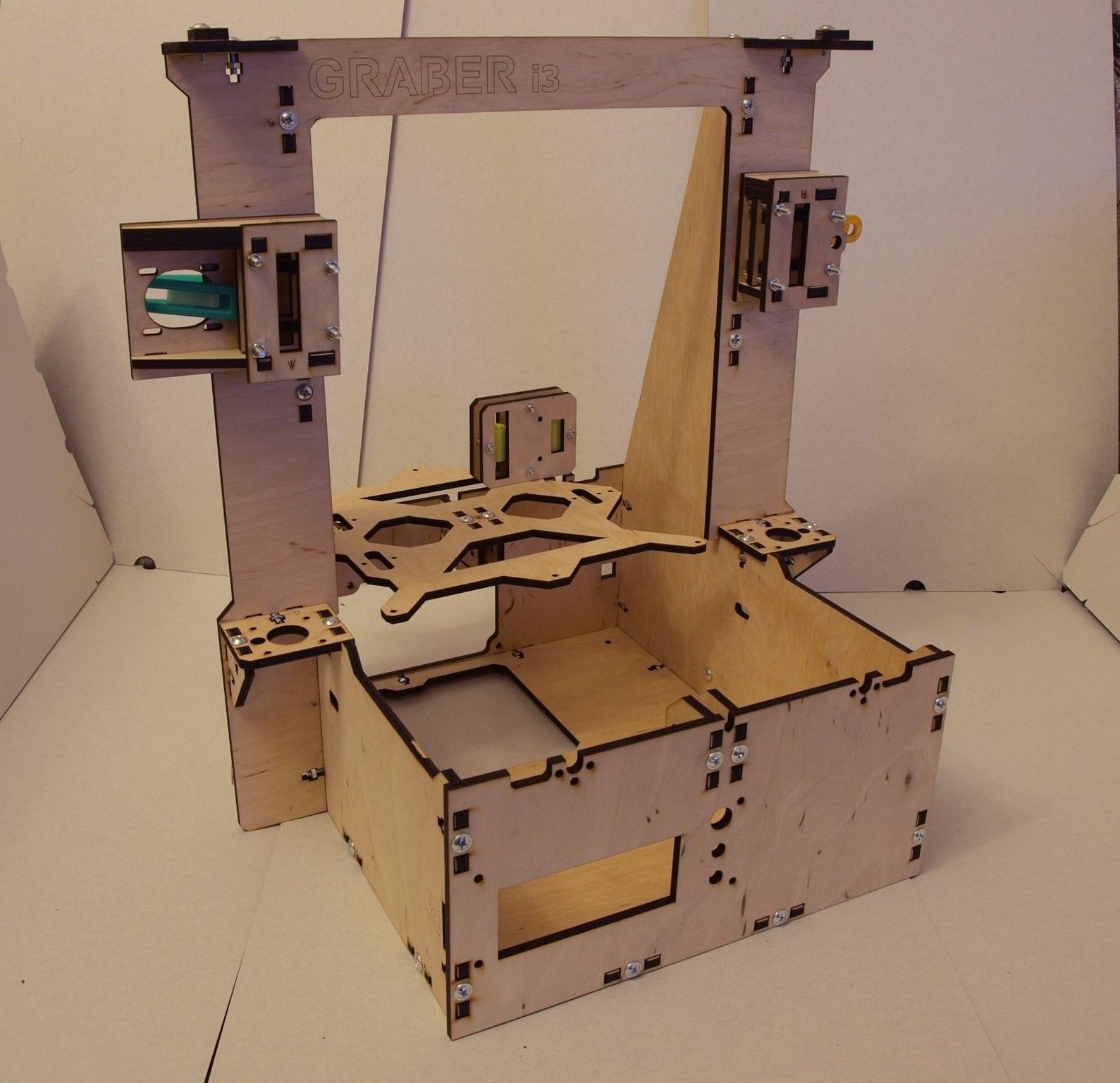

    1. No build manual, so we built using their photo as a reference, only after we mostly built it up did we discover their reference photo is incorrect lol (Or they reversed a part in laser cutting) the power supply would be on the outside of the frame lol the way they show it built.
    This is the picture they supply
    And this is the correct way (See how the power supply mount is orientated)
    If I tried to fit it the way they picture the power supply is mounts are in the wrong place and the power supply would be on the outside.
    had to flip both the back plate and bottom 180°

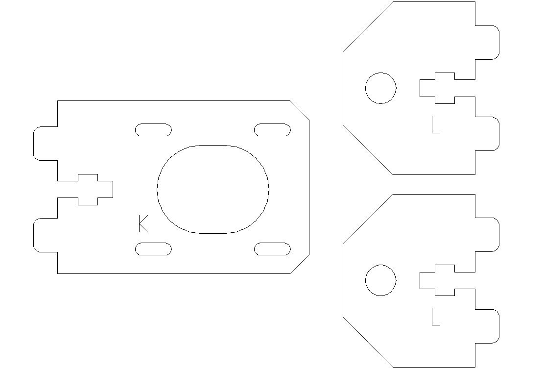

  14. #40
    Bastard 3 pieces are wrong I've contacted them but they are in Ukraine and took a month to get printer in first place very annoying I might need to finish my cnc router first before I can finish this :(
    I might try printing to scale and sticking the correct outline to 6mm ply and cutting out with a jigsaw.

    and 2 L's are wrong
Name:	L printer.jpg
    they should look like this
