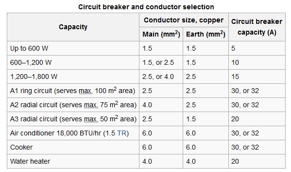

    Here is a chart showing what each size is rated at:
    Here is a list showing the watts to amps conversions:

    .Me
