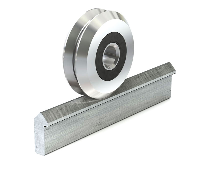

    first i working on design to work as router and 3d printer but i have limit in money
    my frame will be alumium 40*80
    so i admire this diy
    i think on using this instead of supported rail
    Is it good !?
    Sent from my ASUS_Z00A using Tapatalk
    Quote Originally Posted by alaamomen9 View Post
    Is it good !?

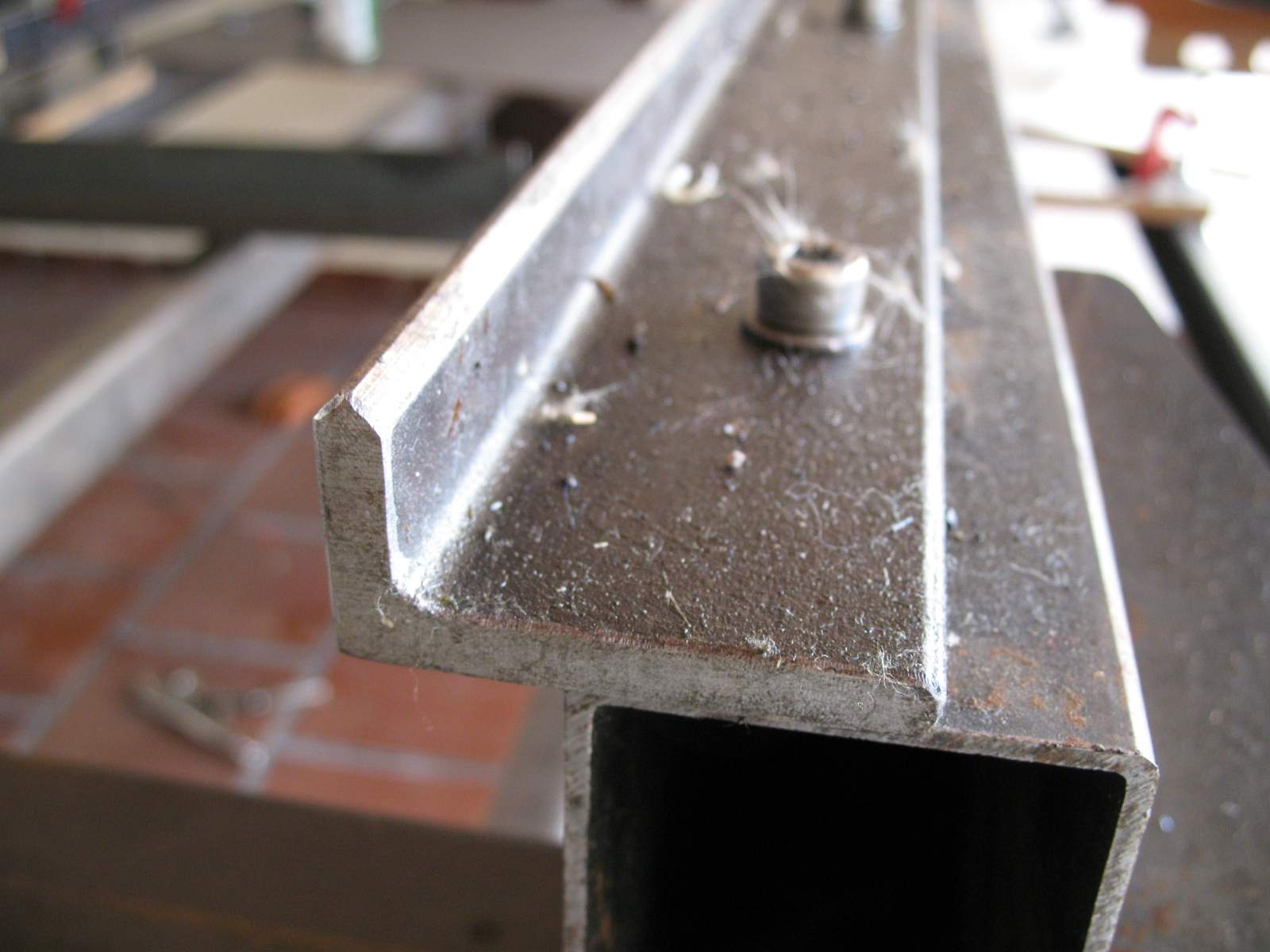

    I don't think that's a very good design for many reasons.
    If you are going to use it for a router, it's a very bad design as any debris(dust, chips,swarf etc.) would cause big problems.
    Also for any use, it will be difficult to make sure your aluminium frame is straight & level.

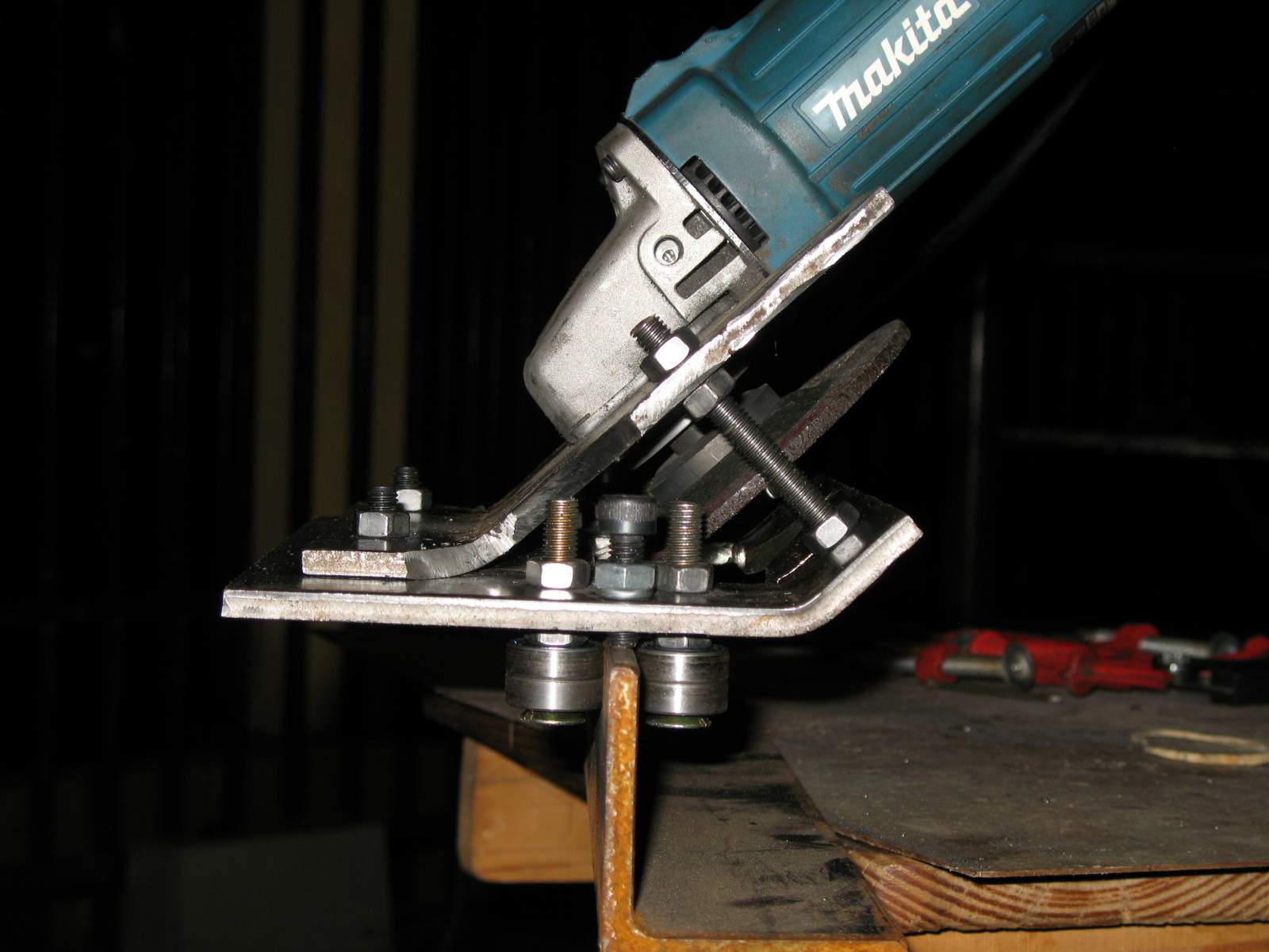

    Have you considered using vee rail?
    They can be made from cheap angle iron using a hand held grinder & simple jig.
    They are pretty tolerant of debris, and they can be aligned and shimmed relatively easily.
    The v-bearings themselves can be hard to find at a reasonable cost though, so look in to that first if you are interested. (try https://www.aliexpress.com/wholesale...roove+bearings )
    The mechmate uses v-rails on all axes and there is a TON of information about them on their forum http://www.mechmate.com/forums/index.php

    I think i can't this notch with grinder i will bring angle and put vgroove on it
    is it ok!?

    I have never made any v-rail myself, so i can't offer any advice.
    I only suggested it as a low cost alternative for you to consider.
    Your best place for information and advice would be the mechmate forum i linked to.
    There are lots of people there who have experience of making and using v-rails.
    There are literally hundreds of posts about making, aligning, and using v-rail.
    Prepare for a lot of reading ☺
