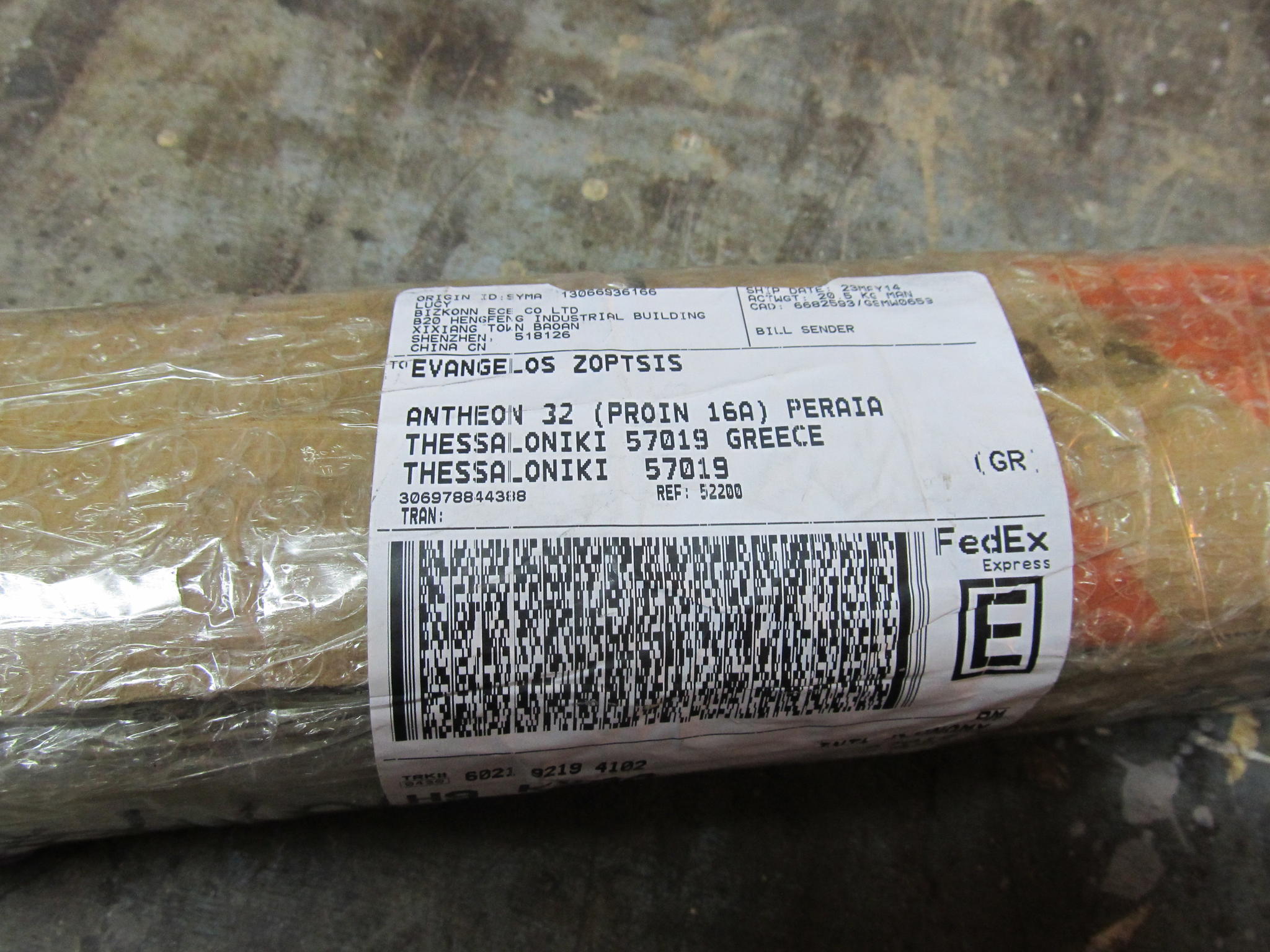

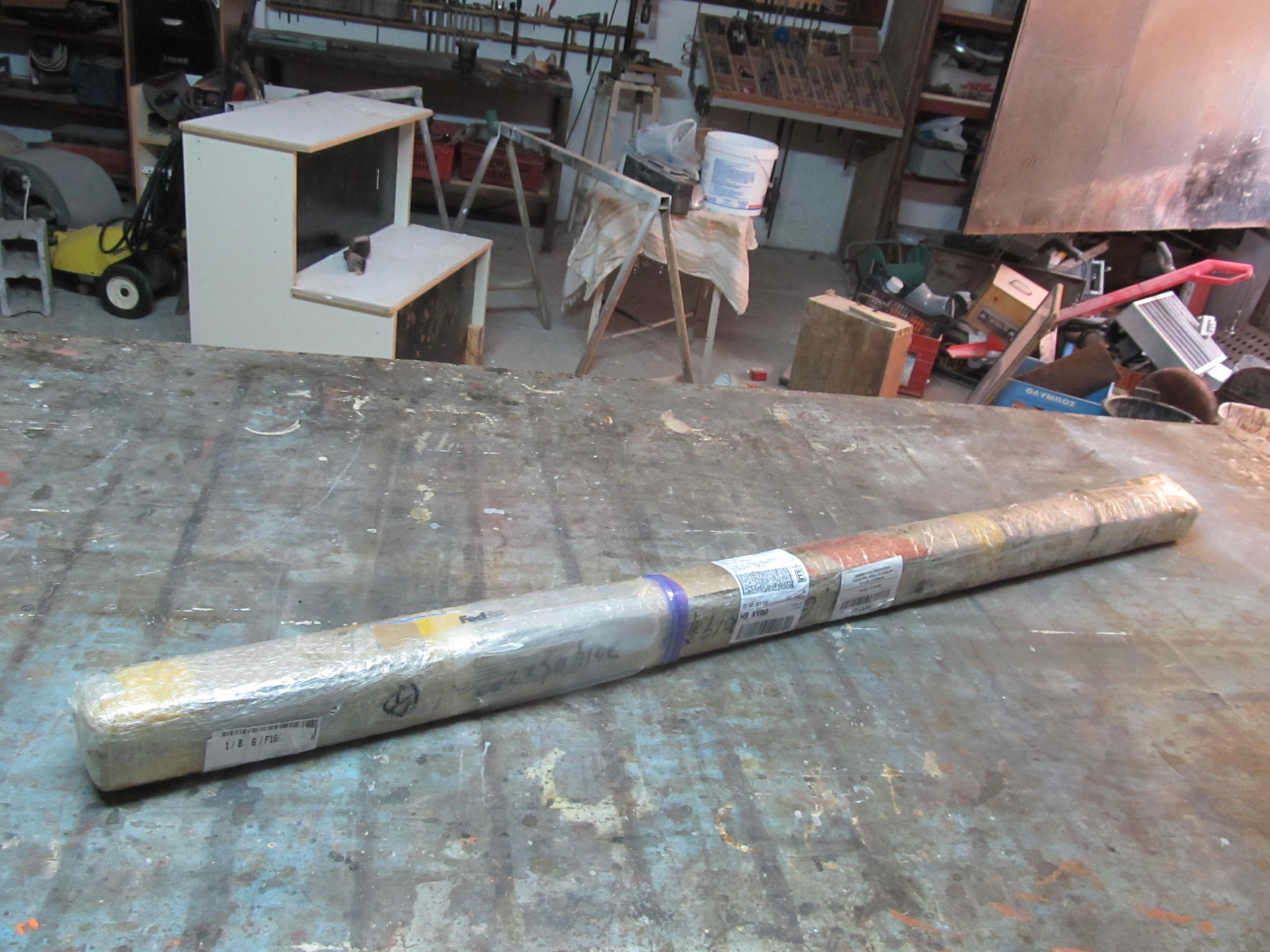

Yesterday i receive from Chai the above things
-------------------------------------------------------------------------------------------------------------------------------------2X anti backlash ballscrews RM 2010 C7 end machined -1603mm Overall length
2 ballnuts for 2010 ballscrews1X anti backlash ballscrews RM 2010 C7 end machined -1153mm Overall length
1X anti backlash ballscrews RM1605 C7 end machined -501mm Overall length
1 ballnut for 1605 ballscrew3 Set of BK/BF15 1 Set of BK/BF12 1x Ball Nut Mount/Bracket Flange For 1605 3XBall Nut Mount/Bracket Flange For 2010

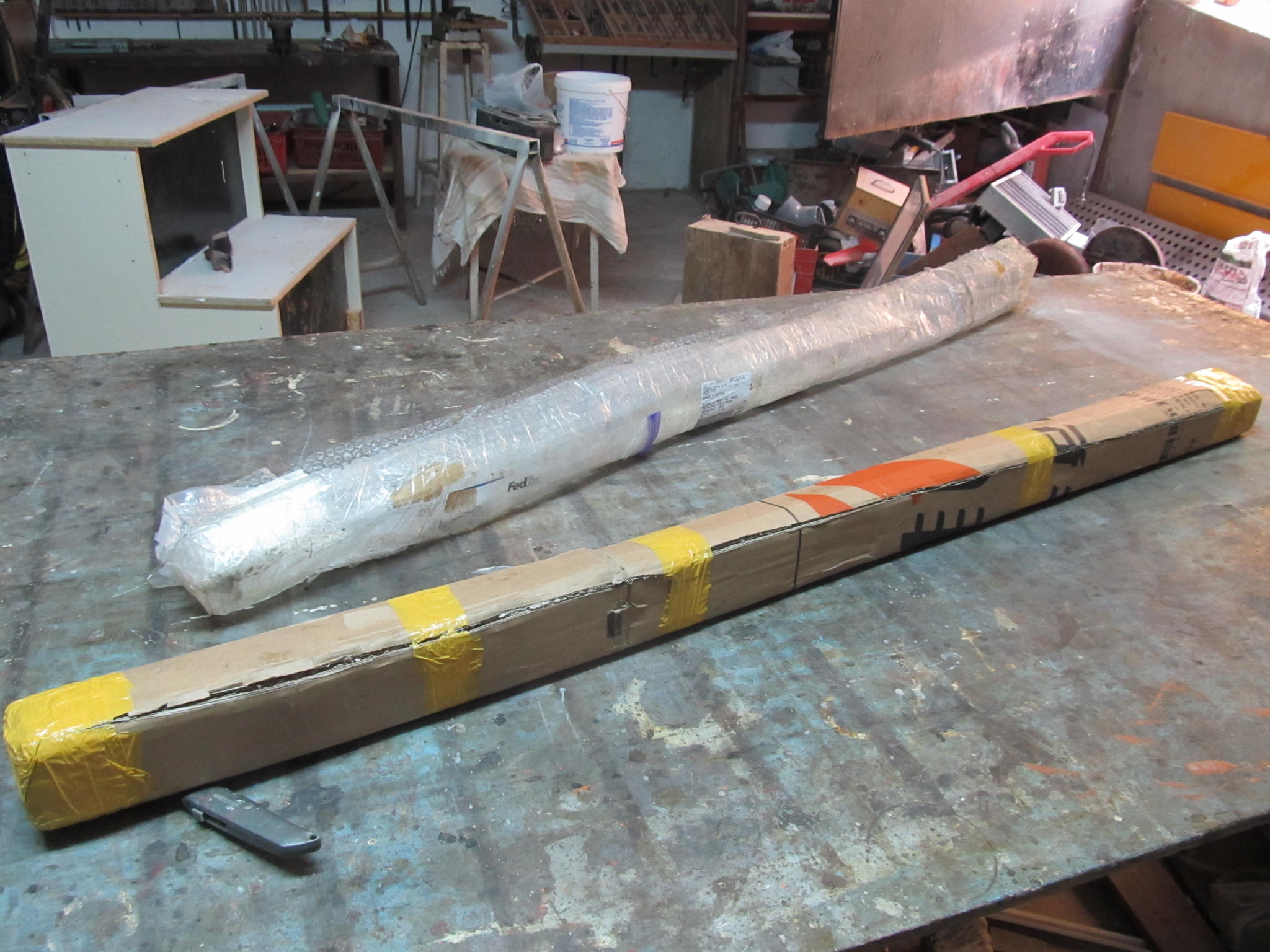

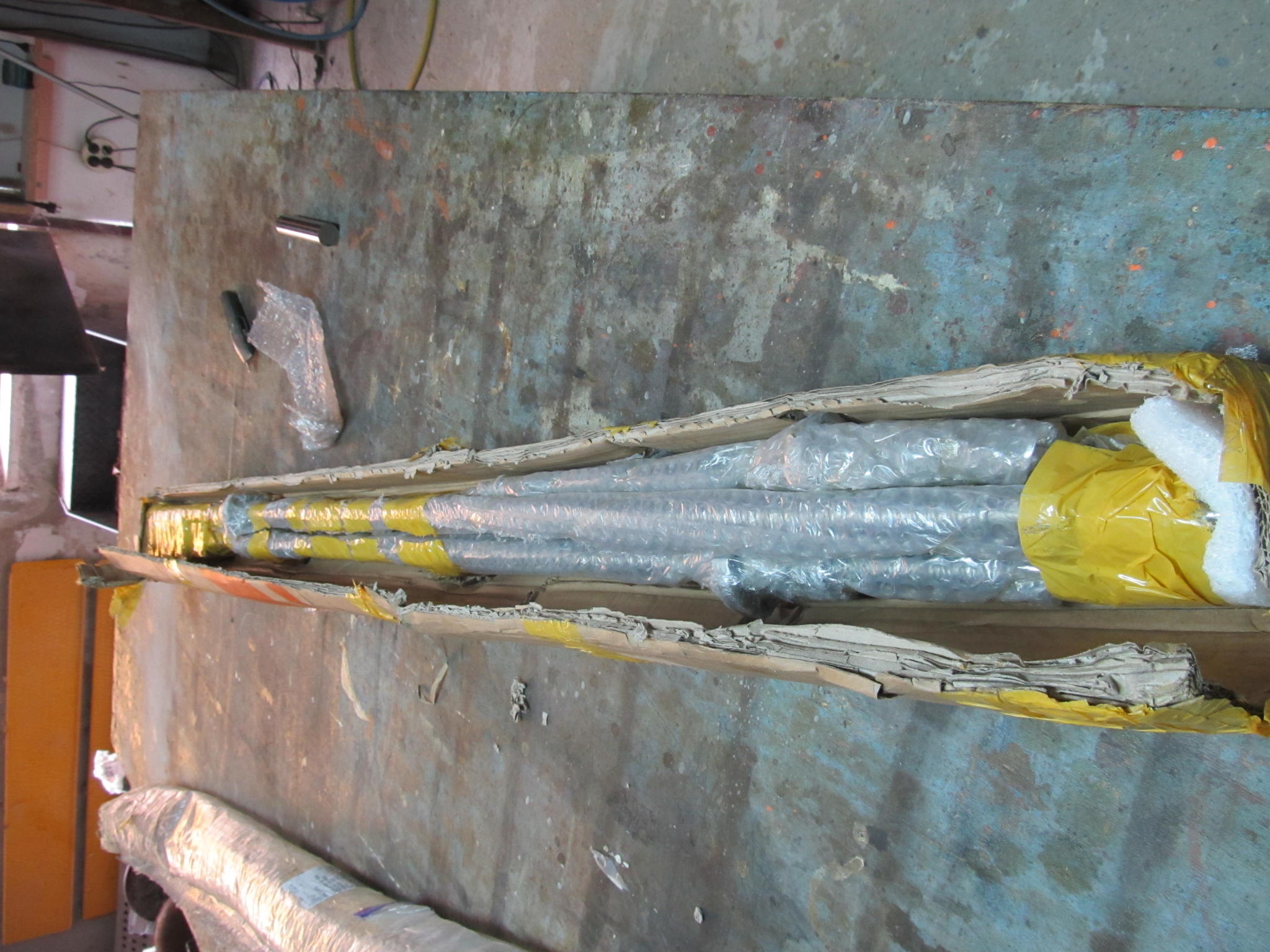

I open the box to see if everything is ok
I attach the bf/bk at the ballscrews, and i realize that the screws seems to be bended
I give them motion with a wireless drill and they are "dancing" like crazy especially one of the 2010 1603mm long ballscrew. It seems to move 4-5mm out of the center axis. Also the other three are whipping(1-2mm).
