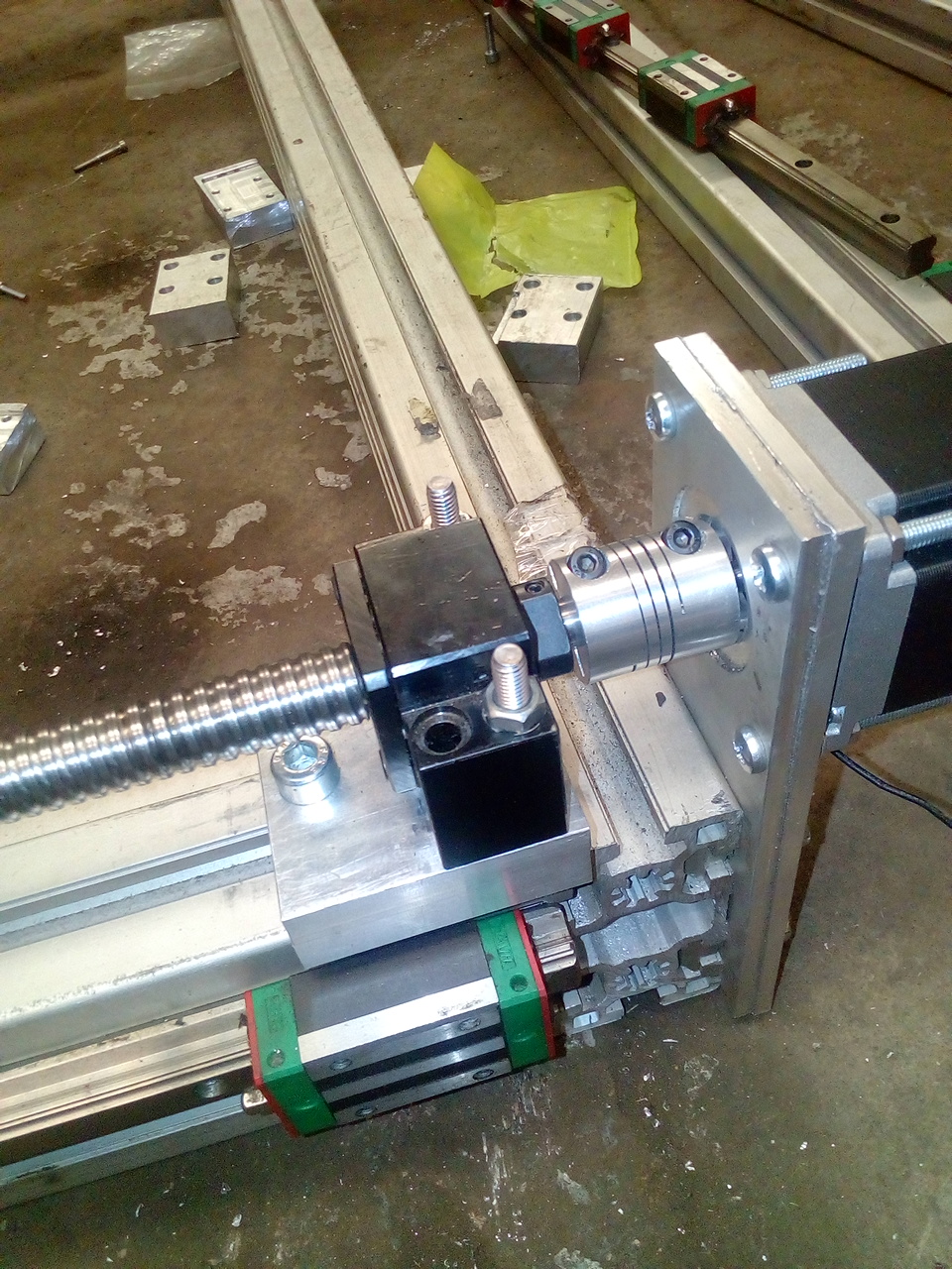

    Stupid question probably but where do I use the circlip that came with the BK12/BF12 fittings? Not seen any decent vids on how to actually assemble the ballscrew & fittings seems easy enough but the circlip is confusing me lol.
    I'm guessing the circlip goes the floating end? But could have done with some instructions lol.

    On the floating end of the screw BF end there is a groove for the circlip that goes on after the bearing. The the BF block will slide on the bearing and should sit about half way in. The reason is so that if the screw expands it can do so at the BF end as the bearing will slide in the block.

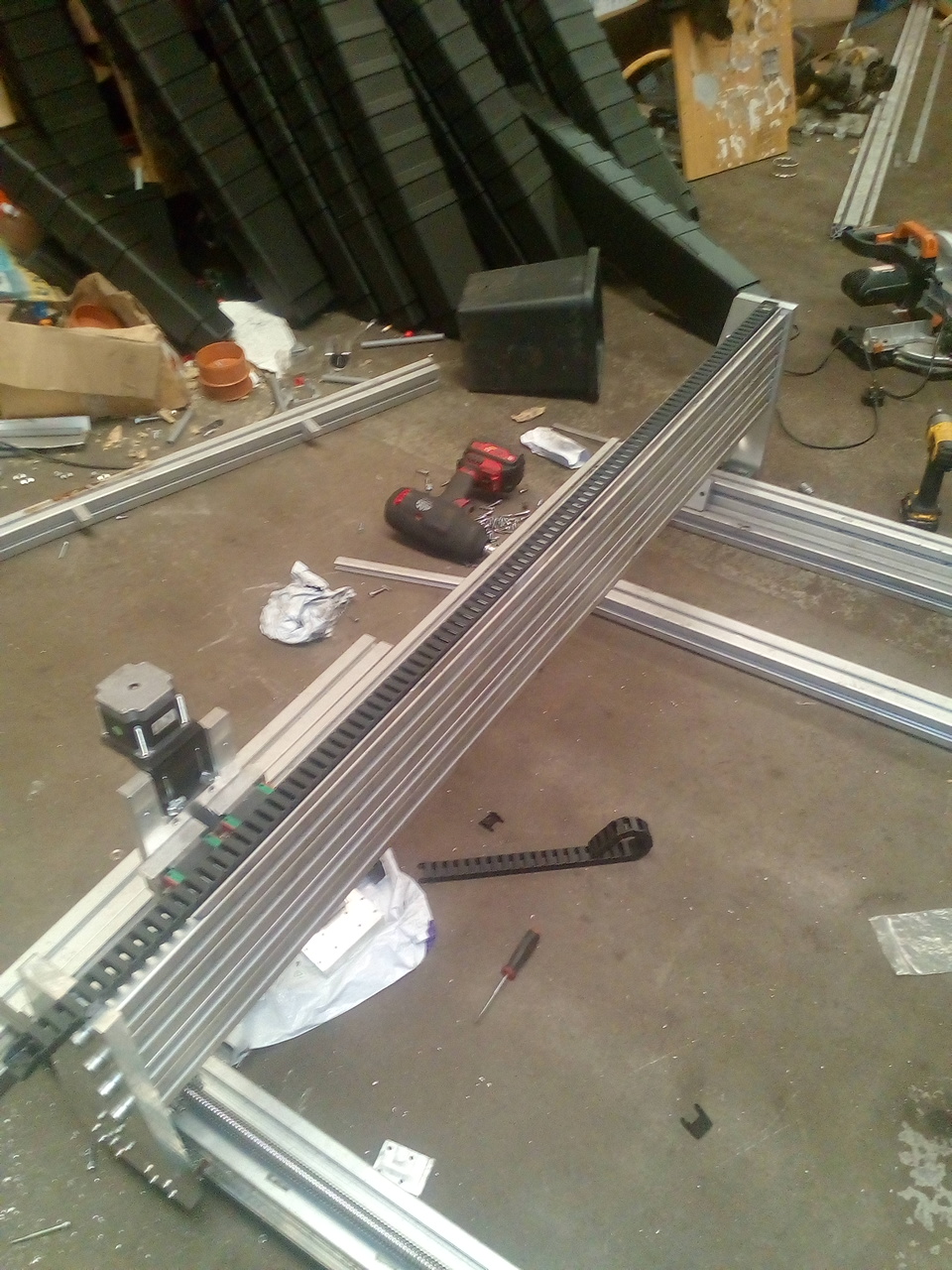

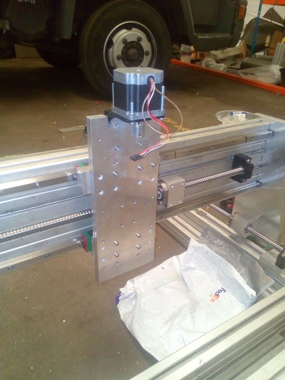

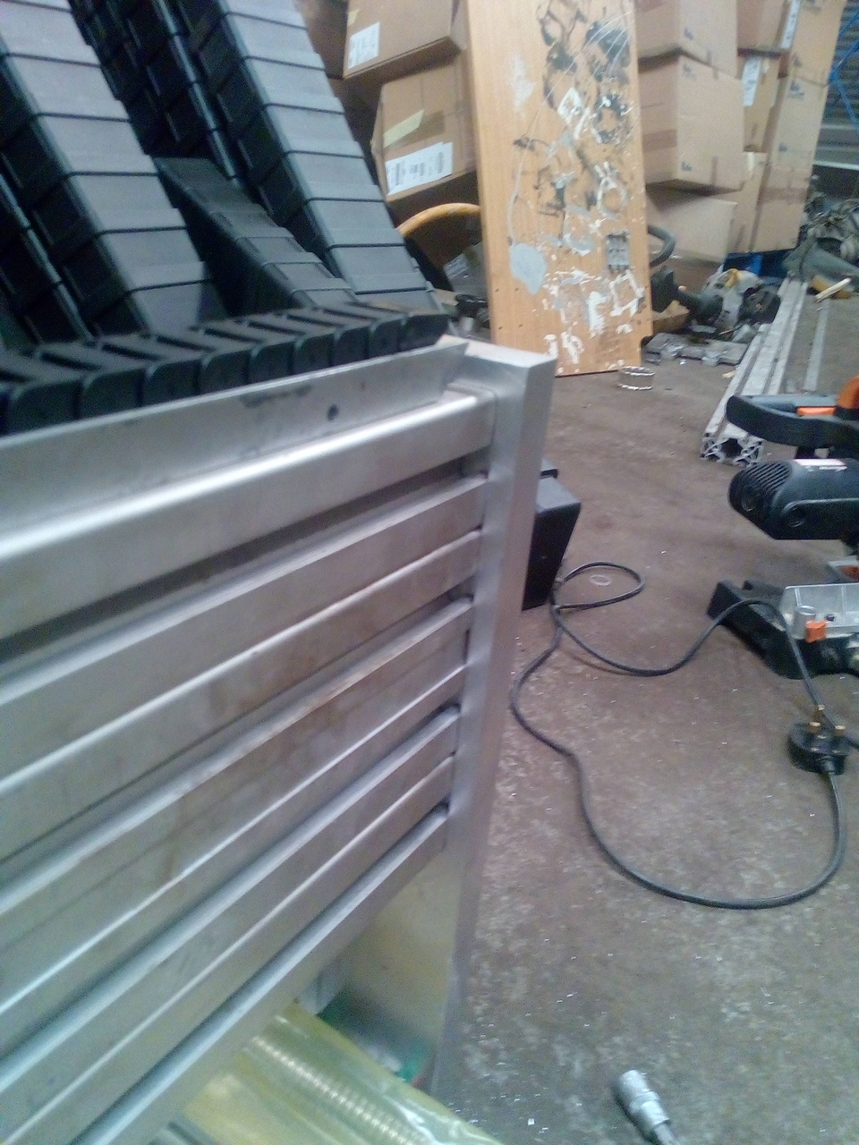

    Assembled a bit more started to think about energy chain placement.
Name:	energy chain.jpg
    there's 2 bolts in the BK12 mounts that bolt into T nuts but 1 of them is counterbored and under the BK12, The A2's are then upside down and bolted from above was difficult to do forgot I meant to change the A2 bore to a captive nut but worked out ok in the end. Every bolt has a non slip washer under it.
