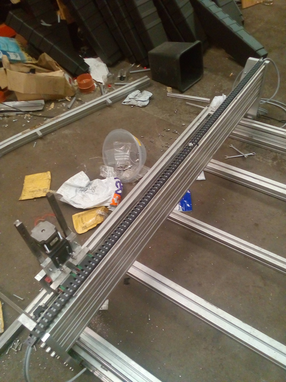

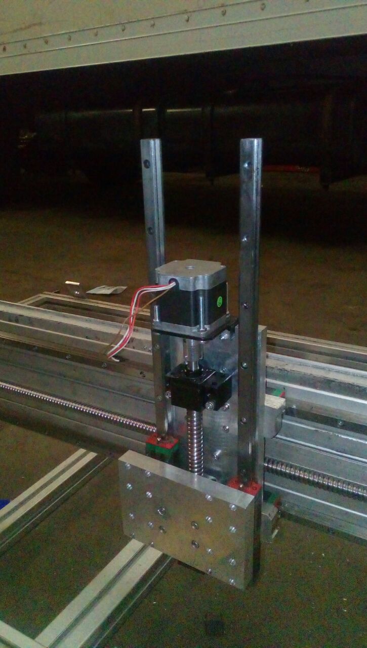

Name:	energy chain.jpg
    I bought 4 because I wanted a spare so I'll go with 3 ;)
    the company I bought 4 AM882's from contacted me today they only have 2 so told them to ship them and refund the difference and bought 2 from HK angry though as I was expecting them to arrive next week now going to be at least 2 :(
    When I finish the router and it moves properly I'm going to buy 1 3nm nema straight away to swap onto the X so I can swap the 2nm to the Z axis as I have a gap is bigger than I thought between the ballscrew and nema and the longer shaft of the 2nm motors are a perfect fit.

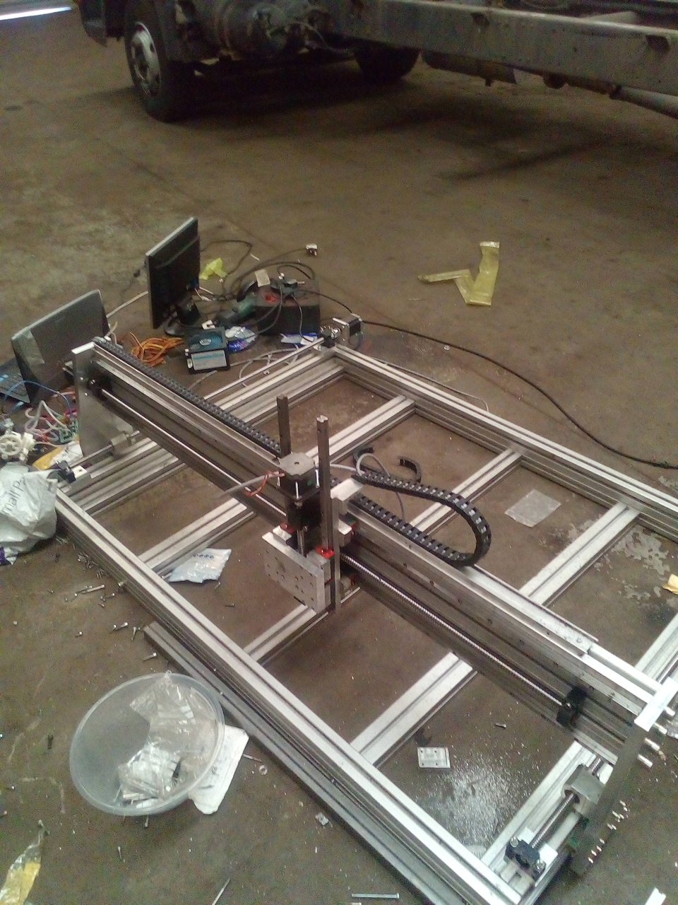

Name:	energy chain 1.jpg

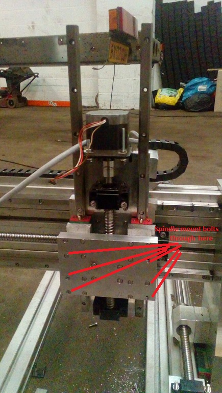

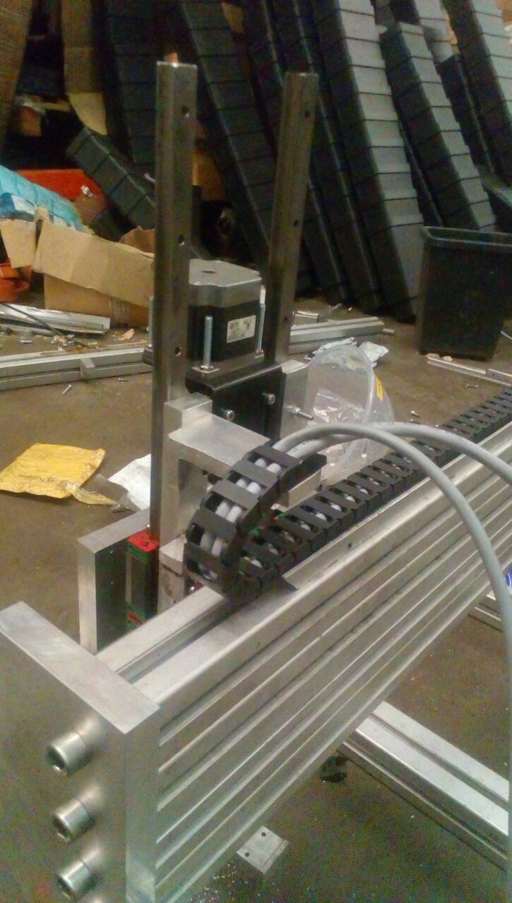

    Still got to drill the spindle mount out, bolts are going through the spindle mount them through the top Z axis plate, through aluminium spacers and into the Hiwin carriages directly.

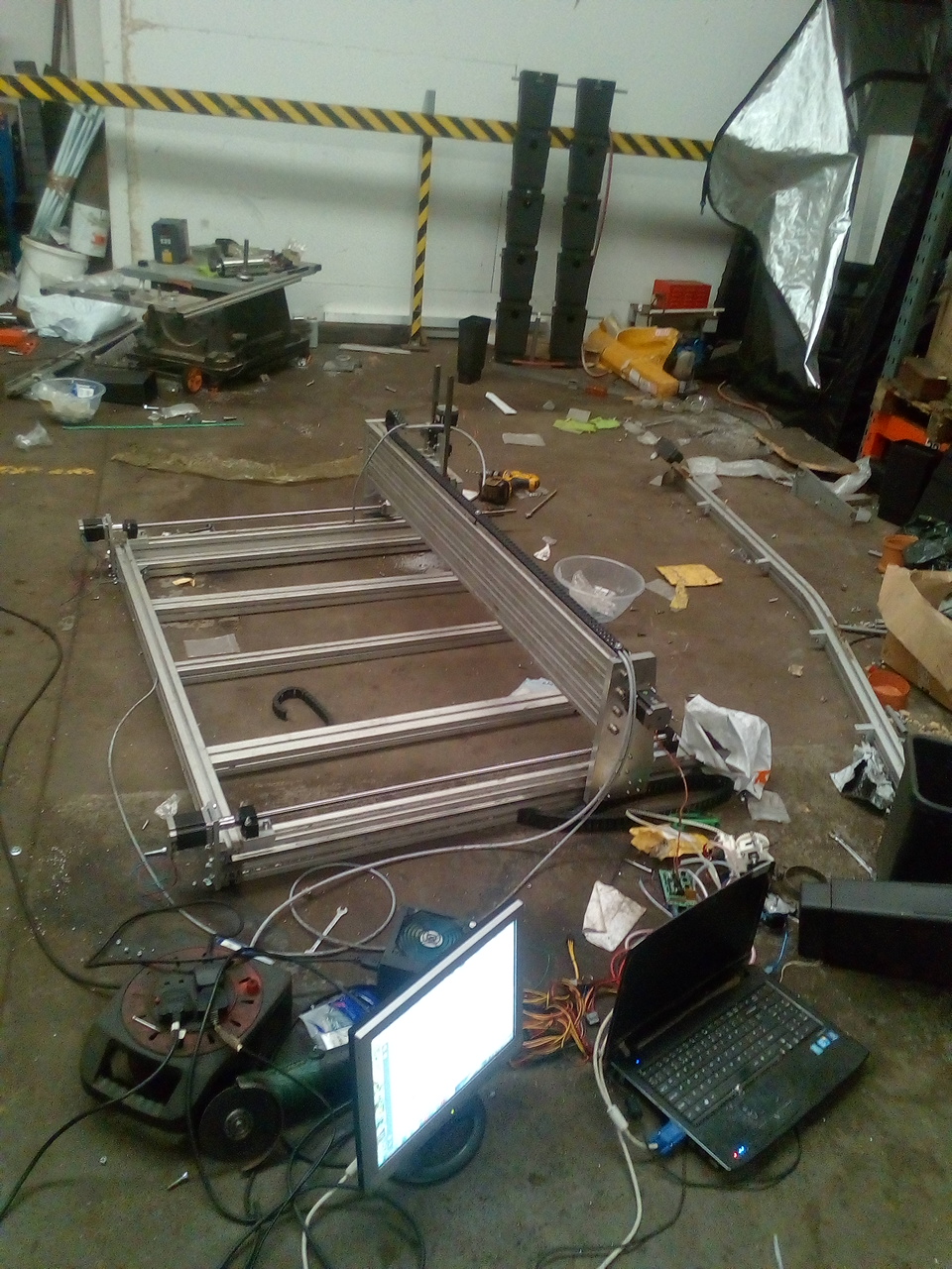

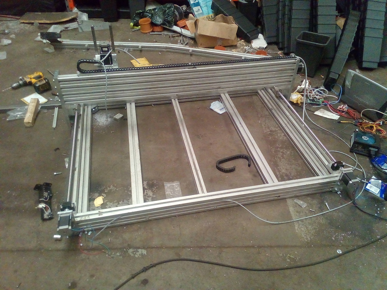

Name:	dual ballscrew.jpg

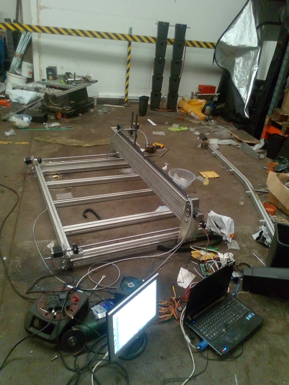

    She moves! At least the gantry and Z axis not tried Y axis because of the dual ballscrew, will wait for the AM882's.

    Thanks been a long slog but so glad I didn't buy an Xcarve and built my own ;) For a long time I was toying with buying an Xcarve (Or Shapeoko)but I had the extrusion and I found this site and the next thing you know I have Hiwin's and ballscrews instead of a belt and some skateboard bearings lol.
