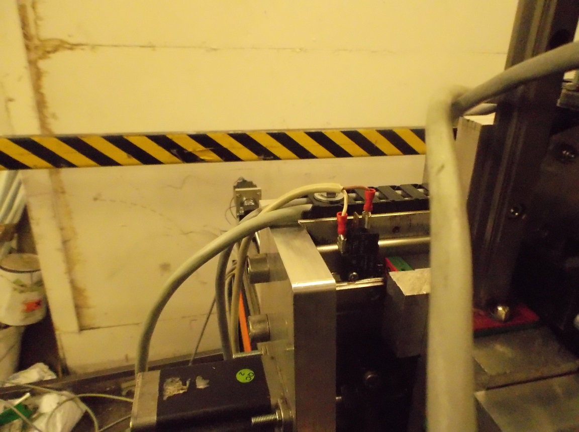

    I would keep the Y switches on the there own inputs . Can you sketch a circuit of what you intend to do?
    I've run the X axis (Gantry) to the X input and the 2 Y Axis limits to Y & Z, when I add a Z I'll add it to the the same input as the Y but will get better electronics than this BOB soon but have other things I'd rather do first.

    I thought you was connecting up the home switches before. The limits can all be connected in series together.

    How are you planning to use the dual home switches (Y axis in your case?). Generally you do this for gantry squaring, but only if your motion controller supports this (and not all do!). I don't think that Mach3 can do this either. I have the same problem on my own machine, by the way, and not trying to pick holes in your design. It's just one of those things that isn't obvious until you come to try to do it...
    Personally, I home my dual-axis using just one home switch and manually tweak the other side for squaring purposes as my motion controller is no help at all in this area.

    Neale I think Mach3 can do dual homing. UNCHECK "Home Slave with Master" in General Config. You may also need to modify your Ref All script to use RefCombination() to get the two sides to move together.

    I'm going to try linuxcnc which does support gantry squaring (Whether it works with my BOB we'll see) at least in 2.8, a quick google and it appears mach 3 does as well.
    I'll try mach 3 as well, I planned a 2 pc setup for the cnc machine just in case with windows 7 & Fusion on one and the other with linuxcnc that way I can try both easily and have convenience of cam next to the machine.

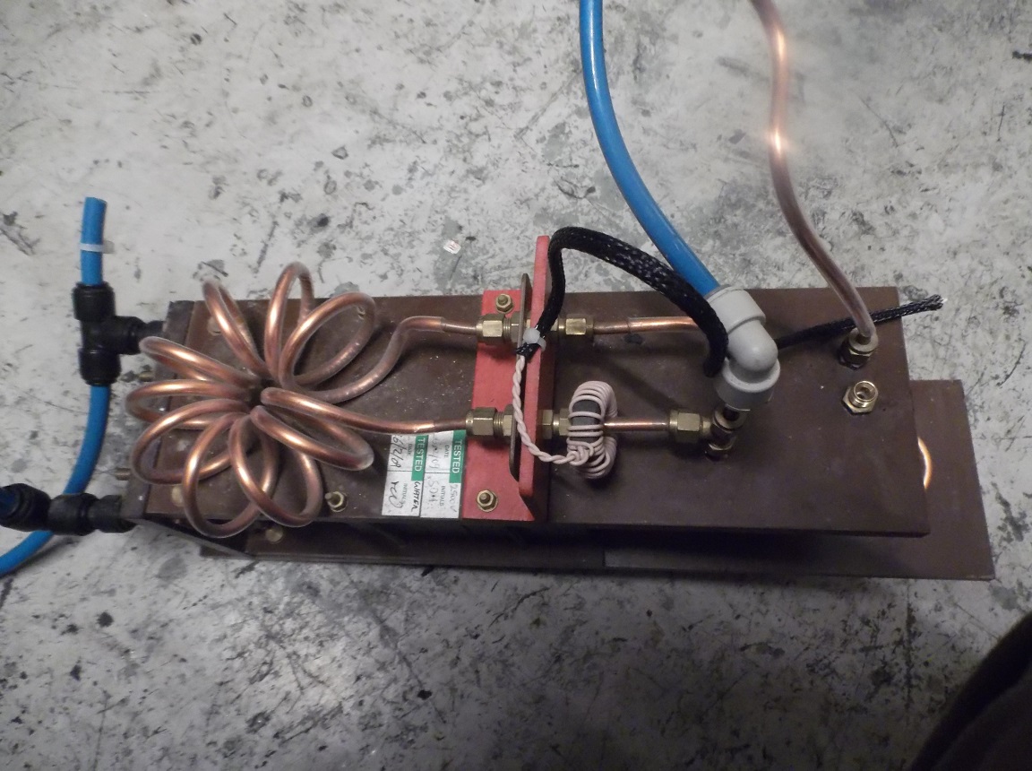

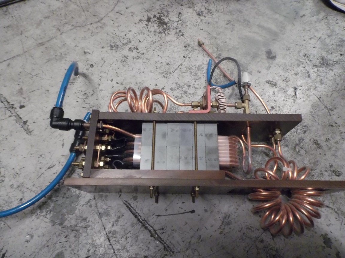

    What are they? I first thought they were radiators I have 2 of them, when I stripped them off they were full of water. Came from a large controller box for automated machinery, also recovered a 75amp 3phase RF filter box.

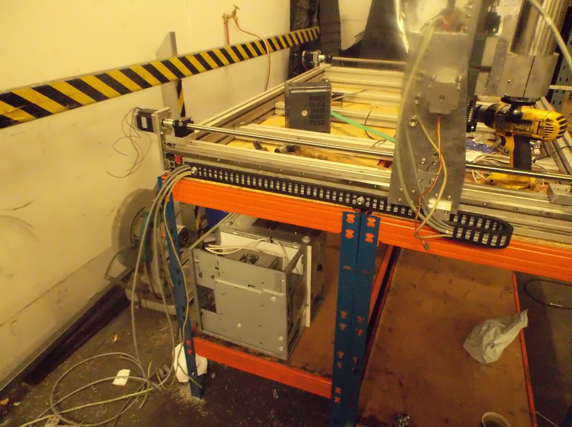

    Got more done, finally ready to solder the cy cable to the steppers.

    Just tought of something..
    I'd you have the limitswitch like that and get some overshoot you will crush the switch ;)
    I.e if the machine is on a rampage and go full speed into the side.. If you have the switch in a way so the machine will only touch the trigger but pass the housing of the switch it should stop in a few mm :D
    Make any sense?
