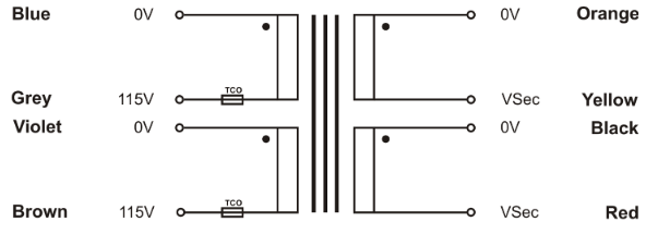

    I got it wrong before there's no continuity between blue and grey OR violet and brown but there is continuity between grey and violet I guess this means both thermal fuses are blown.
    One question about the new transformer I know I wire on the input side the brown and blue to the mains, the grey and violet together as before. On the output I wire the orange to the black and the yellow to the red then wire them to the the rectifier is that correct?

    Just an observation - are you running the primaries in series (240v) or parallel (115v) ??
    If series the you need to connect supply to blue and brown with grey/violet joined.
    If parallel then connect blue/violet and grey/brown then connect supply to to those pairs.
    Just an observation as said but easy to ignore those little dots on the transformer winding pictures ;)

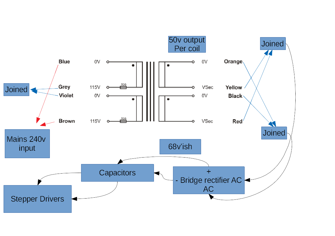

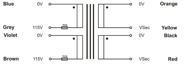

    I had it wired blue and brown to mains 240v, grey and violet joined on the input side. On the output side orange and red to the rectifier, yellow and black joined. This was a dual 25v output core.
    This time with the 1kva transformer I'm going to wire the input the same (it's a dual core 115v input). The output I will join the orange and black and then wire to rectifier, join the yellow and red and to rectifier. (Dual core 50v output, I want 50v out to feed into the rectifier so I get my 68-70v out for my drivers.)
