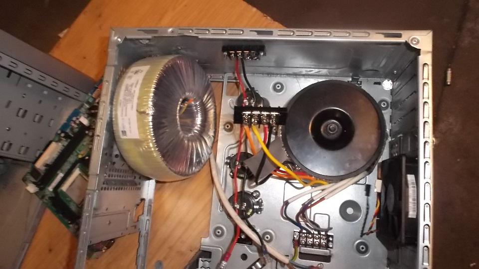

    Came today but missing the top metal plate! I think the one on my old transformer will work fine but still poor maplins I do have both rubber protectors.
    I was hoping it would straight swap but not so sure it will I might just get away with it and a hammer ;)

    Not going to wire it up until I have an MCB, replacing the rectifier as well, going to leave the caps in place.
    Think I traced the problem to a poor crimp causing the initial problems and we think my friend reconnected the bridge rectifier backwards on the output but no one can be sure.

    There's a reason transformer manufacturer's usually recommend slow blow/time delay fuses, and this thread has just proven why.
    Fit a 10A MCB to a 1KVA transformer, and there is a high probability the transformer winding will fail before the MCB trips.
    1KVA roughly equals 4 amps, so taking a type B MCB, it takes a minimum of 6 seconds at double the rated current for it to trip. So taking that 10A MCB, that's 20A, 5 times the transformer rated current, or over 4KW flowing for 6 seconds. Do you still think that MCB will do much good?
    I personally just use a time delay fuse rated around 120% of the transformer rating. If you blow it, you're doing something majorly wrong, and it's far cheaper than a MCB.
    As for cheap multimeters, they rarely have a fuse for the amp setting, which is likely what will of caused the problems. A sudden short on the power supply, as well as causing the transformer to fail, will of likely burnt something out in the power side of the AM882. If you were to strip it down, you could at least check the main power supplies are still functioning.
    Also, if you strip the outer covering of the transformer, you might find the fuses near the outside of the windings, so it could potentially be a relatively easy repair.

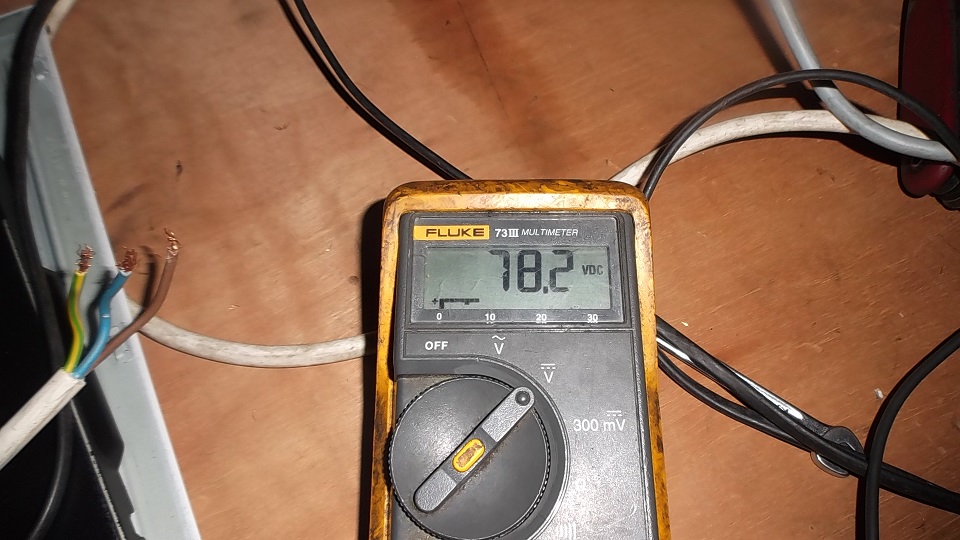

    Right wired up properly and tested 78.2v out so a little high what's the best way to reduce this voltage my AM882's 80v is max input.

    I daren't plug it in to the AM882's.

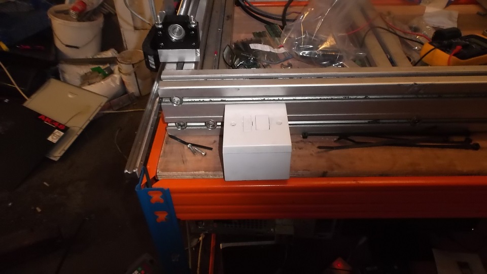

    Got it wired to a 13 amp switch finally so I can turn it on/off without killing power to pc.

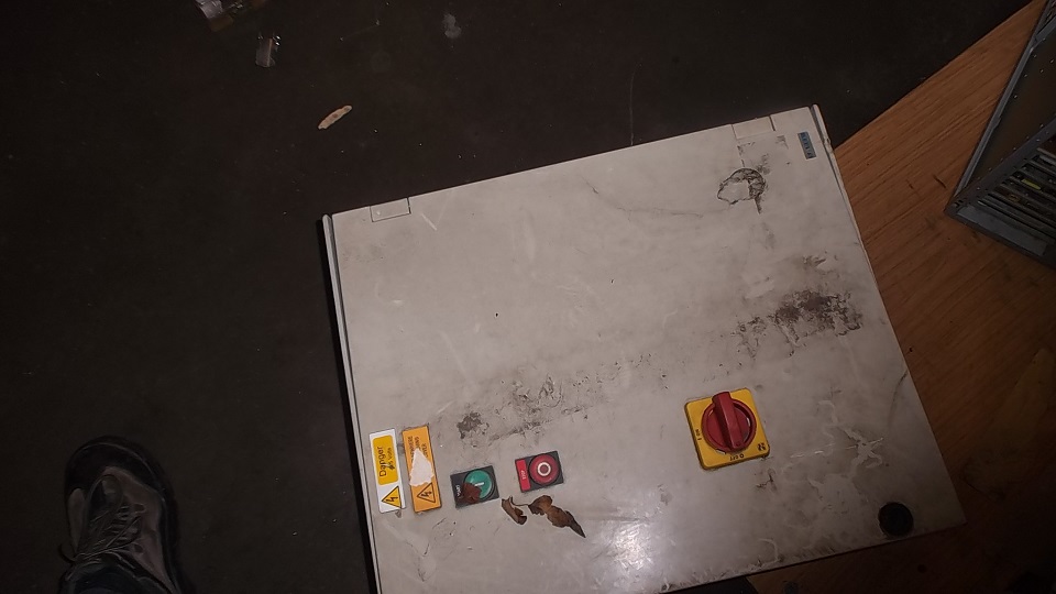

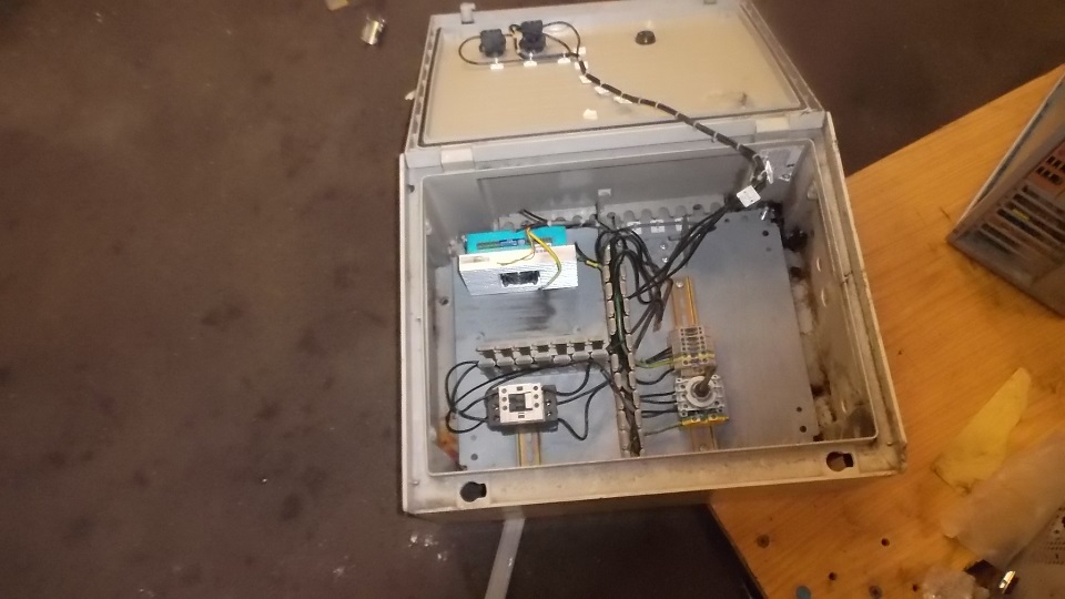

    Got a free enclosure some damage to the front but better than what I have, will transfer the AM88's and BOB's across PSU will stay in PC case.

    If it were my supply i might unwind a couple of turns off the transformer secondary, but thats just me ;)
    Not too many ways to fine tune the voltage really.
    Maybe also look at an autotransformer in the primary circuit - a multi-tapped primary only transformer with the input going to the normal 240v tap and then take an output from the neutral and a tapping a little lower like 220v.

    Or just run it at 78v's and hope ;) I turned it on off a few times and tested the voltage each time, and I noticed my input was 250v at the time it seems to vary at work from 238 to 250v this is the highest reading I've had so far and I think the max allowable is like 252v.
    I need to check what the ac voltage going into the rectifier is didn't think that but was gutted as I was expecting to get something like Joe Harris 68v giving he has 25v output coils in series and I have 50v in parallel.
    I wonder why I'm getting such a high reading is it because I have a high input voltage? This is mains fed, to an industrial unit, is it possible other things could affect voltage on the line? I'm going to have a dedicated line put in for the machine I seem to remember getting 240v when I was working on the 3 phase sockets (I tapped 1 phase for my plasma cutter)
    Yes, output is directly related to input, that is a very high input.
