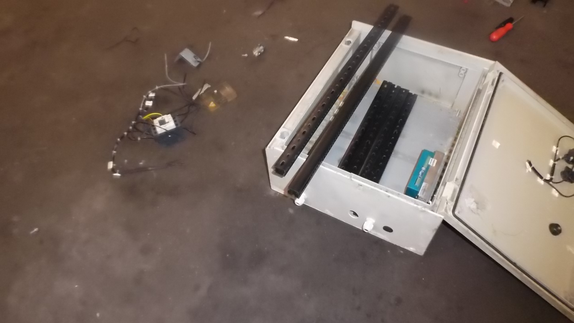

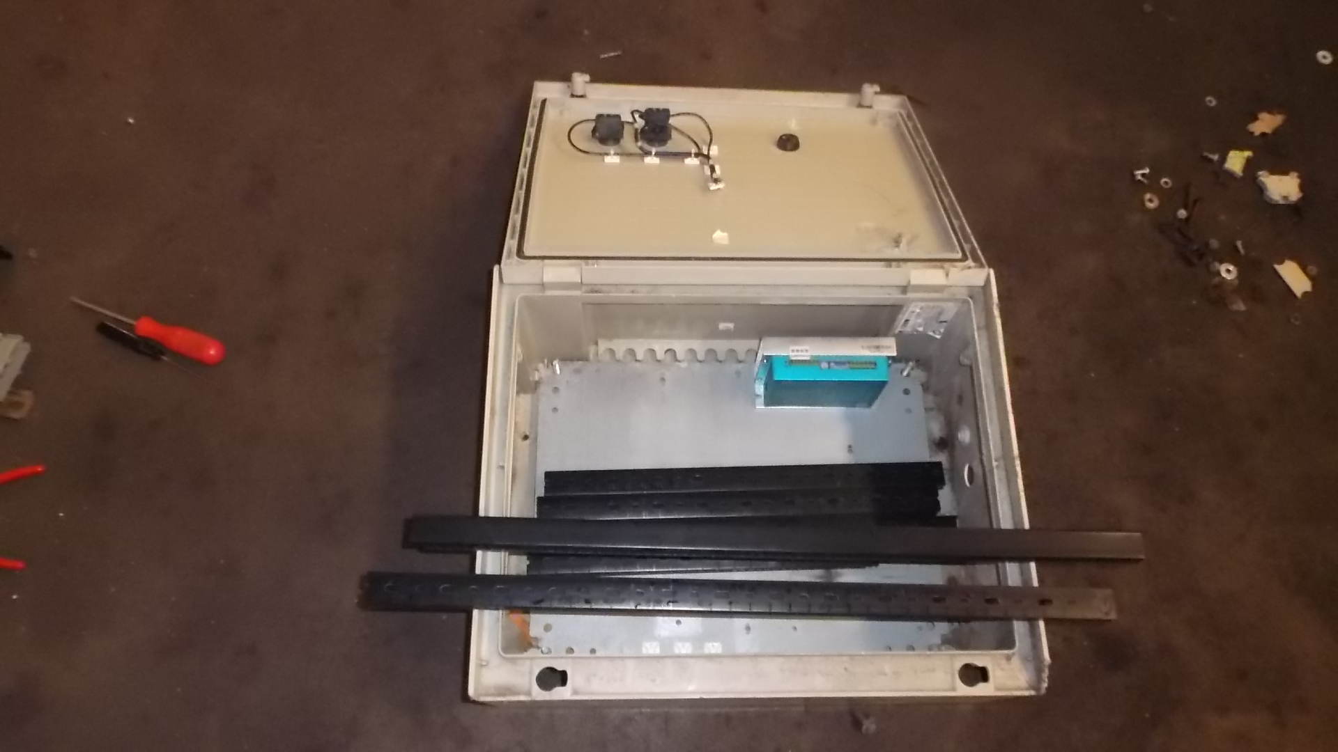

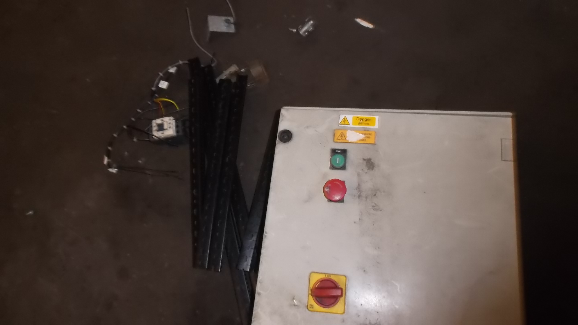

    Have ordered a 45v 1kva which will solve the problem whilst I'm waiting I took the time to start stripping out the box and recovered some nicer wiring conduits. Also fitted a proper stop switch to it.
    Friend is going to fibreglass repair the damage for me I might even paint it ;)

    There's loads of space in here should I put the transformer in here as well and fit a 4 120mm pc fans two blowing in across the am882's and two sucking out the side of the transformer and leave a nice gap so the air can flow, I want to make sure the caps get good air flow over them.
    It would be good to fit the transformer at the top of the box but it weighs 8kg making the box top heavy so it'll go at the bottom if i do fit I think the key will be good air flow and lots of it. I have a better on/off switch which is rated to 2hp (I think might be 3) ac3 so I think should be ok for the PSU.

    If you can cancel the order and reorder a 625Va as it should suite you better 45V is a good choice
