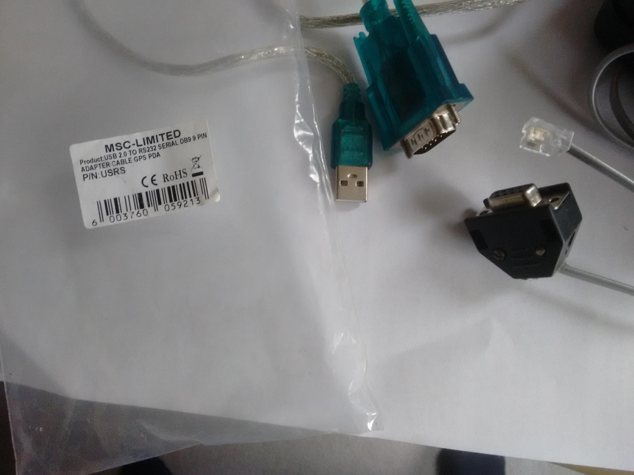

    For the avoidance of doubt I use AM882's on the router, they are programmable with the RJ11 socket on the end.
    You can make a lead up from an old phone then chop the end off and fit a D9 plug on using just 3 wires. Then use a USB to D9 adaptor to connect the RJ11 lead to the PC.Click image for larger version.

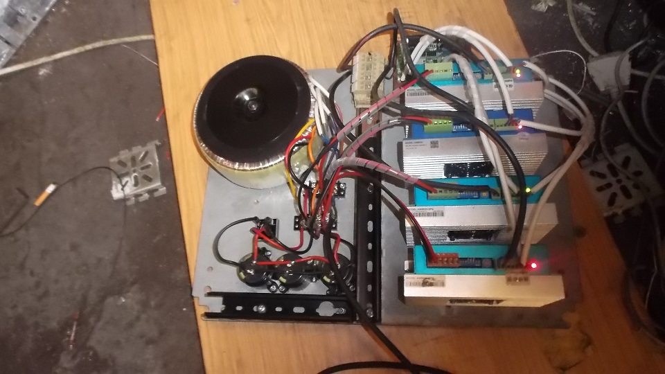

    Sorry to jump in on this thread Neale would the wires from the EM806's go to the E stop on the BOB?
  4. #373
    Quote Originally Posted by phill05 View Post
    That's how I have it setup the black cables are the stall protection
    Powered on today ;) can't test it because I took the Z axis plate off and it's still with engineering firm although ready to collect Monday.
    May sound daft but actually, I don't know! I use a CSMIO-IP/M, partly because it includes BOB-style functionality (i.e. it provides plenty of input and output connections, and doesn't need a separate BOB). One of these inputs can be defined as something like "servo fault", and the hardware is set up to stop all motion immediately if this signal occurs. That means that Mach3 doesn't get involved directly, so I haven't had to define an input in Mach3 for it. I'm sure that someone out there knows the answer as this is a very common setup, it's just not the particular one I use. This is also why it was very easy for me to use the factory-default "NO" rather than "NC" on the drivers.
    If you reconfigure the 882/806 using the software configuration tool so that the fault outputs are now "NC", then you should be able to wire them in series with the e-stop switches and take them to the e-stop input on your BOB. However, I haven't tried this myself, although it's what I would investigate doing if I were in your position.
  10. #377
    Lives in East Lothian, United Kingdom. Last Activity: 11 Hours Ago Forum Superstar, has done so much to help others, they deserve a medal. Has a total post count of 2,994. Received thanks 376 times, giving thanks to others 9 times.
    It depends on your controller.
    If you configure them NC, and your e-stop kills power to the drives, then you need someway to override the fault outputs in order to activate the e-stop relay, so the drives can power up, and activate the fault outputs to complete the e-stop loop, at which point the override can be disabled. If you run them NO, then to have them as part of the e-stop loop, you'd need to use the outputs to control a NC relay, so when the output activates, it powers the relay and breaks the E-stop circuit.
    I'm aware the CS units have some kind of fault input, which although not part of the e-stop circuit, will disable things in the event of a fault being triggered, and is capable of ignoring the fault signal during reset, so things can be reset/powered up without having to override the fault signal.
    Me personally, as I'm using a KFlop, I just have the fault outputs going to standard inputs. I've programmed the KFlop to continually monitor those inputs, and in the event of a fault, the KFlop disables everything, halts the software, and displays a message to tell me why everything has just ground to a halt.
    I know some people just rely on Mach to handle faults, however I personally would never rely on Mach to handle critical faults.

    I was going to to wire the stall protection to the estop on the BOB. Then I'll wire the physical estops to a contactor and the PSU and spindle to the contactor.
    Originally was going to use a latched relay but I think a contactor will do as all my estops will be the twist to release type.
    Not got my Stop's yet they're still on a conveyor belt but after xmas it's being scrapped and I'm having all 4 stops off the machine ;)
    They have NO and NC contacts on all of them.
