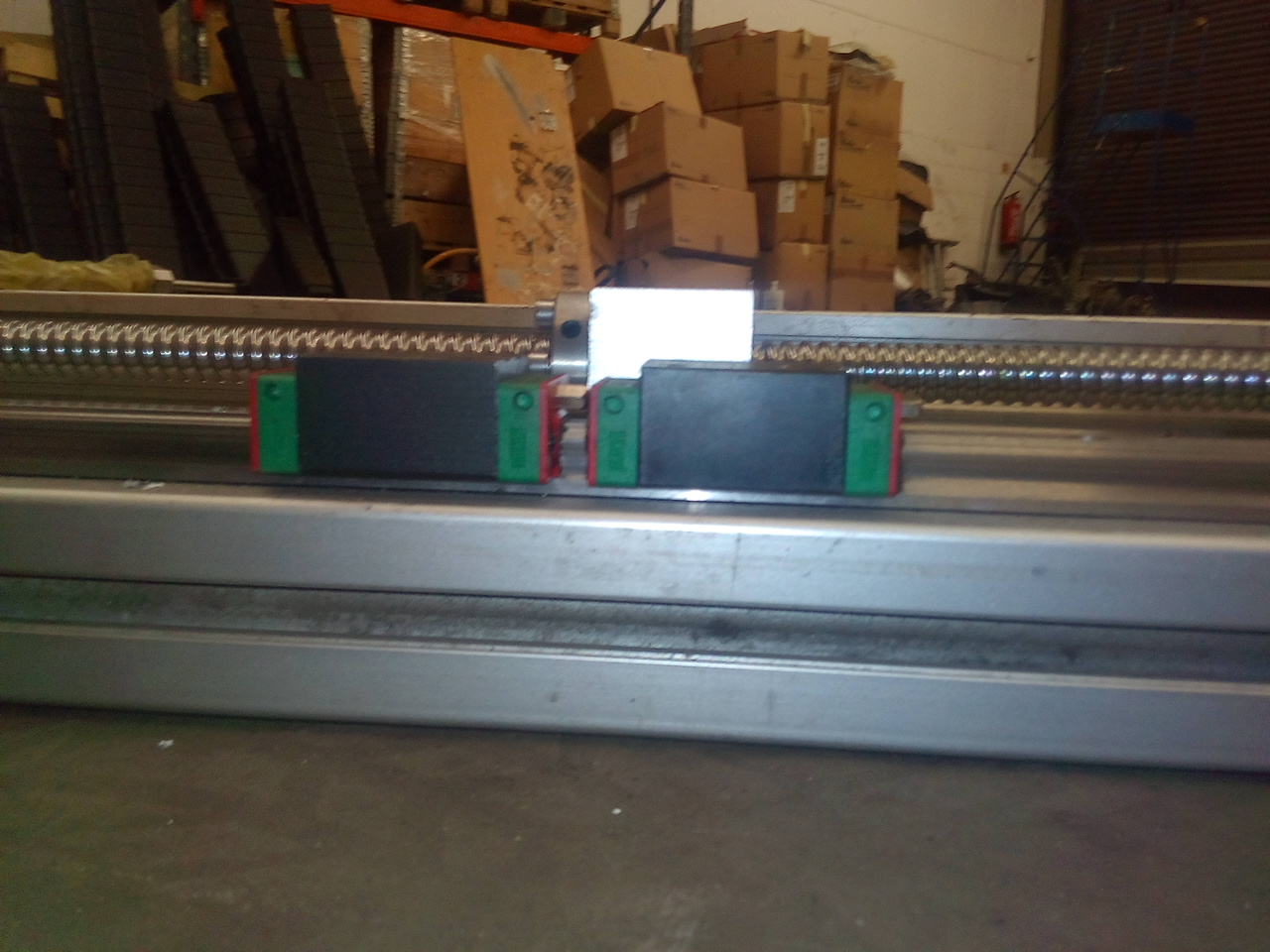

ID:	22608 The ballscrew will have a mount either end to bolt into just laid it roughly where it's going to go, Hiwin's bolted on finally need to cut them down.

    3 individual pieces 2 * 4545 and 1*9045 will drill 5 holes through the 4545 and bolt using T nuts to the 9045 to reduce flex.
    The Hiwin problem anyone who's used 15mm Hiwin's and a 1605 ballscrew knows this problem lol, it doesn't affect my Y axis because the ballscrews are at right angles to the Hiwin's but the gantry and Z axis both had this problem which I solved with a combination of spacers and recesses.

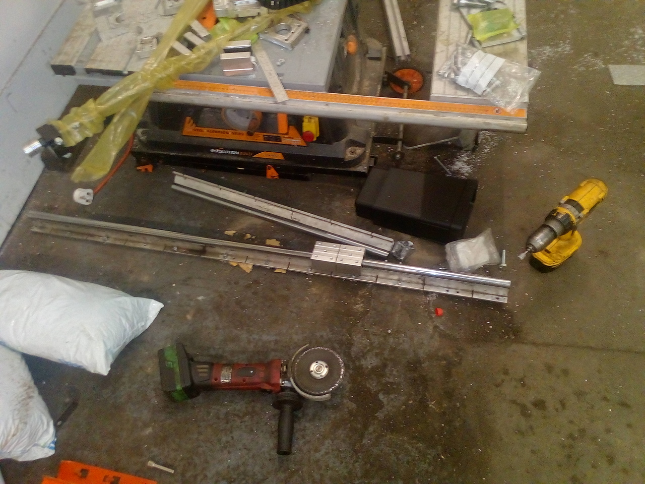

    I can say from personal experience DO NOT BUY EVOLUTION TABLE SAW it's total shit!
    That's a shame, I have the big Evolution cutoff saw and I use it for all sorts of things, it did sterling service cutting a load of old thick wall galvanised imperial scaffold poles into manageable lengths, you need a squirt of WD for ally cutting to avoid clogging up the blade and you must clear the blade if you do clog it.
    Just don't try cutting Titanuim, it will eat the blade, don't ask how I know! ;-)
    - Nick
