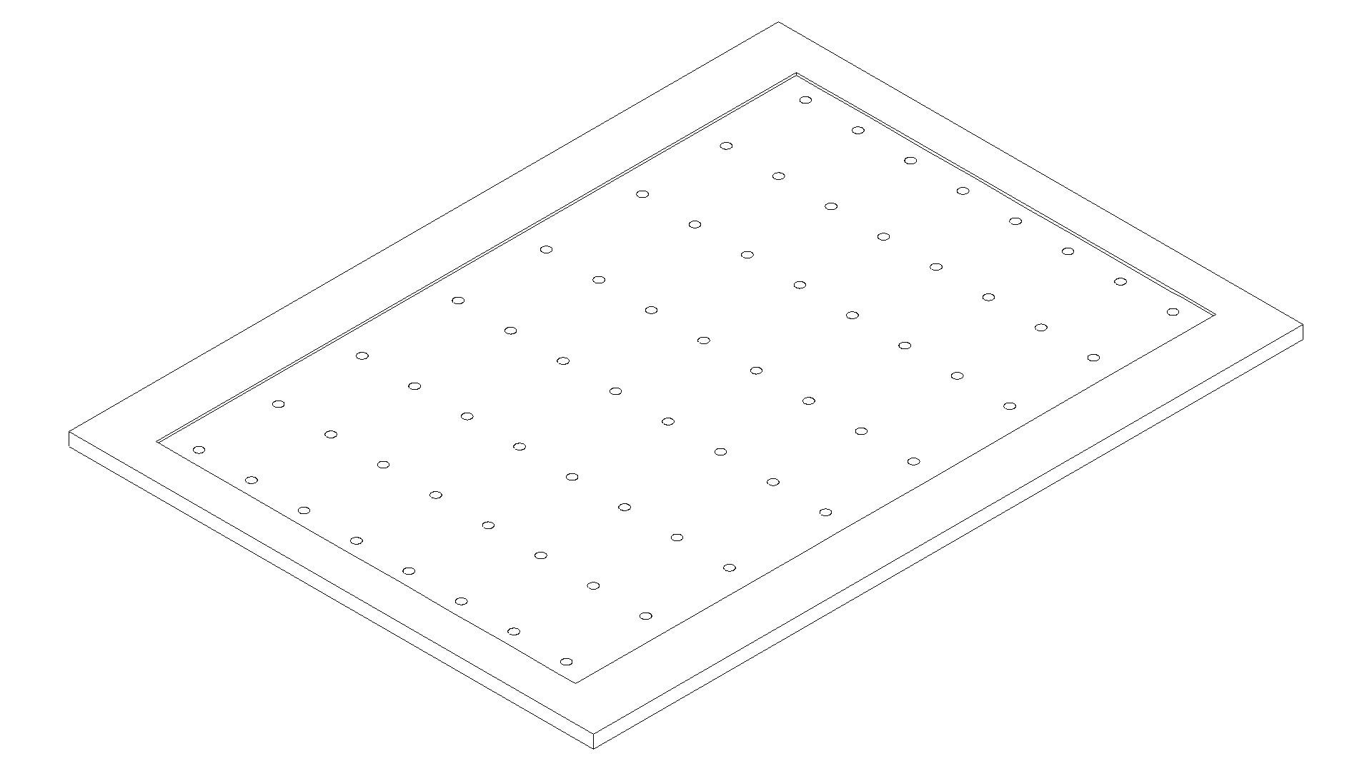

    MDF bed ;)
    With 16mm holes in it, I have 16mm plastic plugs, 1000's of them so I can block off the holes as needed. Then going to use a vacuum cleaner for now but will upgrade to a vac pump and use a couple of air tanks for extra capacity. Clamping would do my head in, although I may still need to clamp lol.
    Then have a play with some scrap wood before I start cutting expensive stuff lol, also want to check out how much flex I have in the middle so will try cutting hard woods in the centre
