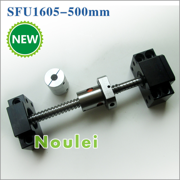

    I forgot to mention I fitted the BK12 fitting the wrong way round on the X axis and it was squeaking when I tried to move it, lubricated the hiwin's and ballbscrews a couple of times before I realised lol.
    Swapped the BK12 fitting opposite way round and all good ;)
    Damnit! Is there a wrong way :D I have one squeaking ! Have to check orientation.. good find hehe

Name:	Rolled-Ball-Screw-1605-500mm-rm1605-lead-5mm-with-SFU1605-ballnut-BK12-BF12-and-coupling-for.jpg
    This is the correct way at least mine doesn't squeak when fitted like this and does when the BK12 fitting is the opposite way round.
    I think the Chinese might be off with 500mm though lol.

    Aah.. thats the way I have it and still squeaking ;)
    Have it reversed on z but that works fine haha
    I would try taking it off and reseating it as it shouldn't be squeaking, sounds like it's not sat in the bearing straight and maybe just reseating it will be enough.
