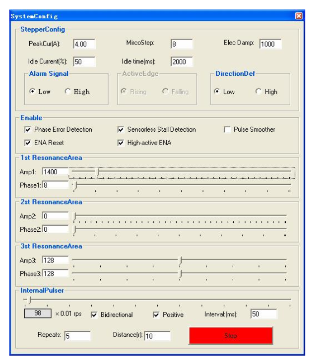

    I'm not sure about the AM882s, but with the software you can configure the EM806 so the fault output is active when ok (i.e. switched on), and goes inactive on fault (i.e. open circuit). That's how I configured my EM drives, which would allow you to loop through all the fault outputs and create a failsafe circuit.
    I never understood what you wrote the first time but rereading it now it makes a lot sense basically setting the fault output to Normally Open. Basically doing the same as with microswitches setting them NC so if there's a dodgy connection line it will fault.
    This is from the AM882 manual not got mine connected yet did make a cable but lost it lol but have more donor cables and usb to rs232 for the job.

    Alarm signal high/low will be it and also interesting I can inverse the AM882 direction in software although I can imagine annoying later down the line when you forgot what you did and are reusing the drivers lol.
    I'm running the stall to the Estop so will need to swap the wiring round on the emergency stop button to NC to match and invert the Estop pin but no biggie.
