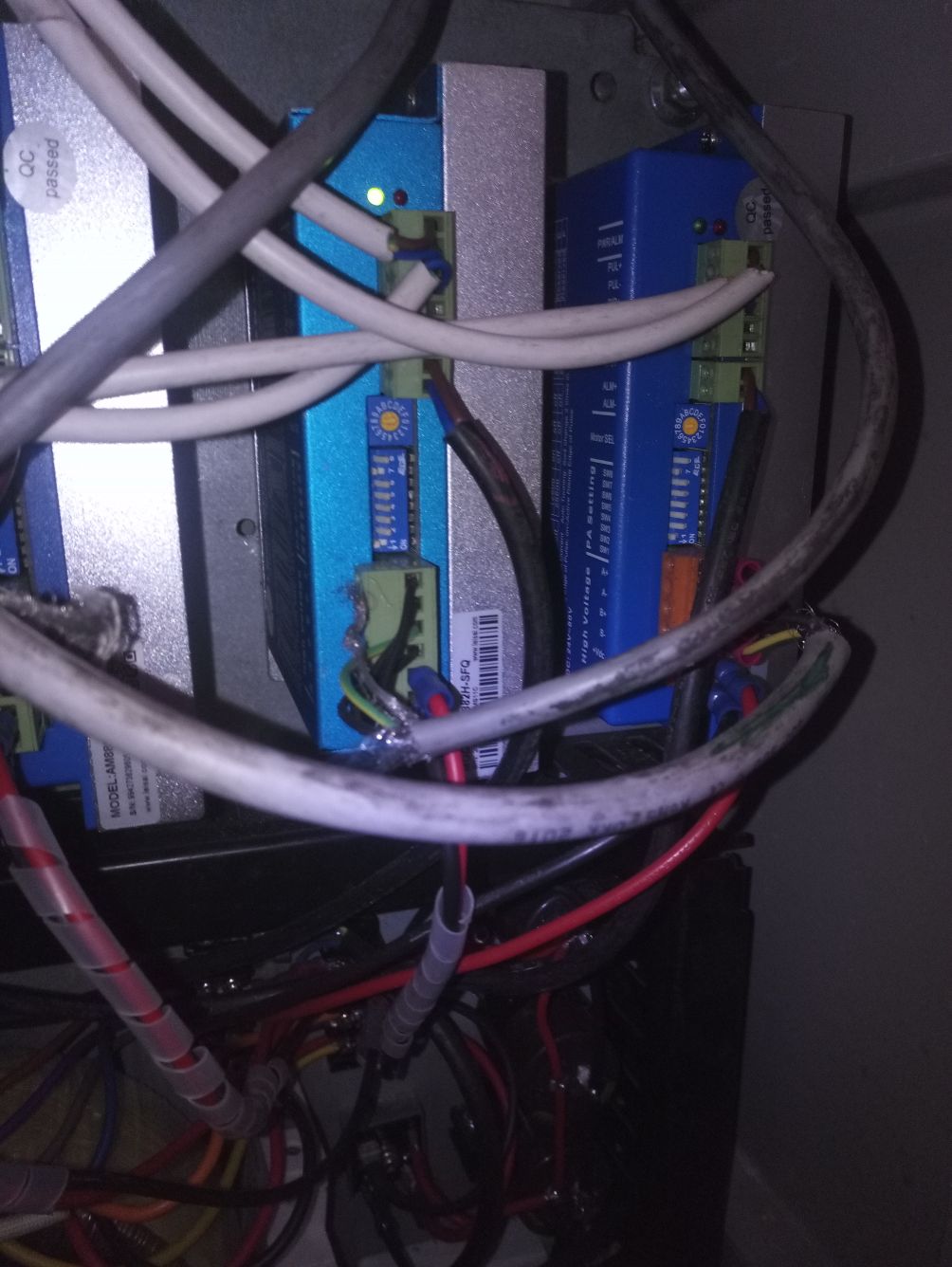

    Jumper setting for my AM882's they're all set the same, I hope they're set to autotune SW4 off/on/off twice in 1 second and 8 microsteps, not sure why I'm out dimensionally.

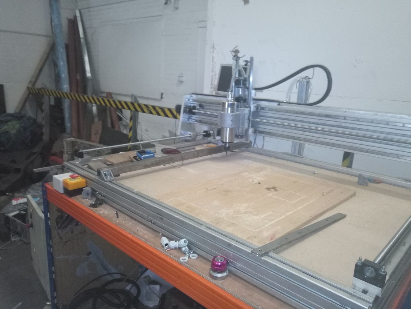

    Machine is exactly 1/2 out (Not sure where I got 85cm from lol) changed to 1:2 ratio and now it's spot on but I would like to understand why.
    At least it's working correctly now and I have 70cm of usable travel on the Y can stretch to 75cm, 120cm*70cm*12cm can live with that ;) So so glad I didn't buy an Xcarve now.
    This time the right size and 4 times quicker so it doesn't rub the wood and smoke lol

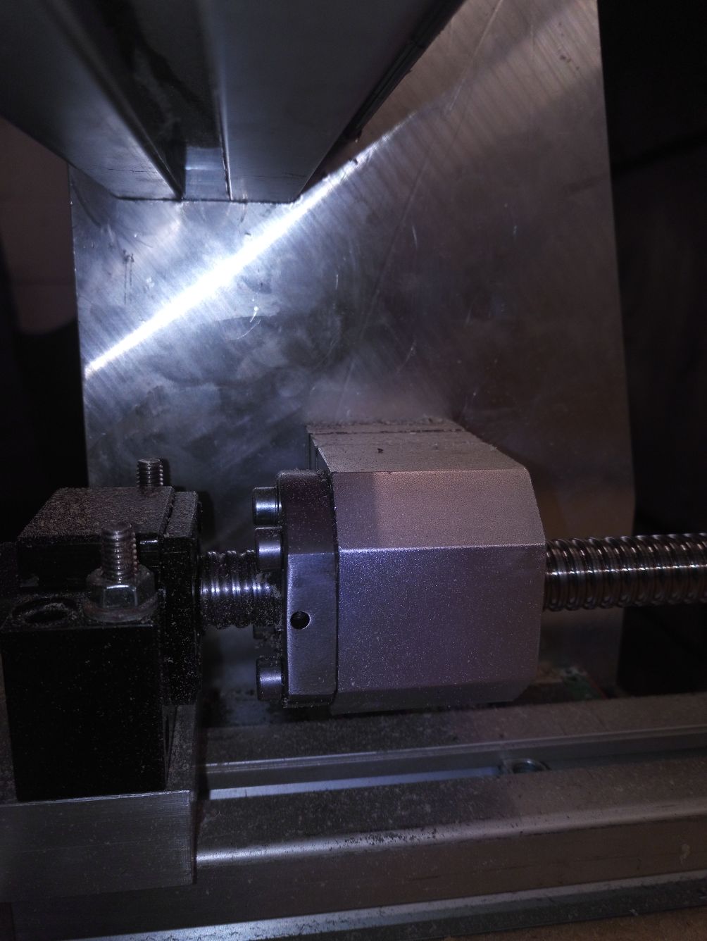

    This is how close X gets when homed now (I have it click the homing switch and travel another 50mm)
    If you see the spacer at the top is slightly loose it's because the bolt's too long by 0.5mm need to strip the Z off and shave the bolt down to sort but need to order the bits I need to add grease nipples to the Hiwin's so I can do at same time. The actual spindle is still rock solid but obviously going to sort out.

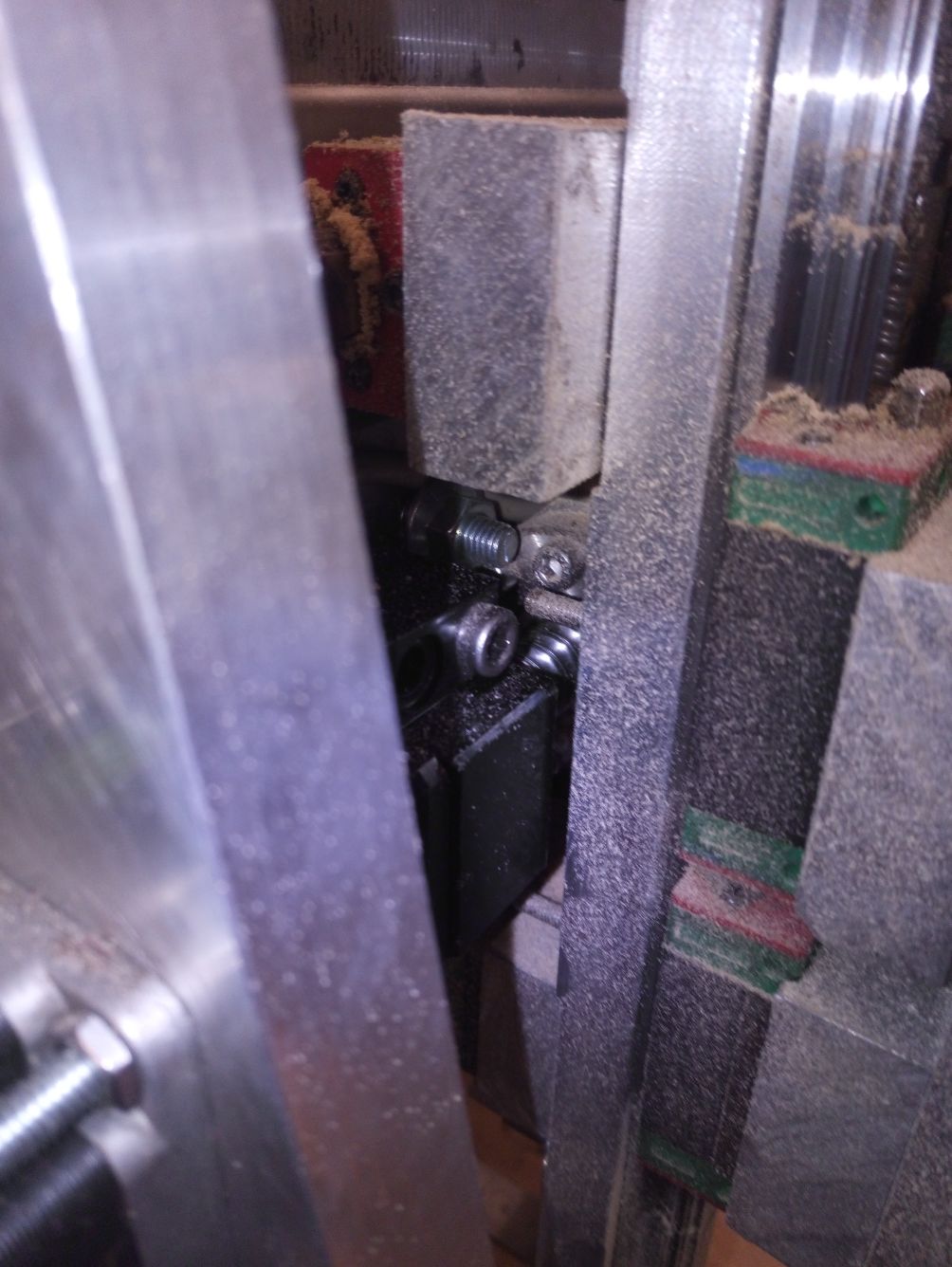

    And this is how close the Y gets when at maximum travel +(700mm) although I still have 5cm to play with on the other side of the bed I think 70cm travel sounds good. It's freaky watching it plough full speed towards the end to then stop so accurately and quickly so close to the end.
