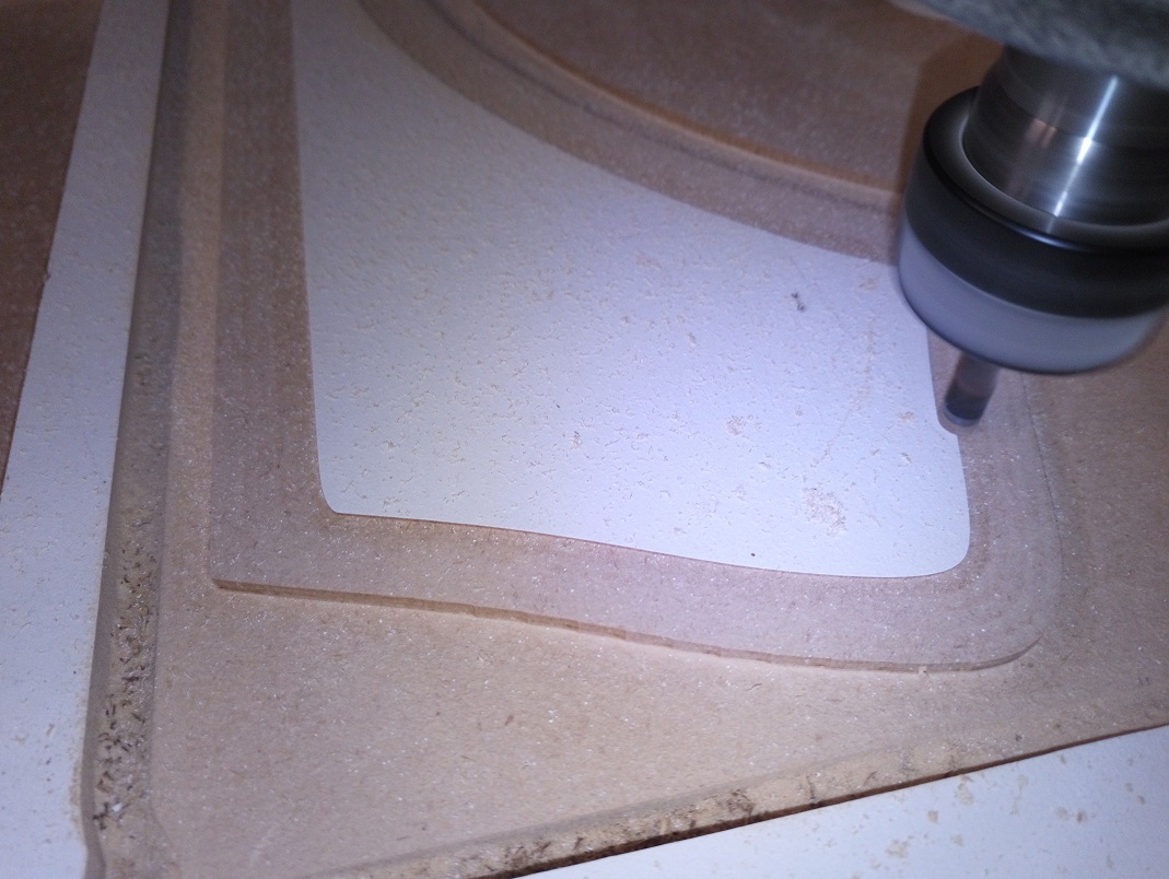

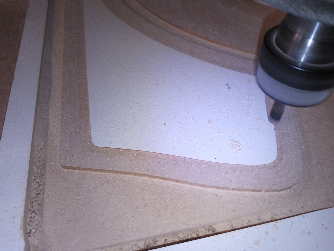

    Very impressed with the cut from the 2 flute 6mm end mill on the laminate I was expecting mega chipping.

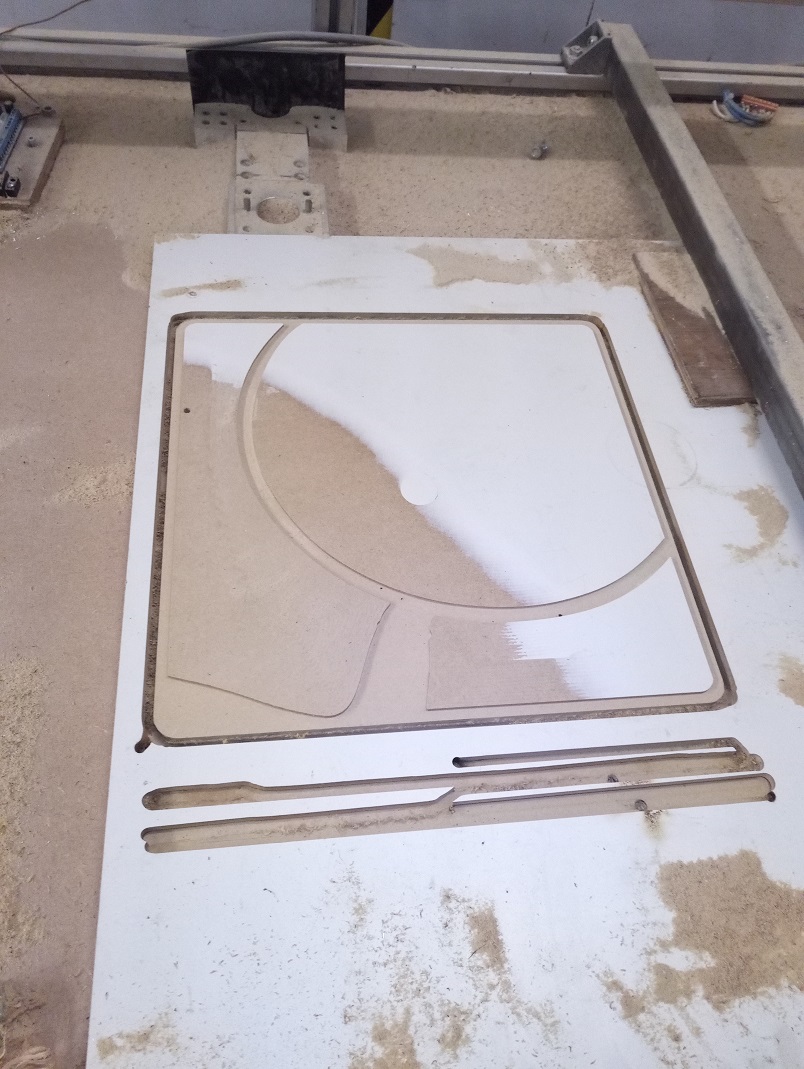

    Because I only clamped one side it wasn't even so the white wasn't milled out properly but it was only a test with some scrap so happy how it came out as soon as my clamps come (Ordered 4 toggles clamps going to use 2020 extrusion across the bed instead of steel.)

    Need to flatten the mdf bed as well, gong to get a 1/2" trend straight router bit to do this as it will be a lot quicker.

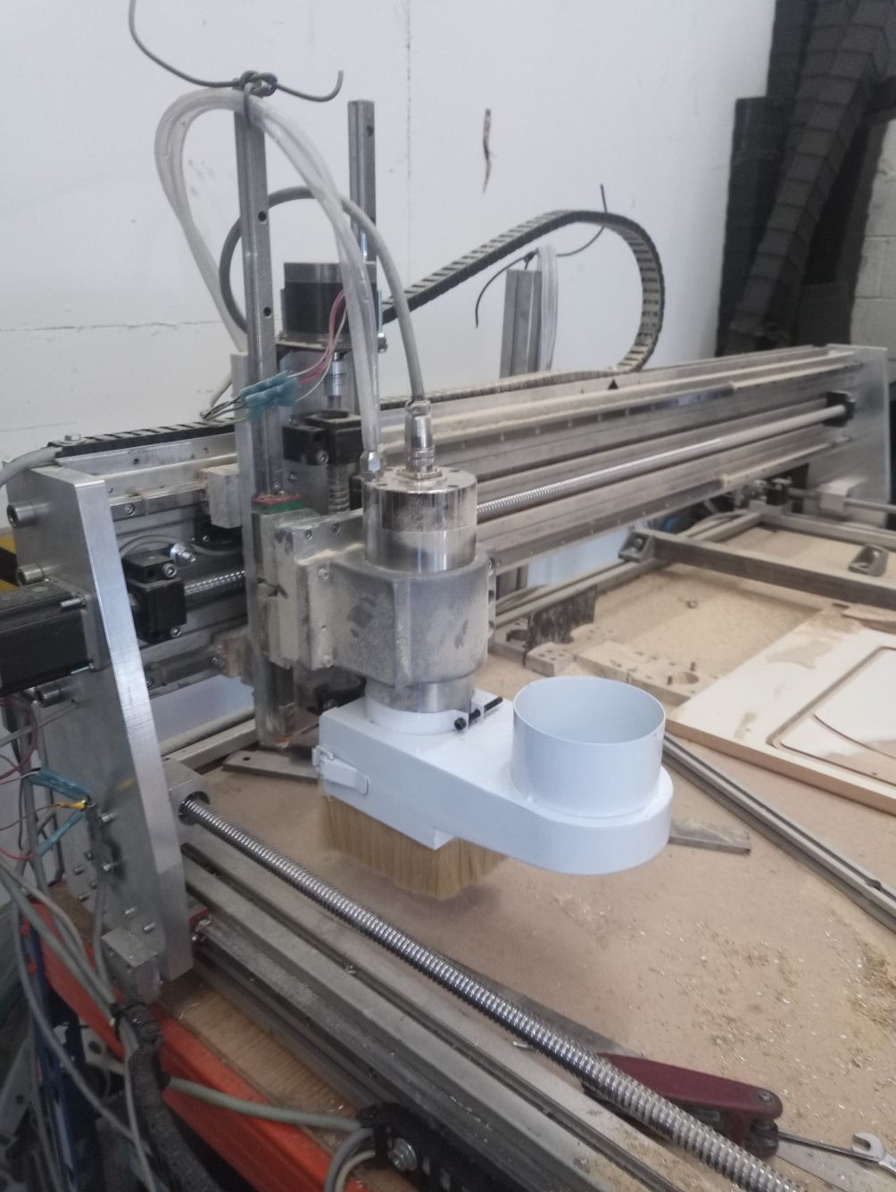

    It came so fitted it, think I'll put it sideways on though so I access the flip for changing bits easier.

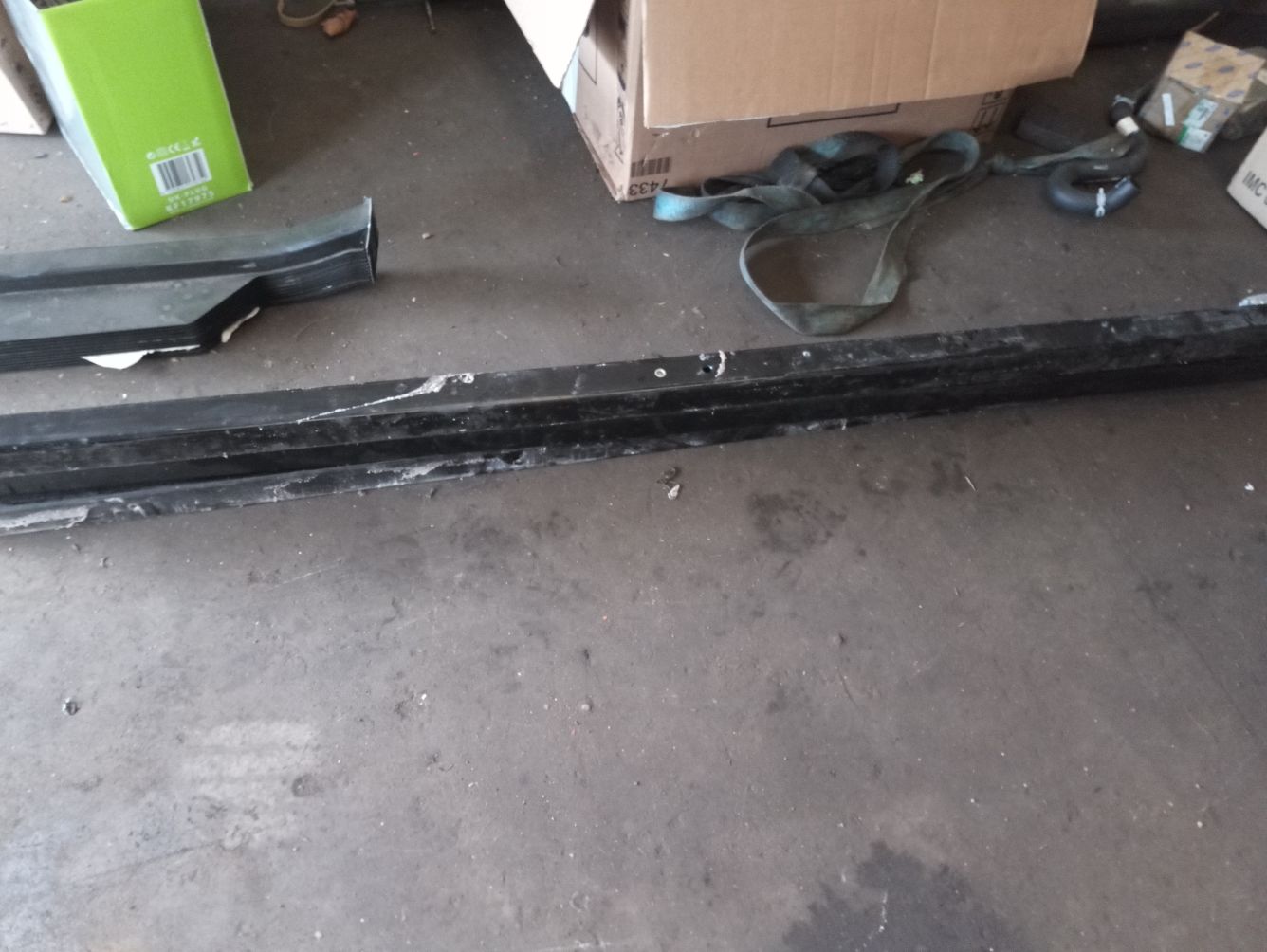

    60*60*3mm box section steel 2.1m lengths going to use this to upgrade my router so work isn't finished yet lol but it'll take me a few months to raise the money for 25mm Hiwin's, proper R&P for the 2m axis and I want to swap my gantry ballscrew to a 10mm pitch. So plenty of time to play with her for the time being. I'm thinking of taking my gantry and dropping it on a frame made from this. I have loads of 40*40*1.5mm box section I can use for bed supports (Again free, sometimes it pays to pikey everything you see lol even if you sit on it for 3 years)
    My favourite price free ;)
    This will offset the not free stuff I had to buy lol

    I noticed that your cy cable to the spindle is not secured in that every time the Z axis moves the cable gets bent at the plug. This is a major fail factor and might destroy the VFD as has happened a few time here. Can you put a supporting bracket from the Z front plate to fix it.

    Yes I can, I had noticed of course but keep forgetting I actually unsoldered it and tried to sort it out but still ended up the same lol.
    Luckily there's a lot of scrap kicking around the yard so sure I can find something to do the job or actually desolder it get the cable in properly and resolder.
