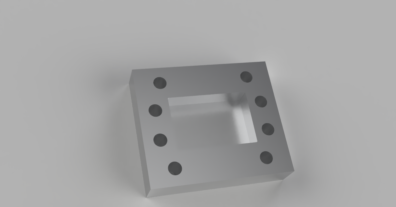

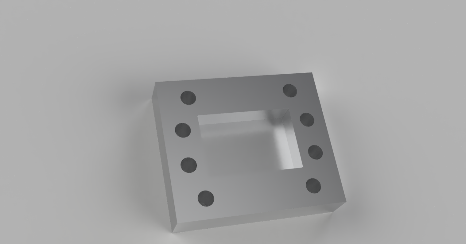

    A quick mockup of the Bk15 mount this will space the 2010 ballscrew to align with the existing nema 23 mount for bk12 if I fit it upside down and it will leave 3mm clearance (Instead of 6mm) for the DSG20.

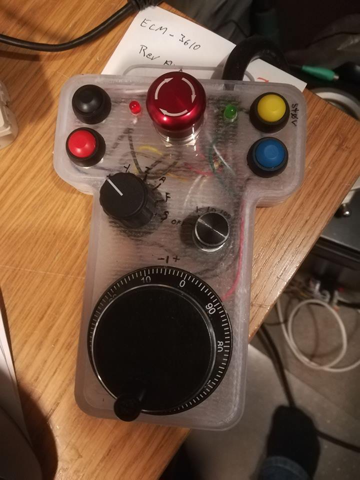

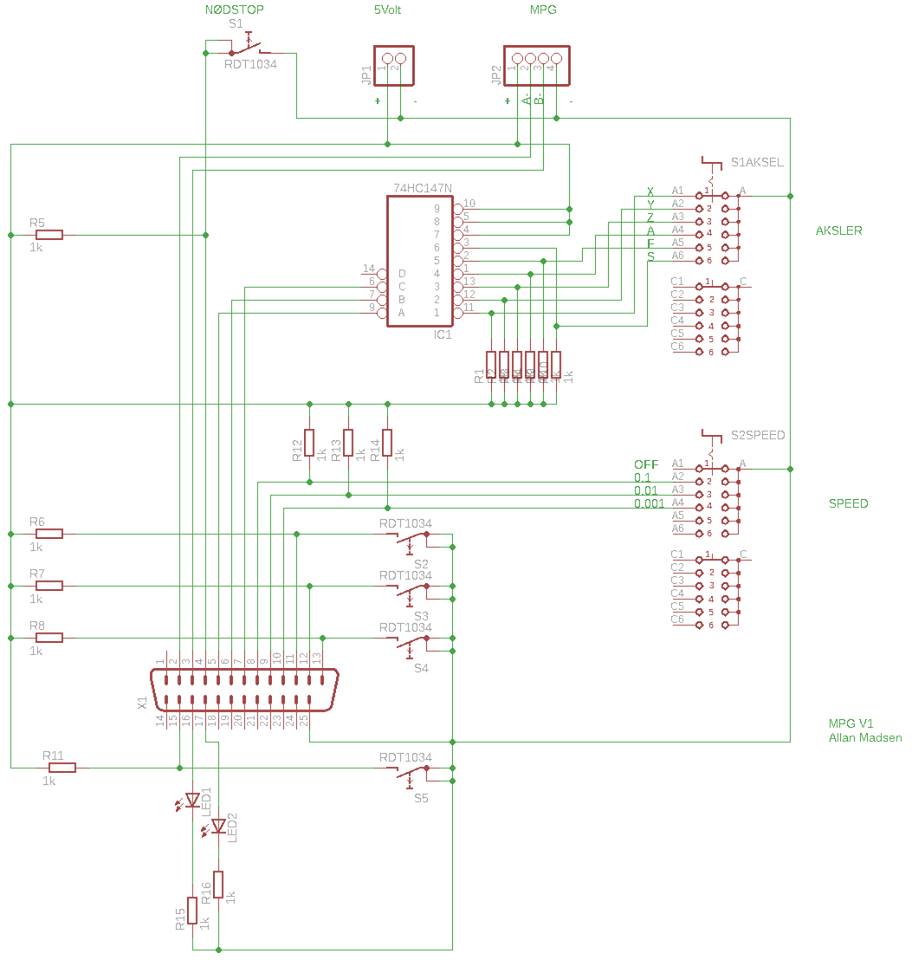

    You might like that.
    It is a diy handheld MPG to linuxcnc a guy from Denmark post at a cnc group on Facebook. The group is the DIY CNC and the member, Allan Madsen, said that today he is going to provide a link, to where he will post the files, to make it work in linuxcnc.

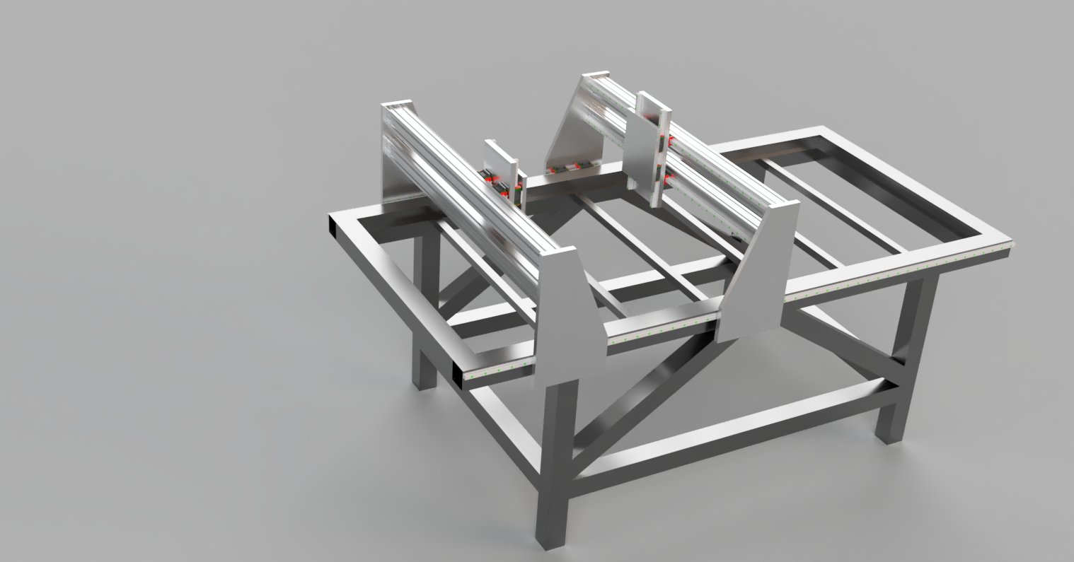

    Had a few crazy ideas for upgrading including 2* 2m travel gantries ;)

    I just cloned the gantry not a proper design yet just floating ideas
