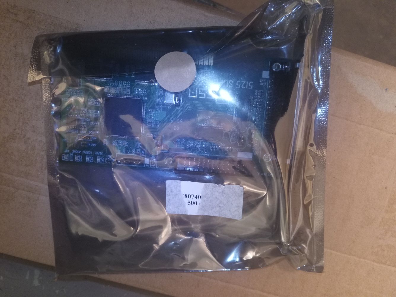

    It's a 5i25 PCI card for step generation in Linuxcnc it plugs into PCI slot on the motherboard and then to a standard parallel port BOB so it should be easy to setup with my existing system, you can buy add on breakout boards for the 5i25 so you can get better performance, even servo control. Basically this card gives you 2 parallel ports outputs with go faster stripes lol.
    For now though will use with my cheapo BOB, my handwheel came today as well but still flued up been off work all week hopefully will drag myself in tomorrow morning to play.
    http://store.mesanet.com/index.php?r...&product_id=55
    From what I read on linuxcnc forums this setup should be able to run 50khz per axis no worries which is good enough for me the actual card can get generate mhz per axis but my BOB is the limiting factor also AM882 have a max of 200khz input.

    Nothing is ever easy grrr, the 5i25 is not working PC won't boot when it's fitted gave up for today as no spare desktop pc to play with but will try another machine but the pci slot definitely works as I had a parallel port card fitted before and working.
    from the linuxcnc forums
    There are certain motherboards (maybe about 1/2 a %) that the 5I25 will not work in
    somehow I just know I have one of those 0.5% of motherboards lol hpefully so then it's an easy fix tomorrow when I'm warmer.

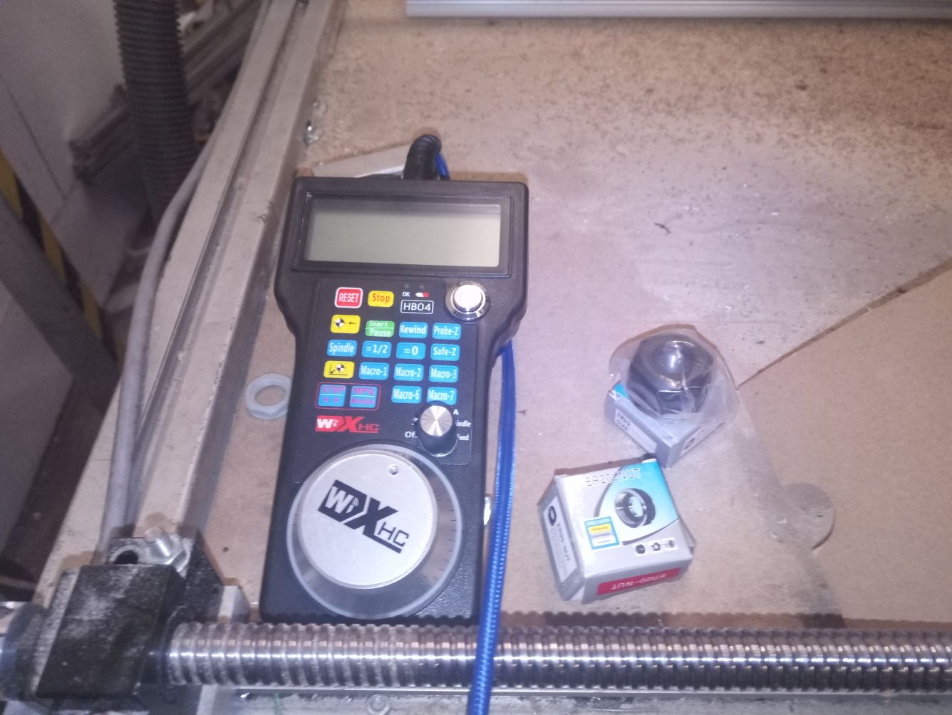

    The HB04 also came and 4 spindle nuts

    Took 5 seconds to connect the hb04 to the test program that comes with linuxcnc and everything works fine, wheel, buttons, etc. But I cannot for the life of me work out how to make it work with linuxcnc itself getting all sorts of errors but then I played with the Mesa and forgot the HB04 for now lol. HB04 problems are to do with joints in linuxcnc if I was using 2.7 it's a lot easier to configure so I will get the mesa to work first then the HB04.
    Spindle nuts so I can keep my popular collets fitted in the nuts for rapid tool changing and they're >£10 a nut from UK supplier if I ever need a spare I paid £10 for all 4 from China 8 day delivery.
  10. #588
