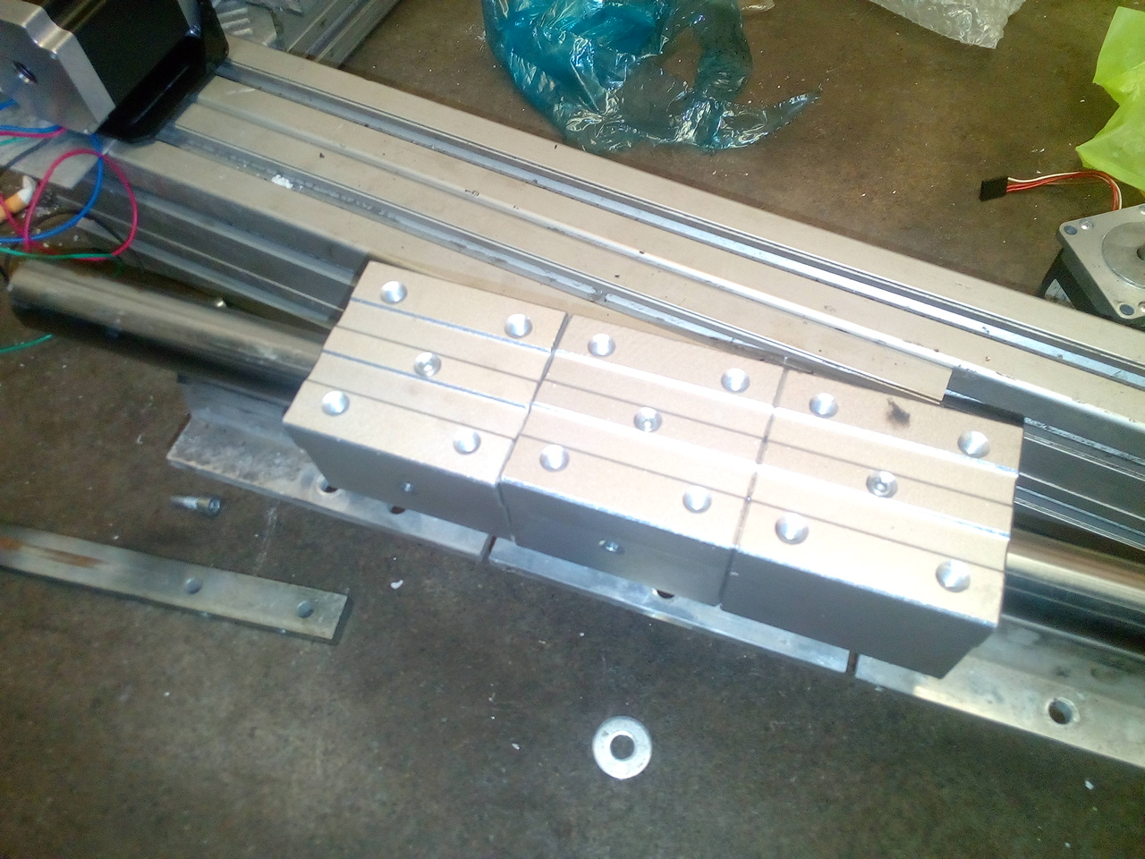

    I would worry that the ballscrew is balanced properly I would think the ballscrew needs to go dead centre of the slides? I have come up with 3 choices for the gantry
    1. Mount it like pictured with ballscrew at top, hiwin sideways on
    2. Double up the extrusion so I use 2 pieces one on top of the other then the ballscrew can go in the middle with hiwin either side.
    3. Put the Hiwin on the top and bottom of the gantry and have the ballscrew sideways on. This is my favorite choice but added complexity in the z axis mount. I would think this would also keep the slides cleaner orientated this way.
    Or I do have this
    But would rather not cut it if I can as it's 3.5m length and I have 2 5 ft lenghts so I only need 1 more and I can build a frame with working area just over 8*4.
    Was worried as the bearing was not sitting straight on the supported rail but tried a different bearing and all is good then realised someone has been playing with my bearing (Joys of sharing workshop space with my dad's monkeys as I call them) and tightened the grubscrew.

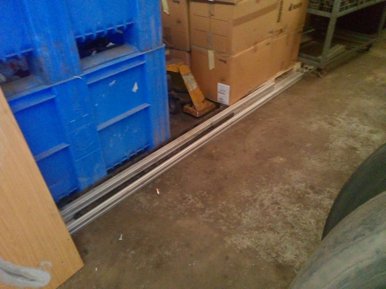

    Wanker guy had sold the machine so I can't get the extrusion :(
    As it happened the Hiwin style slides were siezed and the ballscrews looked worse for wear to so I was only interested in the extrusion but gutted.
    At least I know now so I will continue with original plan and bolt the SBR25 on sideways, no excuse not to start assembly now (Well need to wait for the A2 bolts to arrive but tomorrow) so I can measure up and start to think about the mounting plates.

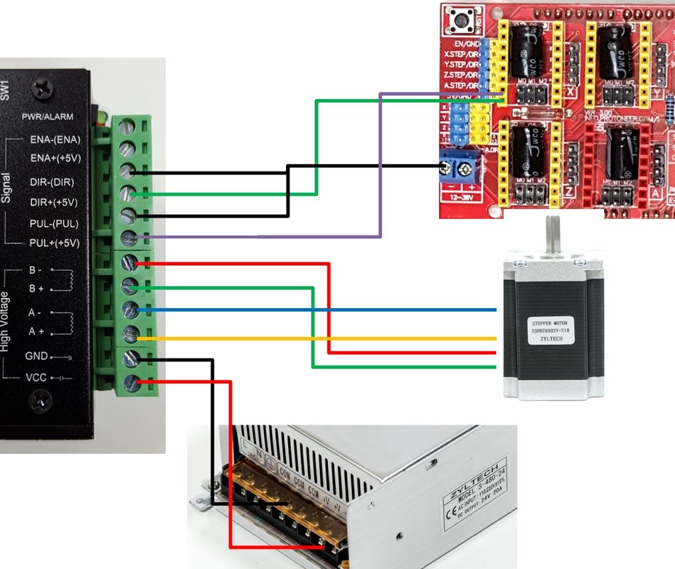

    I'm thinking of buying some cheap ass T6600 stepper drivers so I can deliver the full 3 amps to my motors (Only at 24v) but I will still use Gbrl and Arduino for now with some creative wiring to the cnc shield.

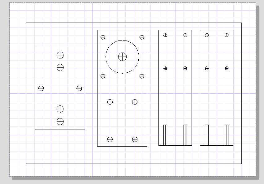

    Finally worked out how to print to 1:1 scale ;)
    When I pumped out to printer it's the correct dimensions, a friend is going to make these parts for me from recovered 6082 aluminium (We like free in case you didn't notice) so I will only need to have the gantry mounts and Z axis mounts CNC'd.
    From Left to right
    BF12 mounting bracket (4 bigger holes bolt into the t slot extrusion)
    Nema 23 mounts to line up with the BF12 mounting brackets for the 2 lower axis (This bolts into 2 rows of extrusion with T nuts)
    The last 2 connect the DSG16 ballnut mounts to the gantry mounting plate for drive of the lower axis.
    I ordered the Spindle today, so next thing is the Ecocast ;) Toying with going with 25mm thick for the gantry and embedding the extrusion 7mm into the frame.

    Think I will get 4 TB6600, use the cnc shield/arduino and a 480w 24v power supply so I can get the full 3 amps out the stepper motors.
