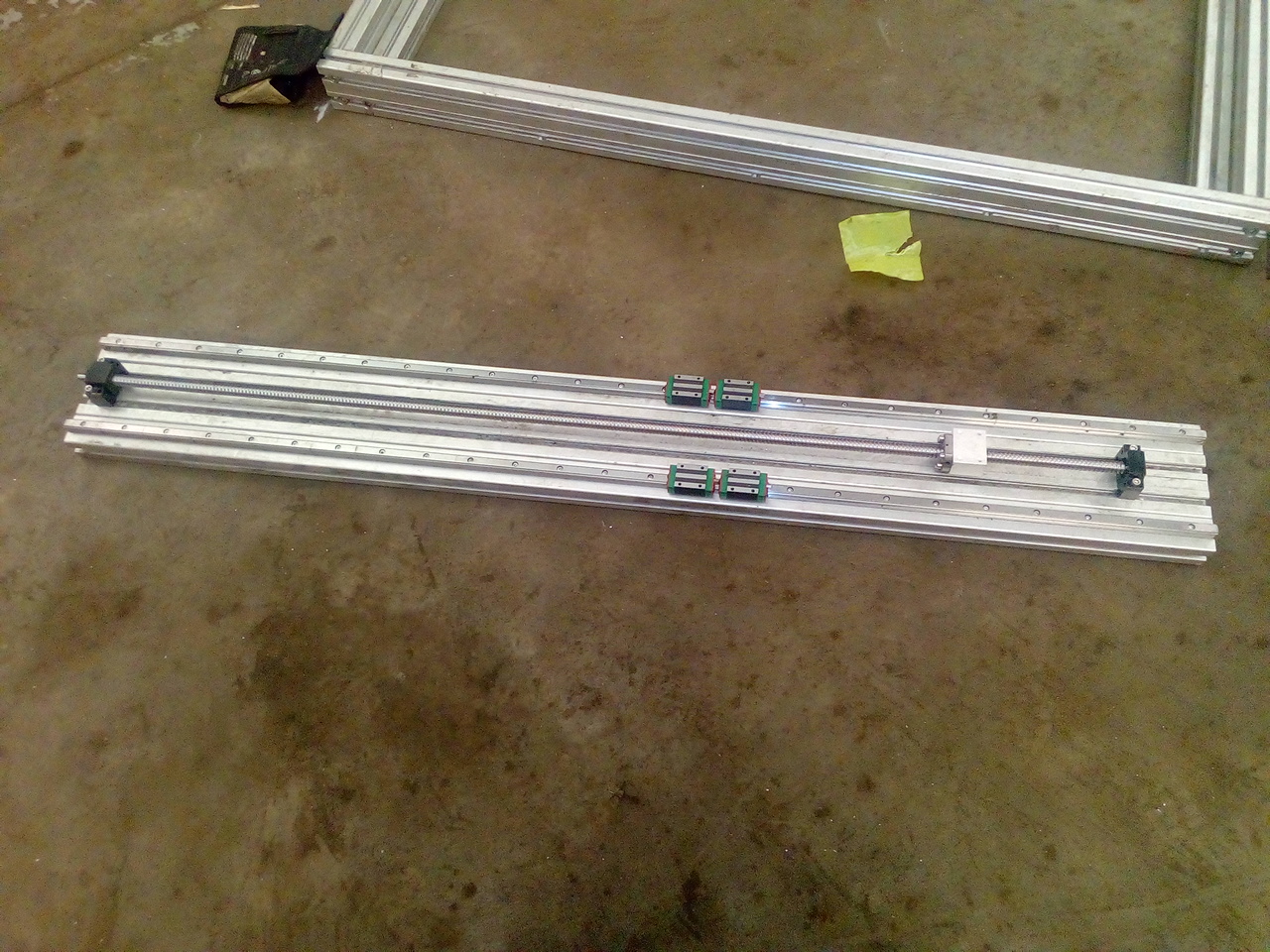

ID:	22608 The ballscrew will have a mount either end to bolt into just laid it roughly where it's going to go, Hiwin's bolted on finally need to cut them down.
    This will be the gantry (Has clone Hiwin's on)

    3 individual pieces 2 * 4545 and 1*9045 will drill 5 holes through the 4545 and bolt using T nuts to the 9045 to reduce flex.
    The Hiwin problem anyone who's used 15mm Hiwin's and a 1605 ballscrew knows this problem lol, it doesn't affect my Y axis because the ballscrews are at right angles to the Hiwin's but the gantry and Z axis both had this problem which I solved with a combination of spacers and recesses.

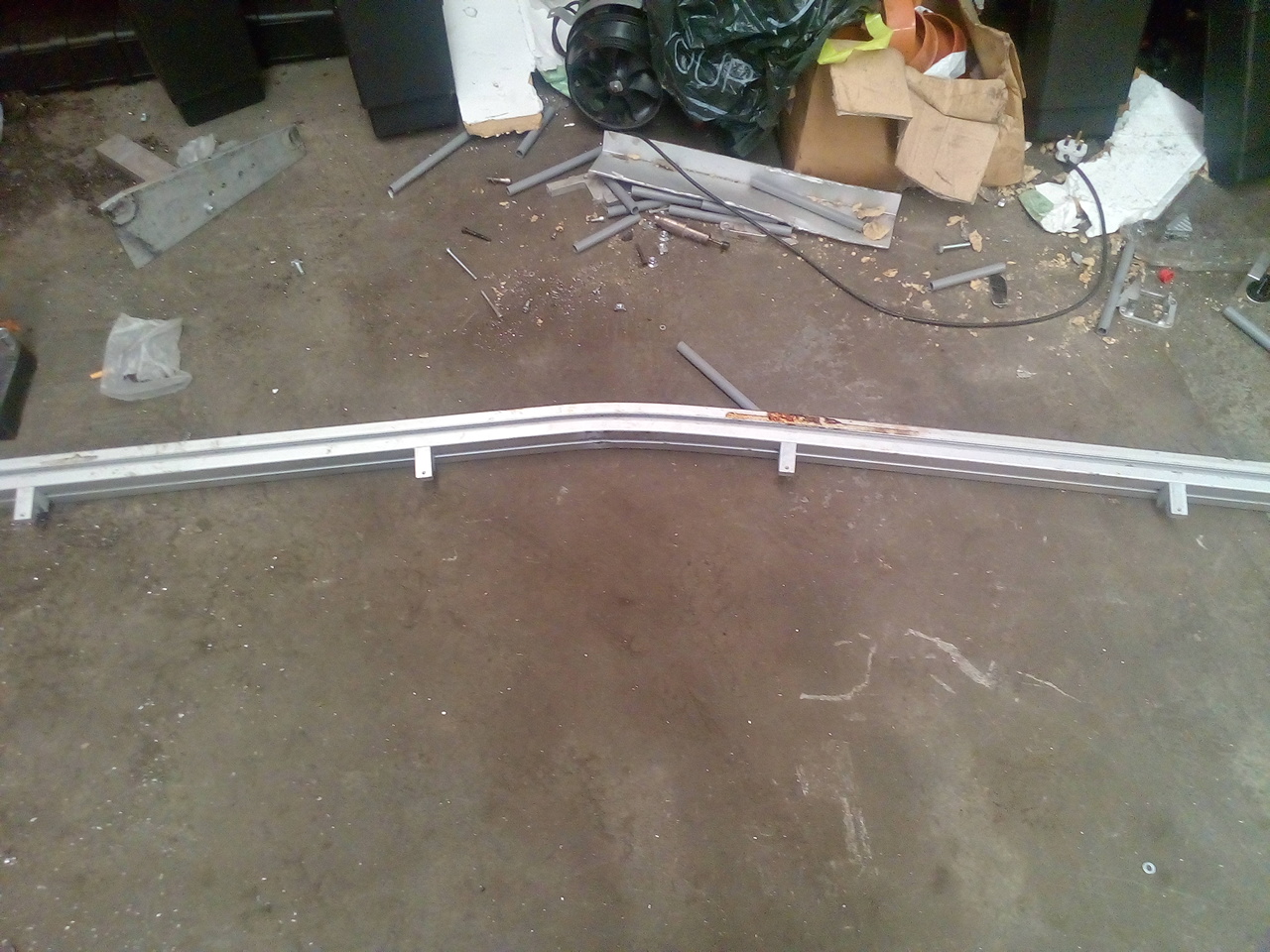

    Aluminium extrusion is strong but not that strong lol

    Heavy duty 6045 I found under the mess when the shelf collapsed this will get cut down for leg supports now.
    I still have 2 pieces of the SBR left with bearing this will be the basis for my positive pressure vac former ballscrew driven naturally.

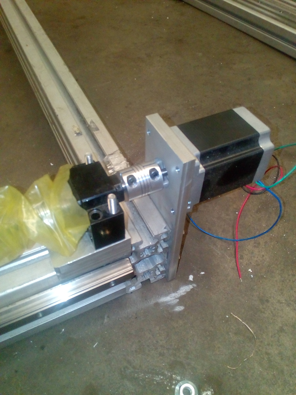

    My custom nema mount and bK12/Bf12 mounts work pefectly

    BK12/BF12 mount countersunk bolts so the bolts go from underneath the other 2 holes are to bolt into the T nuts.
    The ballnut & spacer bolt in perfectly although I removed the bolts again as they need to be cut down 5mm.

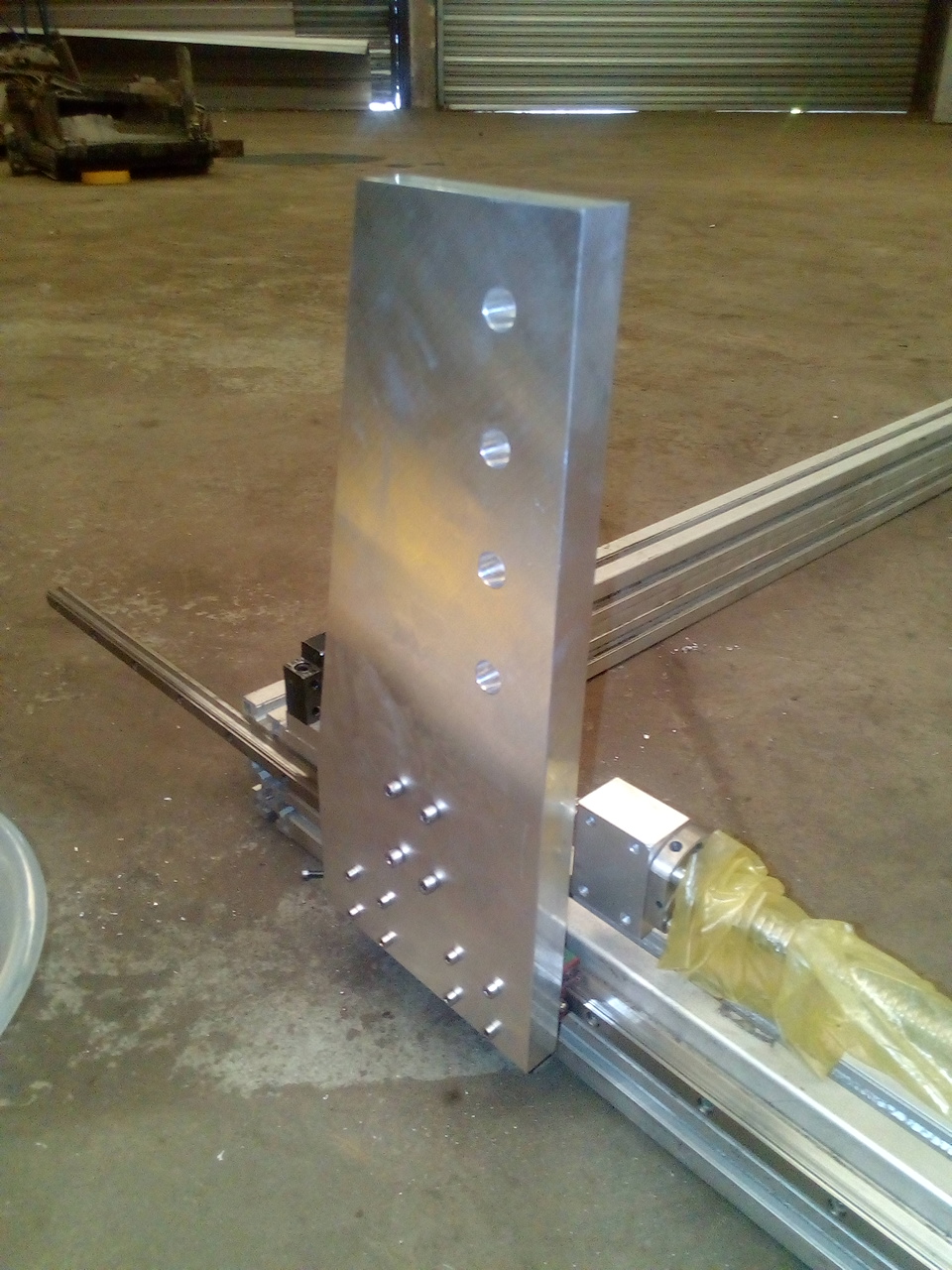

    Lovely gantry parts you have there Desertboy. They look awfully familiar.
    They do there don't they lol, a big thanks for Chaz helping me out here couldn't have done it without him ;) Was leaving the big reveal for when the machine moved ha ha ha but confidence is a lot higher that it will all be good.
    This is my first CNC machine and I designed it myself with a vague idea how my reprap moved lol, the best advice I got so far I think was using 20mm tooling plate for the gantry ;) Then ditch the SBR for the Hiwin's.
    Very happy with my plates from Chaz and the only issues I have come across come from me not measuring everything out properly! After mentioning exactly that in Zeeflyboy's thread I should be super embarrassed lol.
    What happens when you don't bother modelling everything and use some lines and data from the engineering drawings lol.
    And let me say Thor might look impressive but when she moves the earth moves with her lol.
