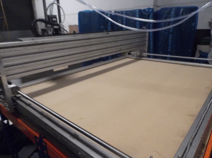

    Got my MDF bed on now I need to make it a vac bed ;)
    I used an 18mm sheet
  9. #447
    Pics or it didnt happen :D
  10. #448
  11. #449
    Looks neat ;)
  12. #450
    Looks neat ;)
    It just fits and I mean just lol I had to tap it in the corners which is the fit I wanted was stressed about this cut as I had to outsource the cut and I knew it would be a bastard luckily I got a friendly a wood guy to help me out.
    As soon as you say i want 135.1cm *100cm people look at you funny lol.
