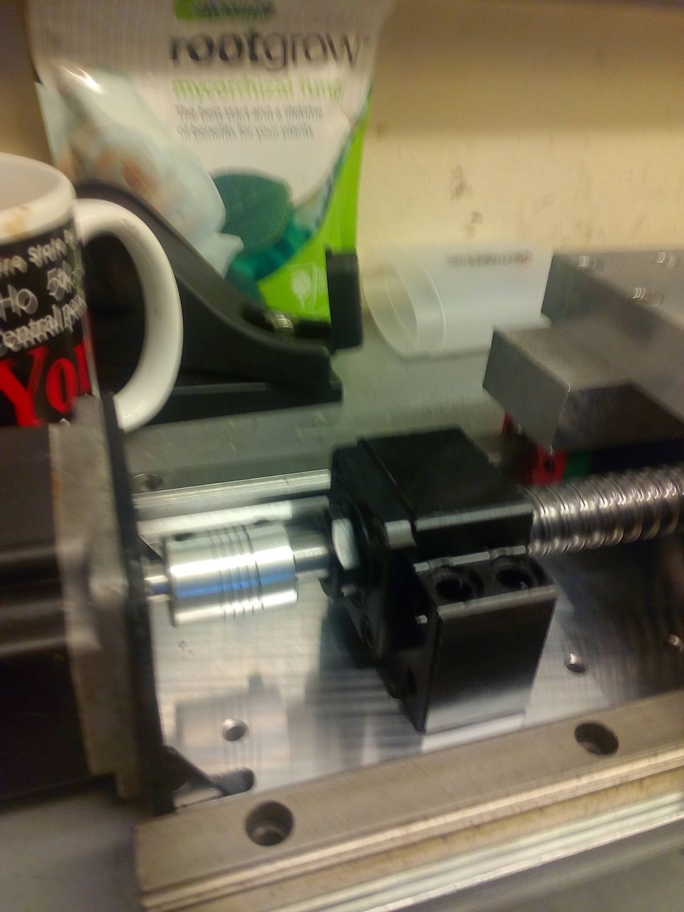

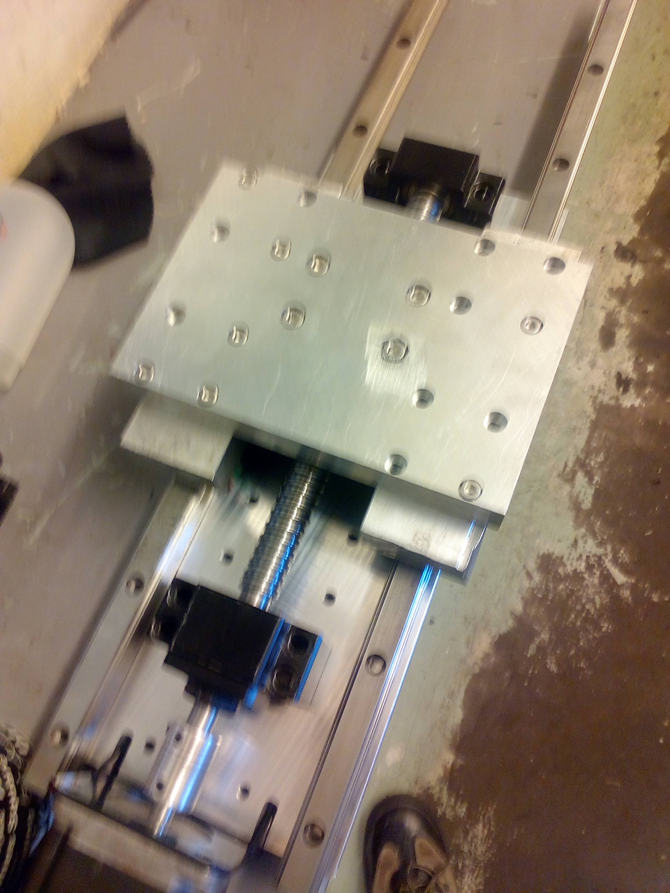

    Poor photo's but got the final plate today all lines up ;)
    I must have made one of the tightest Z axis ever lol
Name:	z axis 1.jpg
    One more plate to collect tomorrow morning (Needed to have 4 10mm holes enlarged got an engineering firm to do it) and we can finally put it all together.
    Been very happy with my nema to ballscrew alignement 3 of the 4 are perfect not tried the 4th one yet (Gantry motor) but I'm hoping we got 4 for 4.
    The bolts in the Z axis top plate are 1mm too long at moment so need to cut them down as well.
    I was worried about the Z plate most of all and it all seems good there's a couple of holes to counterbore in the Z axis but simple job.
    I was going to chop my Hiwin's down for the Z axis but I'm going to leave them sticking over the top of the Z axis so if I do want to rebuild the Z I can get more travel, my travel is just over 8cm at moment.
    When the top plate was being made an end mill broke hence the nasty bit on the top where the scratches are. The part is functionally perfect and the spindle mount is bolted onto this plate so it's also not visible so it would be pointless to remake and a waste of money.
    The scratches I made when I was filing down round where the end mill had broke.
    Big thanks to Chaz for making the plates and it was a pure pleasure to see Thor and an experience to feel her move lol, Thor truly is something else.
