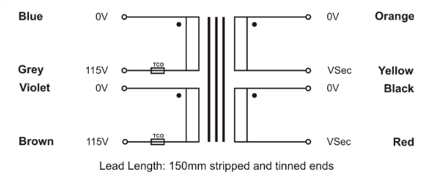

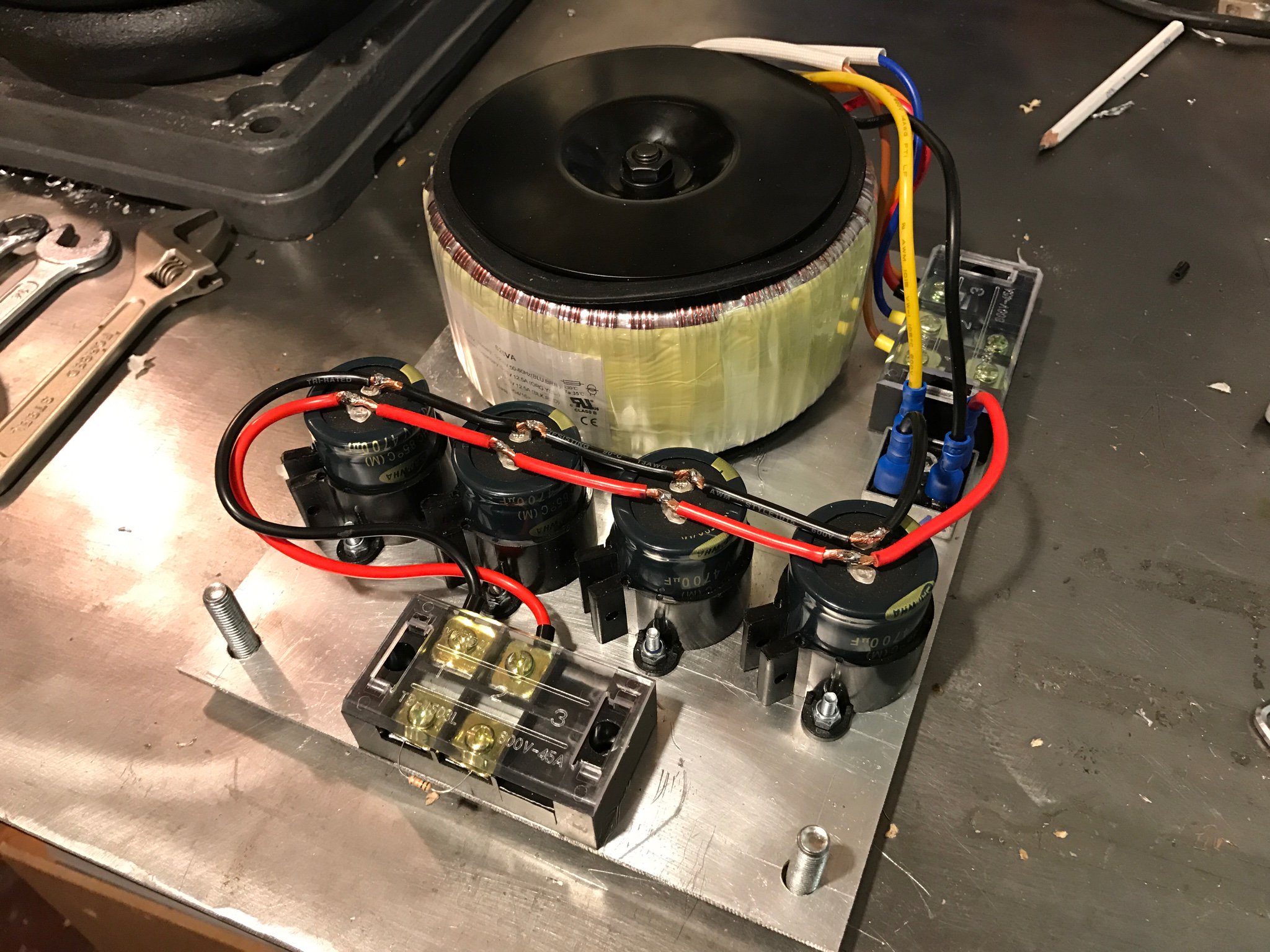

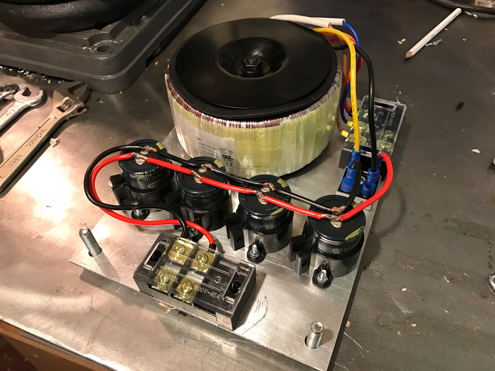

    Started the PSU build quick question,
    where do the grey and violet leads go I assume this is 1/2 the input coil?

    I have 2 primary cores 115v and 2 secondary cores 25v.
    Not quite as pro as Joe's build I did it all by eye with a dewalt lol. And yes that's the side off a pc case lovely recycling.

    I think I need to connect blue and brown together and grey & violet to the mains?
    I'll have the spade terminals for the bridge rectifier but do I solder to the capacitor's directly? And how do I ID which is live and neutral on the capacitor?

    Ok what does it say on the side of the transformer
    If the schematic that you have shown has come with the transformer then follow it.
    on the sec. side short yel and black together then red and orange go to the AC side of the rectifier.
    on the primary side short grey and violet together and connect the mains to brown and blue.
    Before you connect the caps up measure the voltage on the secondary side of the transformer (it should be around 50v AC) With the caps connected DC side it should be about 70v dc (DON'T TOUCH THE CAPS WHEN THEY ARE CHARGED as they will bite you) without a load on they will stay charged for a long time.
    See my other post also the yellow and black are incorrect. The secondary wires go to the AC side on the rectifier you appear to have leads on the DC side
    Edit turn the caps around in the holders so that all the +ve are on one side (you have them all in a straight line)
    Nice one! The diagram was from the datasheet on rapidonline's website.

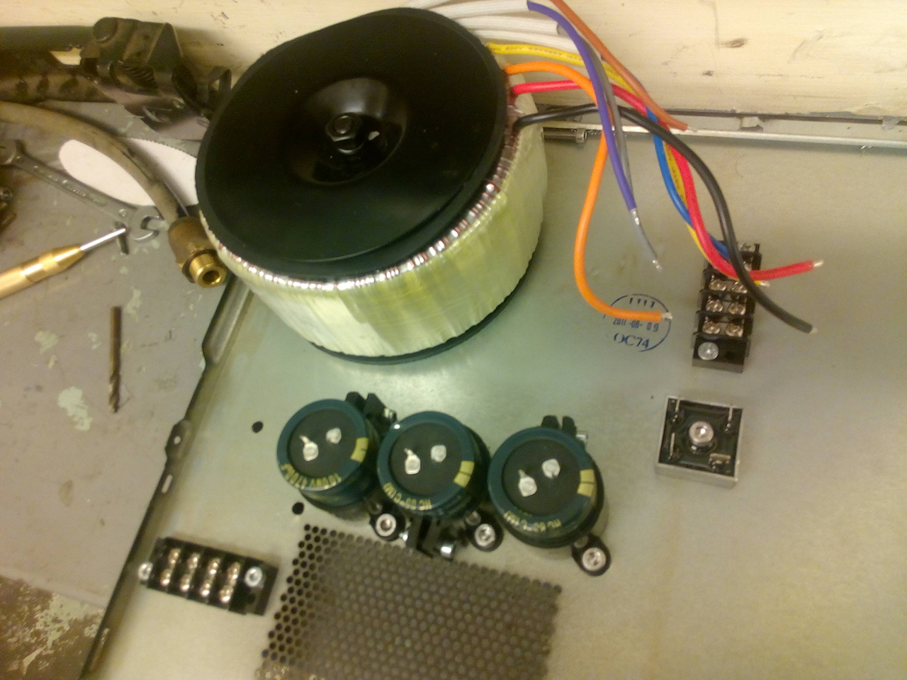

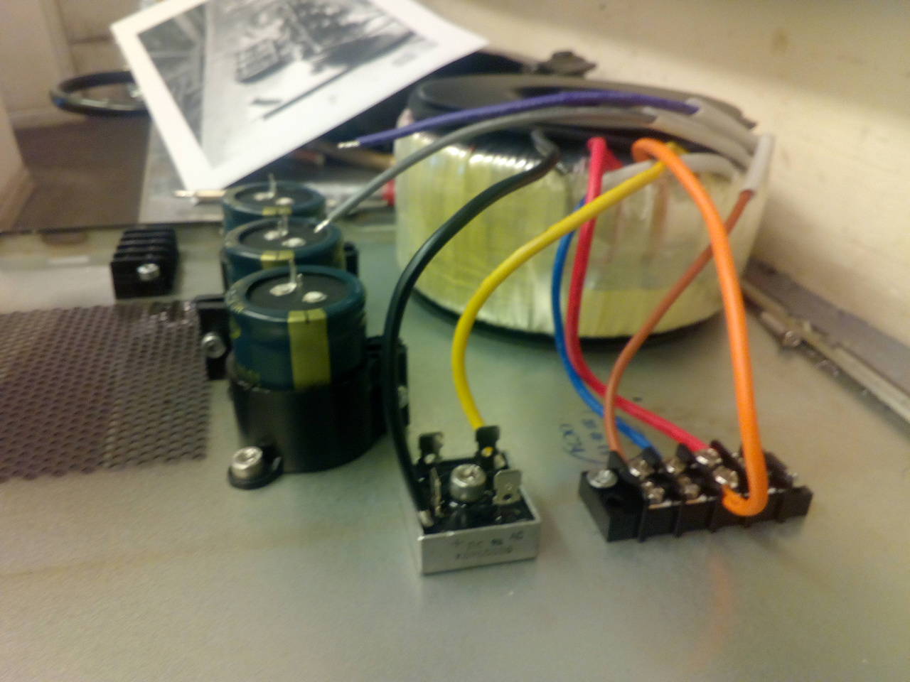

    I was using joe's psu as a guide
    On Joe's he's connected the red & orange together, blue and brown are going to the mains, then he only has yellow and black (1 primary core I guess) which he has going at diagonal across the rectifier. I didn't really get what was going on how Joe has it wired but what you said is how I thought it should work ;)
    I'll connect a 10k resistor like Joe across the outputs to discharge the capacitors but will avoid them been bitten more than once repairing ps2's.
    Looking at the rectifier datasheet I can now see why it's connected diagonal
