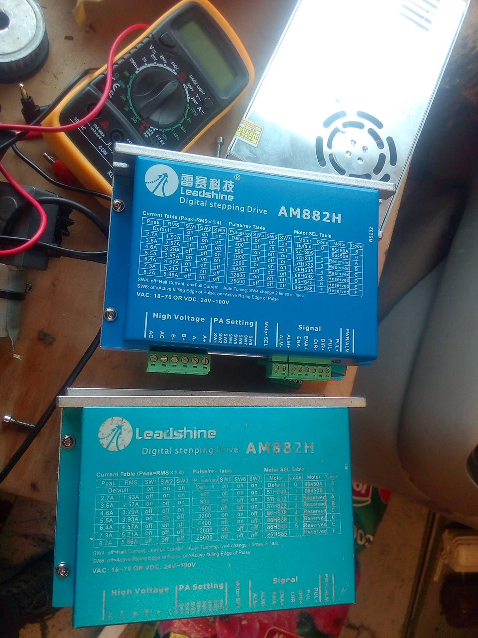

    Had to go work at 4am this morning and then drive for 11 hours so not in the mood lol but when I got back work a nice surprise the other AM882's came with NO import tax!
    Just luck of the draw but now have all 4 so really have no excuse to get her cutting this weekend ;)
    Including the import tax I paid £215 for all 4 2nd hand not sure how good a deal that is compared to new from UK.

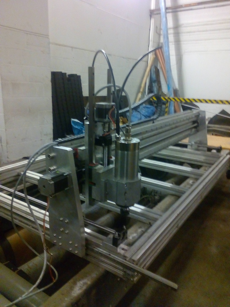

    Spindle is on
    My spindle mount drilling is atrocious (Table slipped) some how I got it on straight and tight but I'm going to buy another one and use my machine to get it straight this time. I won't chuck the old one though I will fill the holes with chemical metal and then when I rebuild the Z axis I will use 2 spindle mounts one on top the other to get a really tight spindle.
    £17 for another mount not the worst mistake and it will work for now.
    I would really like joystick control and digital readout wondering if Linuxcnc would support this with an analog joystick. I'm thinking get a flight sim stick and a throttle then if possible I could use the throttle for spindle speed now that would be uber cool if you had an air cooled spindle you could literally close your eyes and pretend your in a plane lol.
    e2a ordered another mount will do it right next time not worth messing about, will take me at least a few days to wire this up.

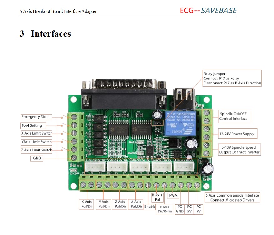

    I'm confused where everything goes and how to wire it up. I'll try and explain what I understand please correct me where wrong I normally am lol.
    I can see the X, Y, Z & A pul/dir go to the AM882's, the power from the stepper motor PSU goes directly to the drivers not through the BOB.
    I think the limit switches one wire to each input and the other wire to the shared gnd? I need 2 limit switches for my Y and 1 for my X can I reconfigure the Z axis limit to be my 2nd Y? I want to set linuxcnc up so it squares the gantry. I'm going to use microswitches for now but I might use inductive sensor instead do I simply find 12v for the sensor elsewhere and wire 1 wire to the Axis input and 1 to the GND?
    Tool setting is this the input you would run a probe to? Again is it a shared gnd?
    Emergency stop run my stop button to it AND the outputs from the AM882 for stall protection.
    I believe I don't need the enable pin out
    PWM must be pulse width modulation but for what?
    PC GND and the 2 PC 5v outputs where do they go?
    the spindle on/off and 0-10v are self expanatory but the 12-24v is that an input for driving the board? If not what is it used for. I thought the board was powered by 5v from the USB socket.
    What does the relay jumper do?
    You are going to have a problem with this bob because you won't have enough inputs to do what you are trying to do.
    for instance that bob and most simple bobs only have 5 inputs. You will need two for the homing for the slaved axis. Then you have all the limits they can be wired in series to one input that leaves two. you have to home Z and the other axis. So the probe is out of the question.
    The E/S button would not be connected to the stall on the EM882 This should be cutting power to the drives power supplies etc. though a contactor or whatever.
    The 12-24v power is for the inputs and the 5V is to power the BOB. connect the two power -ve together. I would not use power from the usb for anything.
    If you are using linuxcnc I would download the 2.8 master branch and get to see how it works. Also I would connect one thing up at a time and see if it works as intended then move on to the next problem.
    edit:
    this changes what pin 17 will do, you have two choices either the relay OR the B axis dir. You can't have both.
    I ordered a 2nd BOB and PCI parallel port card would this give me the extra inputs I need?
    You can if you can configure the pci PP ok but you are giving yourself a big learning curve.
    Re the 5V then connect it to the terminals on the bob.
    If it was me in your position with no knowledge on Linuxcnc then I would get the router working with Mach3 first. Remember you have also to build the game table as well. I think you missed your September deadline

    5 BOB inputs is just enough. I'm assuming you are using microswitches here - it gets a whole lot more messy if you want to use inductive sensors. All limit switches and home switches can be wired in series to one BOB input except the X slave home switch which must have its own input. I would only use one X limit switch, BTW - that should be fine. One input for touch plate. One input for estop and fault signals in series. This is because a motor stall fault needs everything to stop fast before the gantry gets twisted sideways. And there's still one input spare!
    If you really wanted, you could take the Y home switch to the spare input. This buys you the ability to simultaneously home X and Y to save a second or two during homing. I've done that on my machine just because it looks neat but it's hardly essential.
    I'm afraid I don't know how slave axis homing works with LCNC - I switched to Mach3 from LCNC before slave homing became available.
    I would take 5V to the 5V input terminals. The 12-24V input is for a separate PSU and you would need that to use the 0-10V analogue output for VFD speed control. Otherwise the BOB can't generate enough output volts from the 5V supply - common problem with 5V BOBs.
