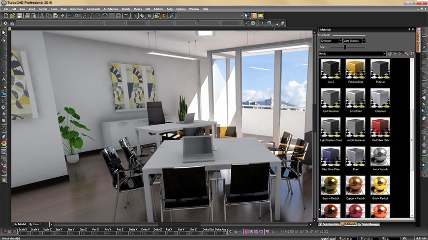

    I think TBF on turbocad this is a properly set up render
    I think it's pretty bloody good for a cad render.

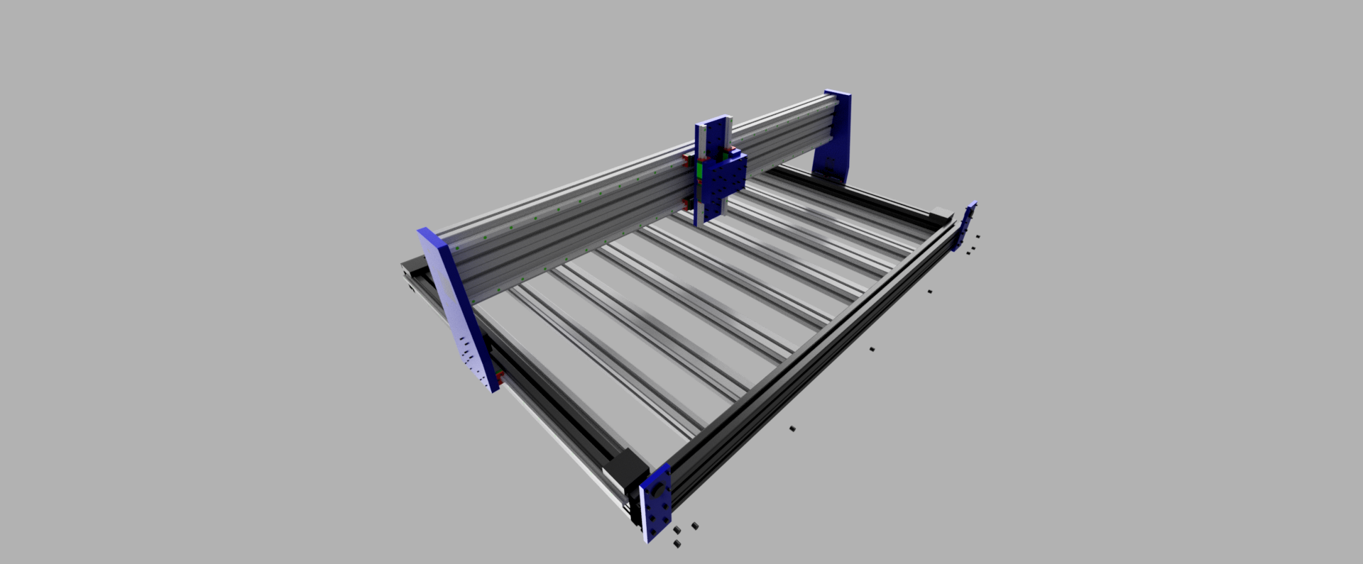

    e2a fusion can create some nice shots with little effort
