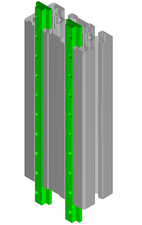

    I think I will make custom T nuts so I can offset the hole to align with the Supported rail mounts to ease mounting.

    I think me and my friend can make them with his router table but I will probably have them cnc milled to make my life easy to get everything straight.
    The other choice is have the extrusion drilled through accurately and then bolt through the extrusion. This might be cheaper BUT I intend to swap the supported rail for new rail at some point and the rail I have now has a different (Wider) mount to standard supported rail. So I end up with holes where I don't want them.

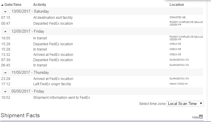

    Ballscrews are in Standstead ;) so hopefully Monday they will arrive although we shall see how much import tax we get.
    Tracking shows they did nothing for a week and then in 2 days it's here I wonder in future if I can pay a little extra for Fedex not to sit on it for a week lol.
    I ordered them on the 28th took a week for the Chinese to organise fedex then a week for fedex to collect lol and then air mail in 2 days without the 14 days of mucking about they would have been super quick.
    I ordered other stuff from china since that came quicker in the normal ems post lol.

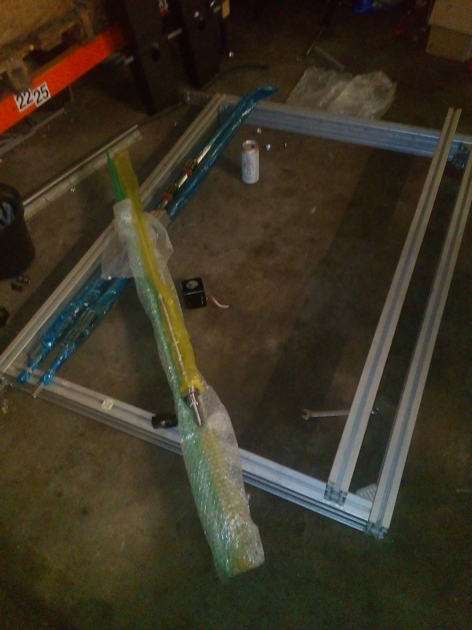

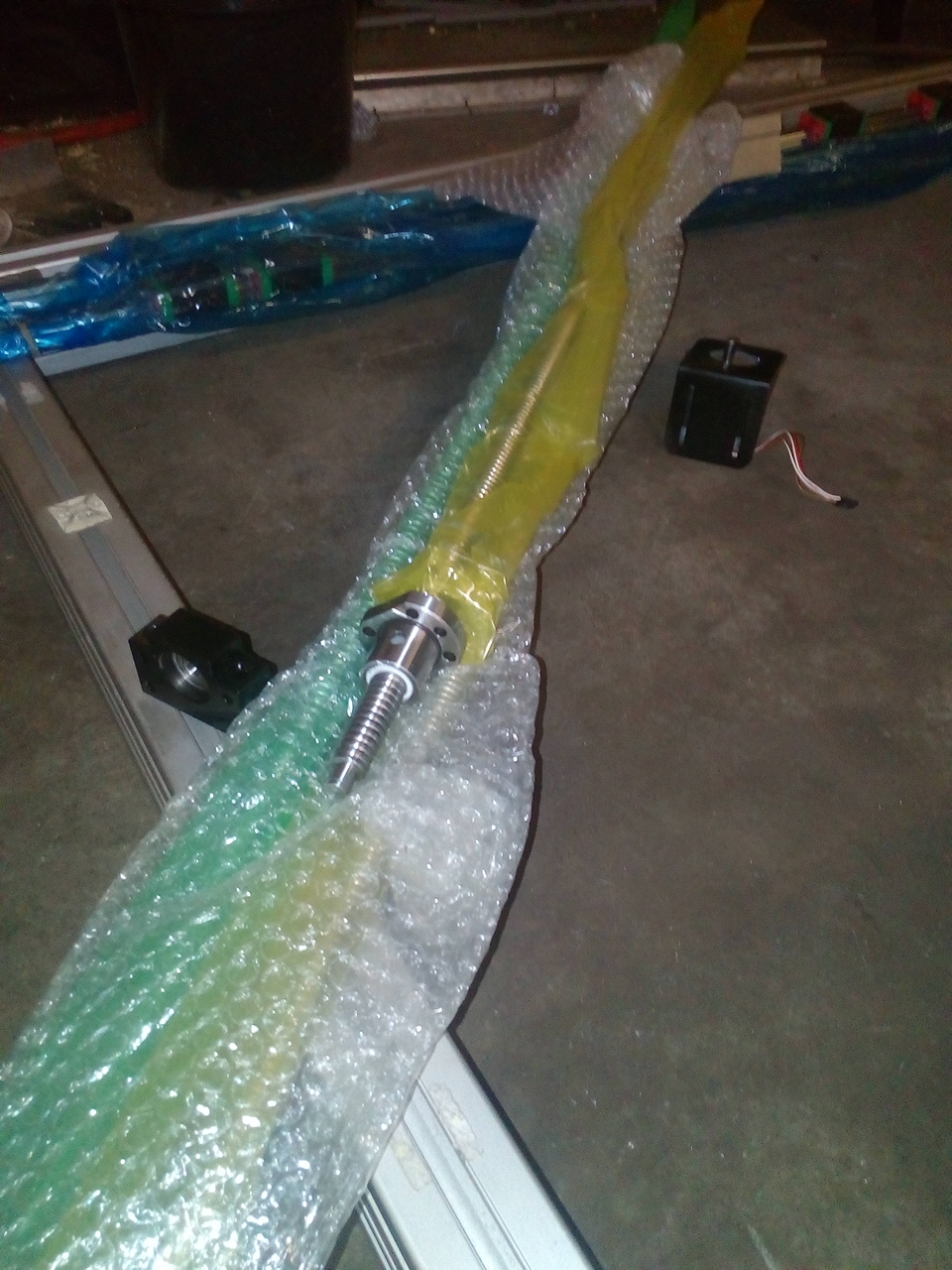

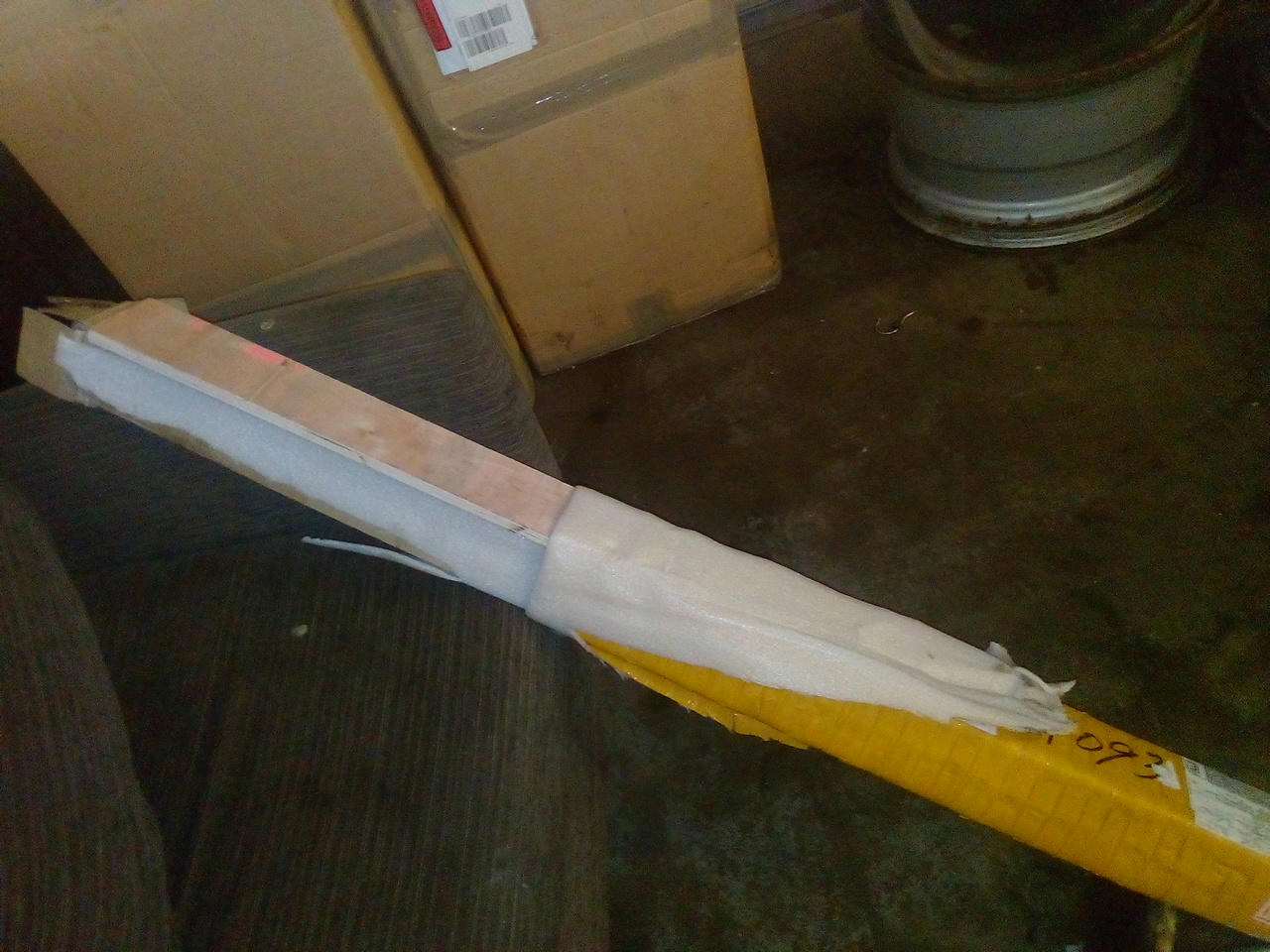

    Ballscrews came ;) So Saturday will be play day and then Sunday cad day and Monday start getting the plates made for mounting everything.
    Ballscrews were packed extremely well with plywood to keep them straight very happy with purchase and NO IMPORT TAX!!! So very happy.

    I find the Carlsberg export is essential to any machine build lol especially on a Friday night ;)Click image for larger version.

    The ballscrews were packaged properly

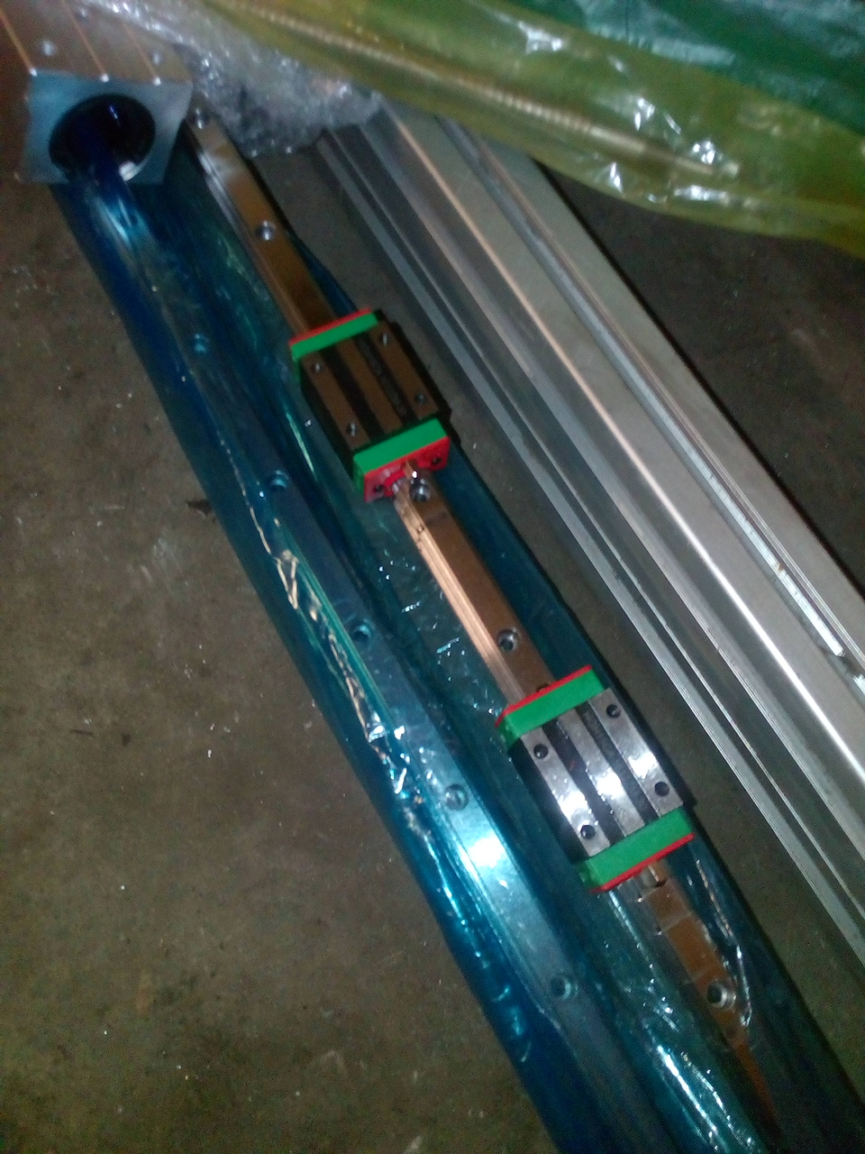

    I love how tight the hiwin rails are (I paid £100 for 4 blocks, 1500mm long 2 rails) they're lovely to slide but I do worry 15mm is too flimsy.

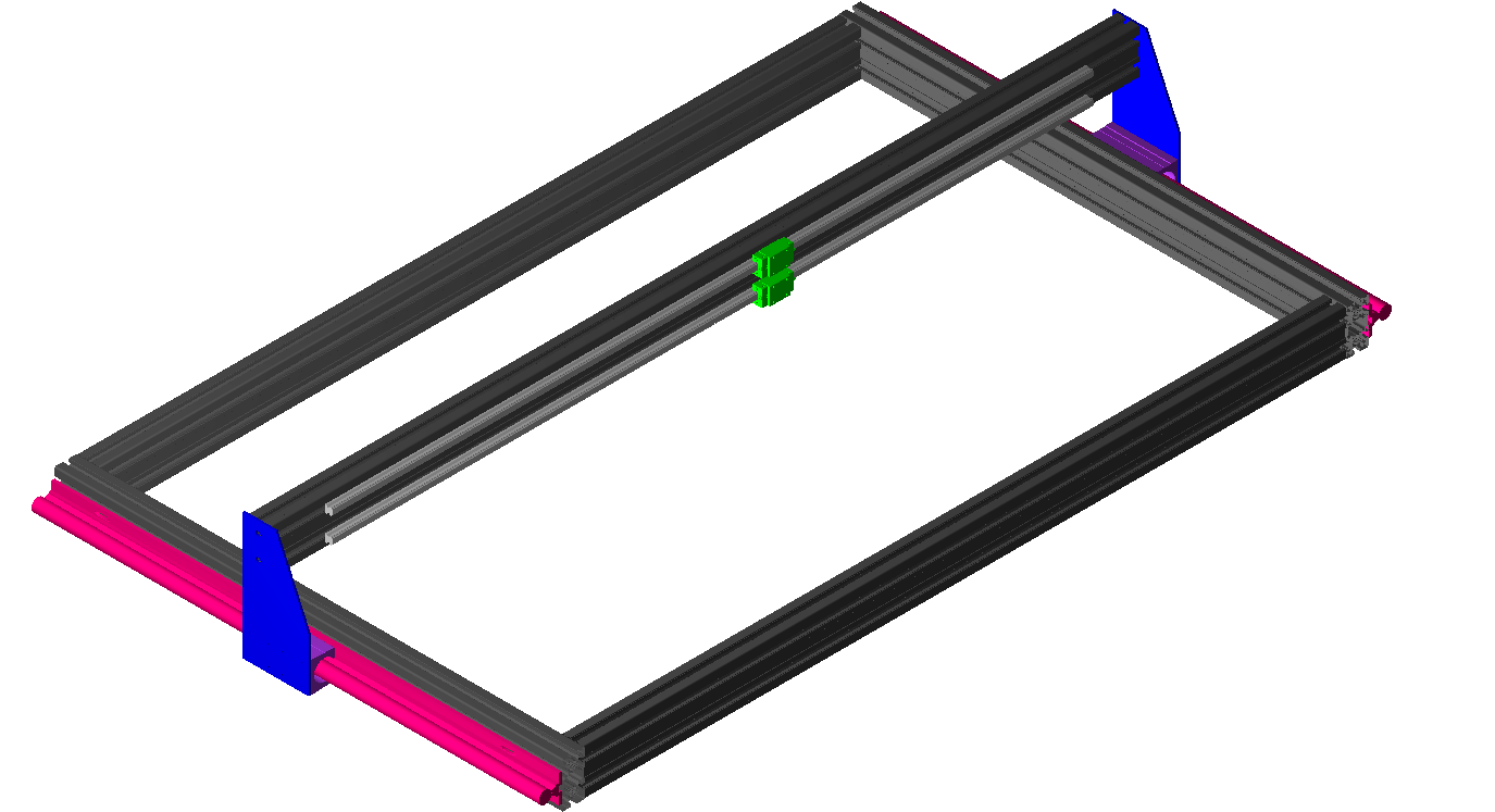

    I did some basic cad so I can work out the mounting plates so I can either manufacture them myself or get them manufactured but unfortunately my decent computer is at work at moment so had to use the old laptop which doesn't support decent quality renders so this is the basic rendering made everything different colours to make it easy to see what's going on.
    Need to add the ballscrews in of course and motor mounts but this laptop is so slow, will worry about z axis when I've actually build it ;)
    Glad I started to cad out as I already see a few things I should tweak winging it was a stupid idea lol.
    Seems it would be better to built the gantry spanning the shorter width of the machine? Any particular reason you are building it that way around?
    Gantry tends to be the weak point in terms of allowing flex, the shorter the span the more rigid it will be for any given thickness/extrusion type.
