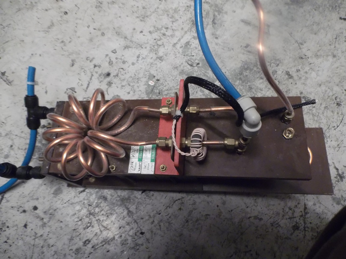

    What are they? I first thought they were radiators I have 2 of them, when I stripped them off they were full of water. Came from a large controller box for automated machinery, also recovered a 75amp 3phase RF filter box.
    Attachment 23126
    Attachment 23129
    Just a pure guess but they could be part of the supply for an inductive heating setup.

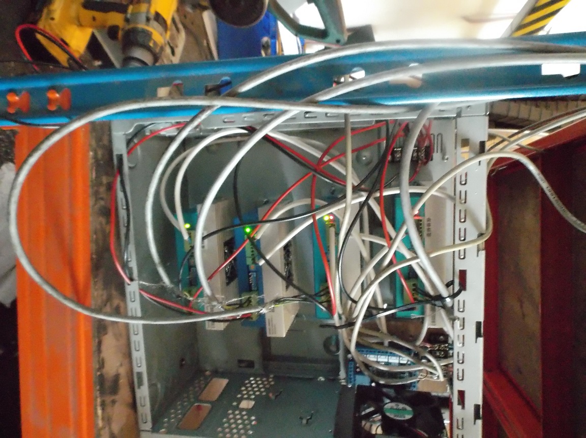

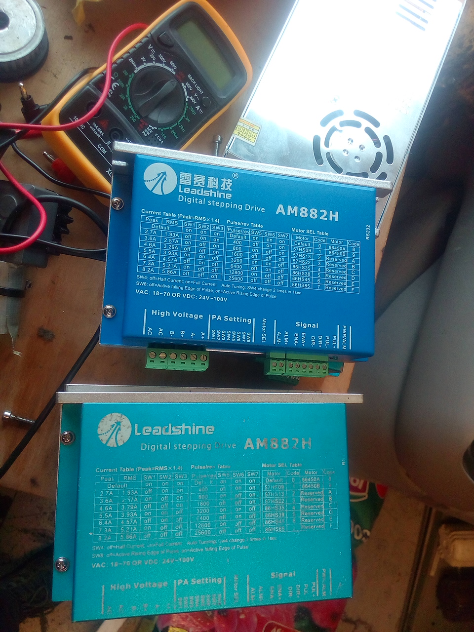

    Almost, almost there switches are wired to the BOB now, I've took power from the PSU case to a connector block then split it 4 ways to the AM882's.
    Quick question my AM882's the power in is marked AC for both inputs which one is the + and which one the -?
    I'm using DC obviously.
    I have my water cooling feeds in/out installed, just got to connect the motors and the spindle and plug her in ;)
    e2a Just realised the alarm is wired wrong on mine, manual makes it confusing, will swap them over
    Doesn't matter in this case - because the power inputs can handle AC or DC, you can connect the DC either way round.
    As Neale has said. But not all AM882 are the same I think you have bought them from different sources so check all of them. I think it is the AM882H that can handle AC or DC and the AM882 is only DC. As usual could be wrong.
  8. #297
    You right the AM882 are DC only they discontinued them now in favour of EM806 which I should have bought. Oh well think it'll be ok anyways ;)
    Next time going for a stepper motor, encoder, driver combo all round. Expensive but really the only logical choice.
  9. #298
    Morning, quick question.
    My PSU is in an old PC case when I run power from mains to the PSU can I drill a hole in the pc case add a bolt and nut then use a round terminal to connect the earth from the mains to the pc case to create a ground?
    Is this safe? I'm then going to bolt the PC case with the AM882's to the PSU's case so that's grounded and then I can connect the metal RF shielding from the CY cable to the am882's pc case and it's shielded.
    does this all sound good?
    Also how I understand it I do not ground the CY cable at both ends (In my case at the stepper driver end) is this correct?
    She's going to move today fingers crossed ;)
