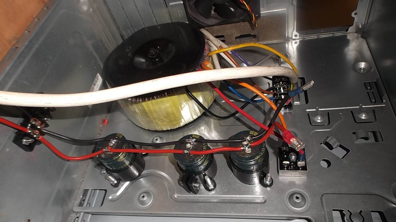

    The pic shows a block with the red wires connected but to my eyes the black wires are not connected as one of them appears to be in the wrong connector.
    shorting the output of the PS with an amp meter would probably wreck the meter.
    I doubt you have blown the caps or the rectifier. If you want to discharge them put a small value resister across the caps temporally like 220 ohms or a mains light bulb across them.
    put your meter on the AC range and check the voltage on the input and output of the transformer.
    Have you checked the fuse on the input?
    Lets see a good pic of the PS

    I thought that too but i think its just an illusion lol

    Why don't you just fault find your main PS after all you will need it.

    Right going back to check it out in a minute, will get some pics.
    The probe on my meter was black and the spark was large it was only a £5 meter as well and still seems to work fine. I have the PSU wire to a junction box I tested the power at the junction box a steady 247 volts.
  8. #318
    Not good, I pulled the PSU out tested the capacitors they read 45v I discharged them with a light bulb setup. Then tested unplugged the capacitors from the recitifer and turned it back on and tested the output of the transformer diddly squat. There's 240v going in but nothing coming out.
    I tripled checked the soldering whilst not neat there's no shorts and it's all on very tightly no possibility of loose connection.
    Tomorrow I will test each coil individually but I have no hope.
    My AM882's turned on with the 24v but one of them is still permanently red led so I think that will need replacing.
    Well that shows the caps are OK.
    Now check to see if you have continuity between each winding pair on the transformer after you have disconnected it fro the rectifier
    I doubt the AM882 has blown the transformer. Did you have it working at one time or is this the first time you powered it up
  10. #320
    Hi, right I have continuity on only 3 of the 4 coils one of the primaries has no continuity I assume this means thhe thermal fuse blew and I'm pretty screwed. Going to get another multimeter to test it with to be sure but not looking good.
