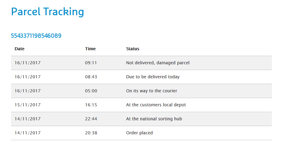

    Looks like I'm going to have wait at least another day the AM882 will come from China quicker lol
Name:	my hermes.png
    Been on phone will either be redelivered tomorrow (If it's ok which it will be of course, things are like house bricks) or new one sent out for Monday

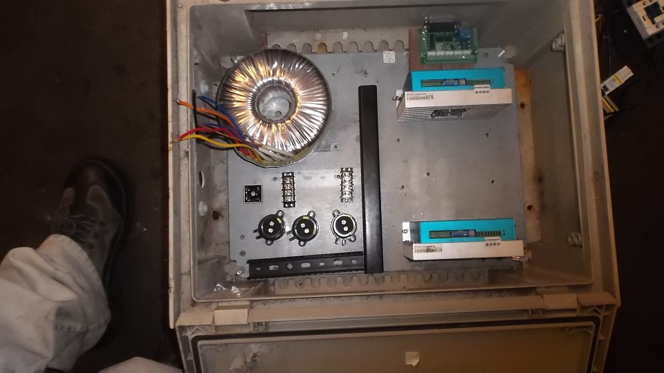

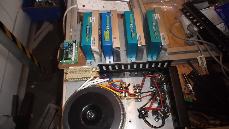

    Using the 50v transformer as a pattern (the 45v will be identical) so started to think about kitting out the box, anyone see any issues having the transformer under the stepper driver? I am going to fit 2 pc fans one sucking in and 1 extracting.
    Going to use new capacitors as I have them and am going to need to fit everything a bit tighter.
    You can just see the breakout board in the corner on a bit of ply will fit it roughly there and chop a hole with a cutting disc for the parallel port and USB to stick through.
    Not sure I will fit the other BOB as I really don't need extra the input pins, good to have a spare though.
    What's everyone set there AM882's microstepping up at?

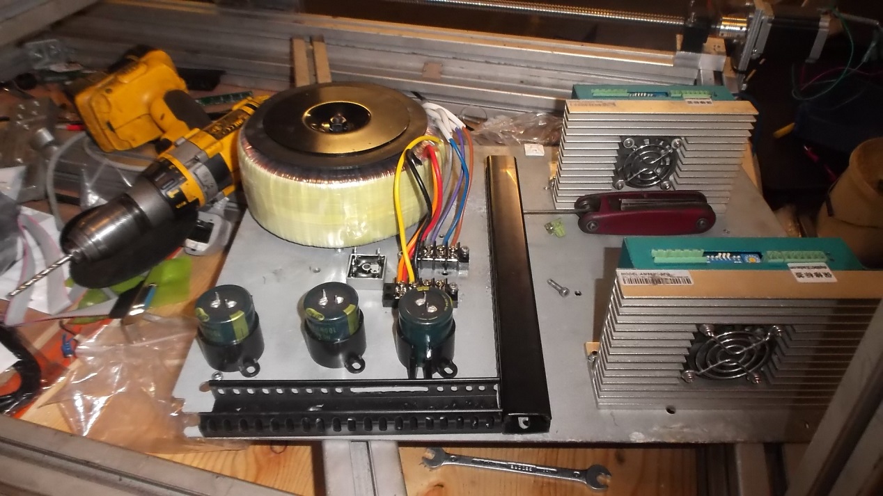

    Transformer came finally! didn't get round to soldering it but will have it up and running tomorrow ;)
    Damn just realised I wired this up wrong lol but turned it on yet. The orange and black should be joined as well as the red &yellow.
    Was tired this evening only just come home from work glad i decided to leave it till morning.

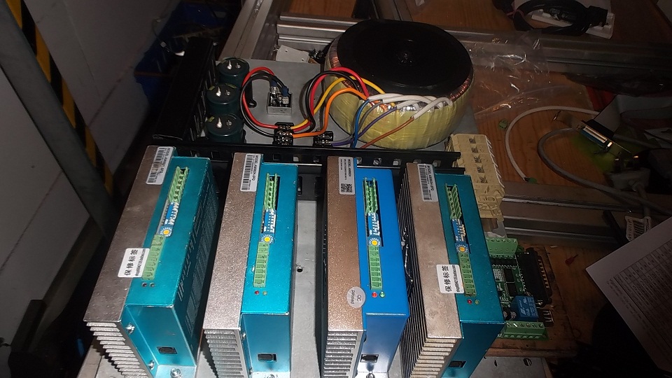

    Almost there, got some connectors on a din rail for sorting out the wiring to the BOB, still need to solder the capacitors but will get that done tonight. Looking for my holesaw set at moment so I can make the fan holes in the enclosure.
    The non working AM882 isn't bolted down just there for reference.
    I have got a current inrush thermistor which hopefully is the right one if it cause problems I'll ditch it but it was £2 so I thought worth a punt. Hopefully with one fitted I can then use a type B mcb which I can just fit in the box ;)
    I now feel it's starting to look like cnc electronics ;)

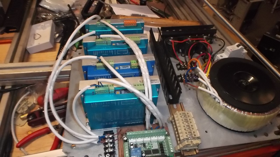

    Can I wire the stall detection output from 1 AM882 to the next then the last AM882 in the chain to the BOB?

    Short answer - no!
    Longer answer - the AM882 use an open-collector output. Think of it as being a normally-open switch that closes when there is a fault (like a stall). What you can do is wire them all in parallel and then to the BOB input. I do this with the EM806 on my machine and it works fine.

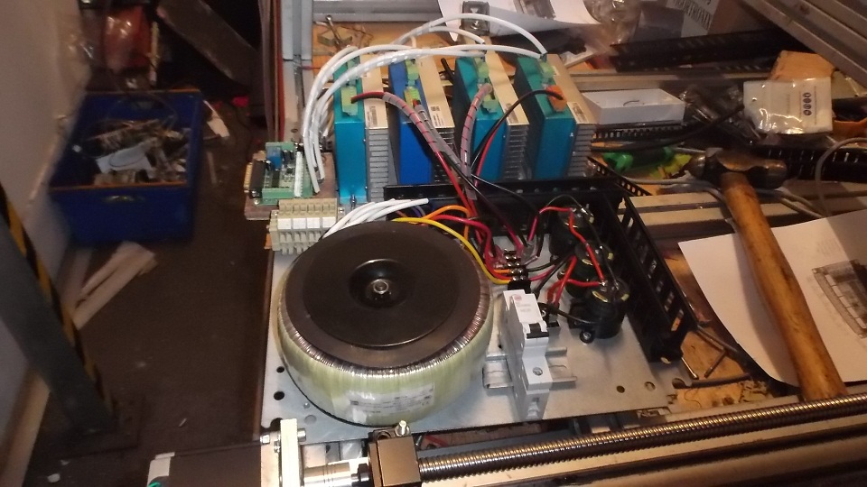

    A little bit closer, ready to mount the box and start running the motor's and home switches. Need to mount the VFD as well so I can run the wiring 12v adapter won't be here till Monday.
    Need holesaw for the fans mate has my cheapo set so going to see him tonight little bastard keeps forgetting it.

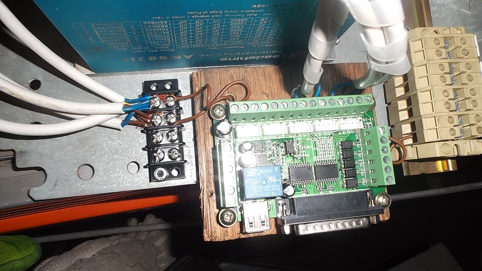

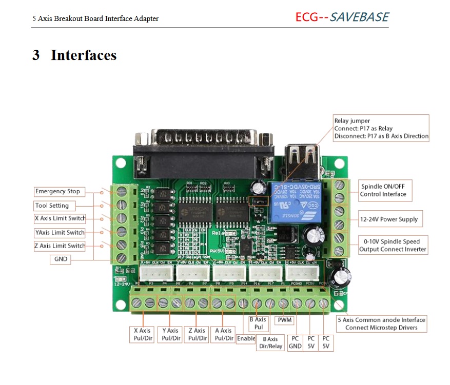

    Does this look correct it's the pulse and dir +'s connected to BOB pc 5v
Name:	BOB input.jpg
