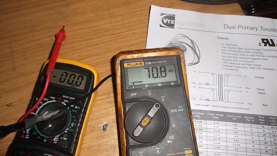

ID:	23258 that's with input voltage 252v today so happy with that ;)

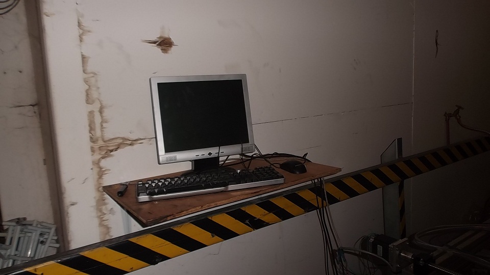

    Added 2 shelf brackets and setup the monitor, keyboard and mouse in a comfortable standing up position.Click image for larger version.

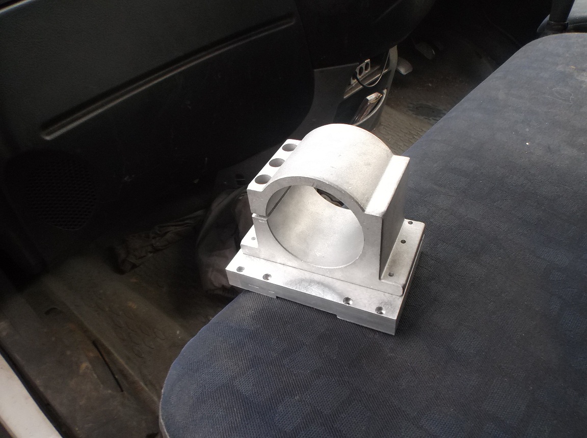

    Back's killing me today so not a lot is going to happen but did pick the spindle mount and Z axis plate up ready to refit I now should have the full 13cm Z travel I originally planned.

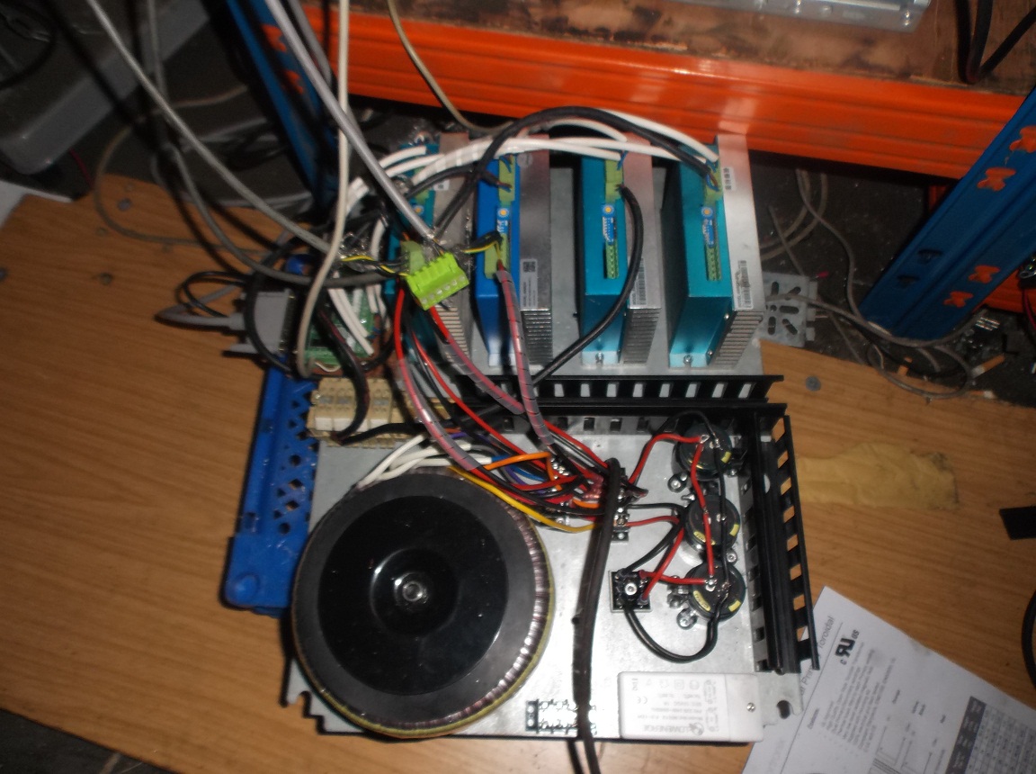

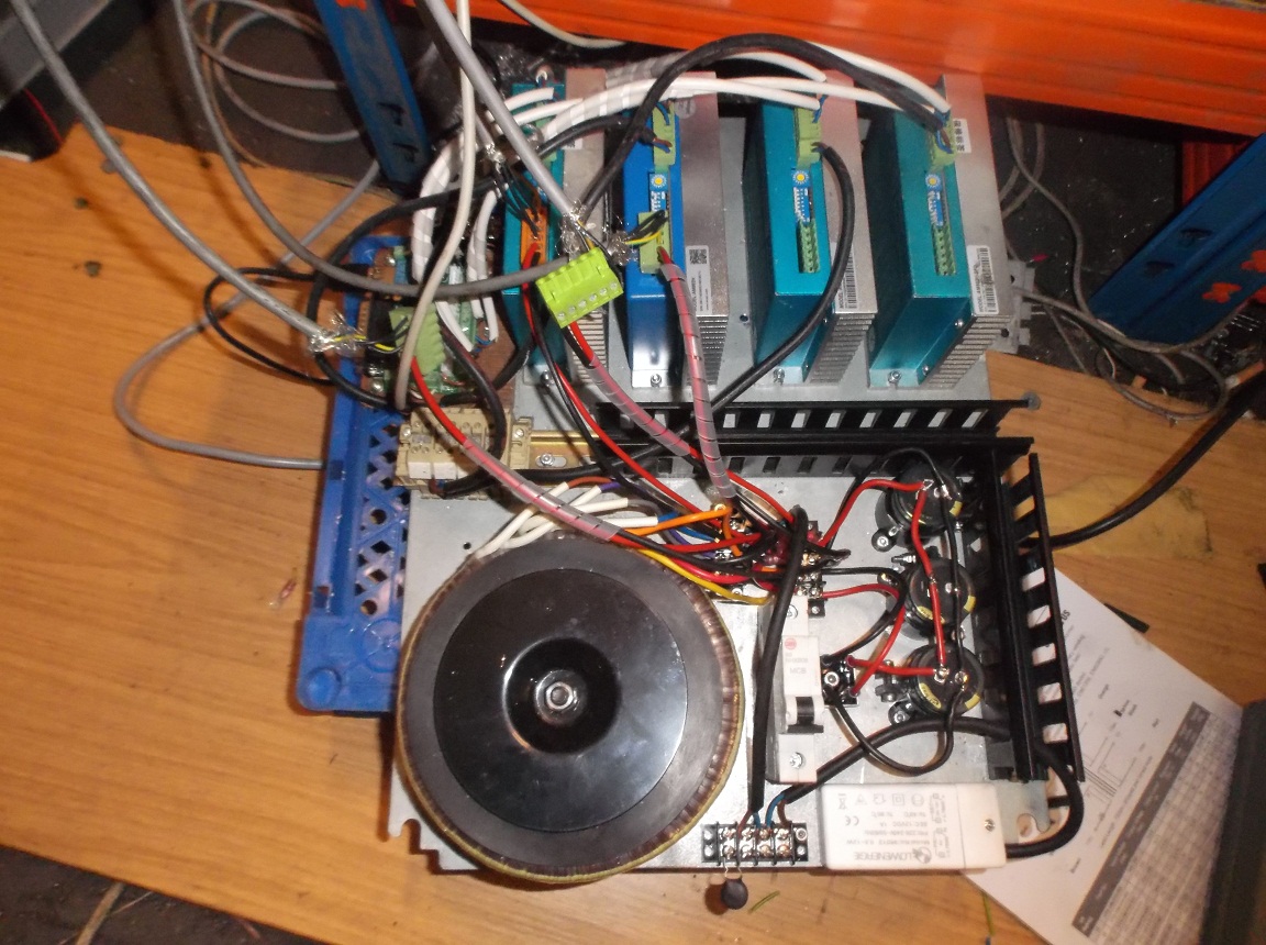

    my 12v PSU came fits perfectly in the bottom right corner (White box) and fitted another barrier terminal for power in, have the current limited thermistor as well will get that hooked this evening.
    Where's my AM882 Mr Postman starting to wish I'd ordered EM806 instead but thought I might as well stick with AM882's all round and was 1/2 the price for what appears to be identical driver.

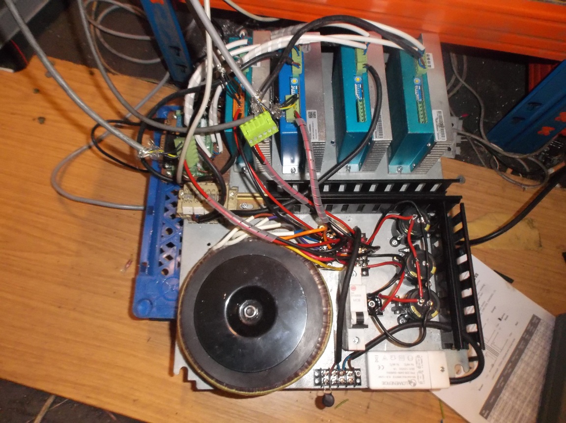

    The current limiter thermistor came so hooked it up and turned on the PSU came one OK although need to test it with load of course.
    Now need to wire it through the mcb type b then through the resistor and to the transformer and see if it works ok, now we get to see if I got the right one lol was quite confusing which one to get.
    Can't do a lot more until the last AM882 comes although getting it to move the dual ballscrew axis would be good, have got the fan holes drilled now.

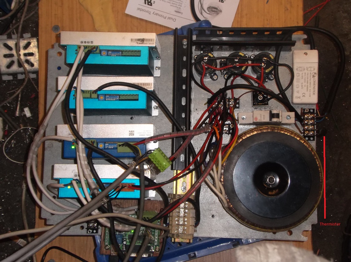

    Got the MCB hooked up and the current limit thermistor and it all works perfectly ;)
    MCB 6amp type b, trips without the thermistor doesn't trip with it. PSU appears to be running fine have to wait for the AM882 to come so I can test it under load but should be fine. The resistor is rated to 5amp once it's up to temp.
    Is there any point adding a slow fuse as well now I have working MCB type b protection?
    The 12v PSU doesn't go through the MCB only the toroidal transformer.
    This is the correct current limited thermistor for a 1kva toroidal transformer
    http://www.ebay.co.uk/itm/2x-NTC-10D...72.m2749.l2649
    If anyone else is interested.
    I notice when you turn the transformer off the AM882 stay lit for about 5 seconds and when you test the capacitors when you've turned it off they're ready 7v's so it's good to know the capacitors are mostly discharged by the AM882's at switch off although I might still add a resistor.
