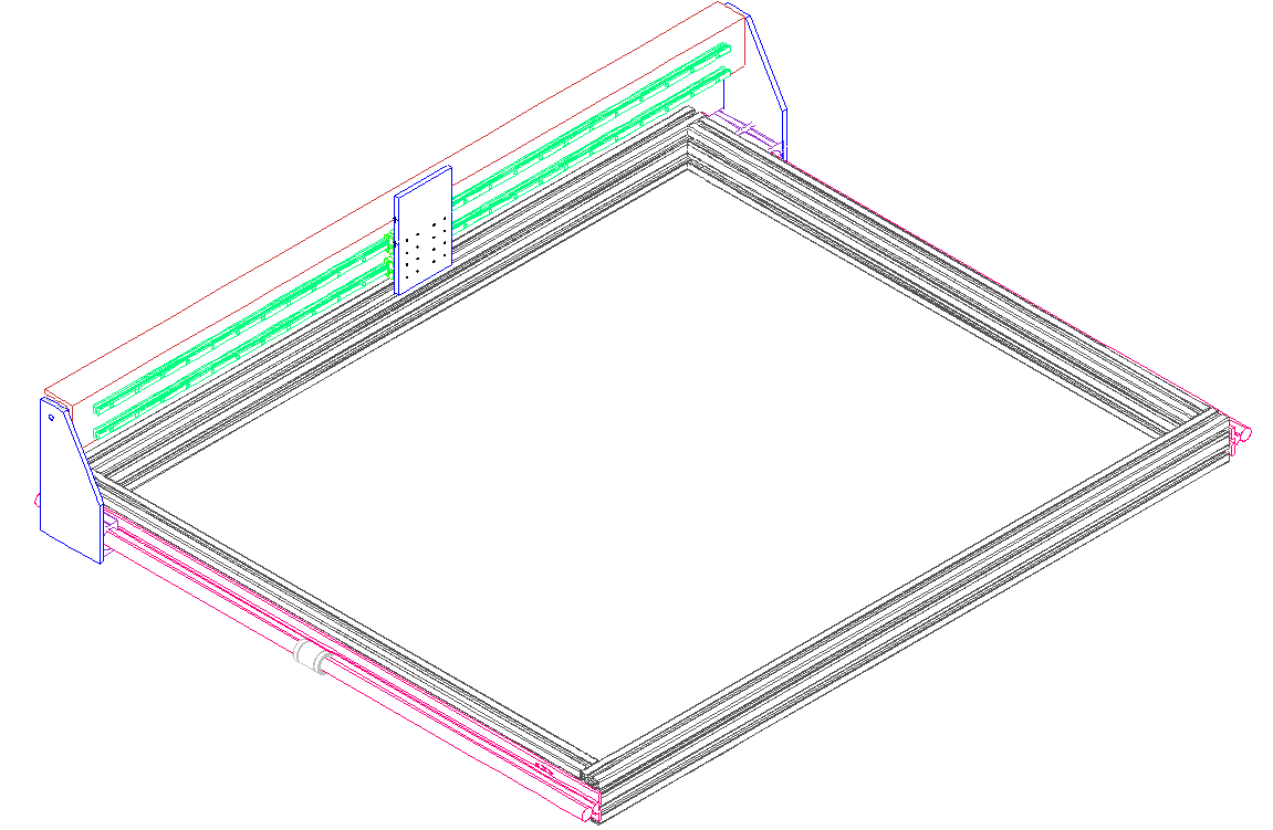

    Seems it would be better to built the gantry spanning the shorter width of the machine? Any particular reason you are building it that way around?
    Gantry tends to be the weak point in terms of allowing flex, the shorter the span the more rigid it will be for any given thickness/extrusion type.
    Morning,
    There's some logic in my madness lol I have 2 1.3m long supported rails 25mm and 2 1.5m 15mm hiwin with 4 carriages. The 25mm supported rail can handle very high load I know this because I recovered the rail from a commercial printer (I've bought new bearings all round) and it was originally carrying a very heavy gantry in the 100's of kg's and was lovely and smooth to move. The 15mm hiwin are probably nowhere near as strong so I decided that the 25mm supported rail should carry the most weight (Gantry and Z axis) and the Hiwin only carry the z axis.
    I'm committed to making the long axis the gantry as I only have 1 1.4m ballscrew and 2 1m ballscrews.
    The Gantry will be made from Heavy duty 100mm*50mm profile which I may or may not enclose in angle steel to strengthen it up.
    I want to be able to process wood at a decent speed and occasionally aluminium reduced feed rate is fine and I have compressed air on tap in almost unlimited quantities during work hours.
    I've had a score of more chunkier aluminium for the frame (I won't use for gantry it would eat too much travel) so the frame will be different and bit more square. I was going to cut down the supported rails to 1m but not going to do that now. Will update the model when I get the extrusion (Tomorrow hopefully I need to go cut it out a machine). By eye it looks like it's 9*13.5cm (2*3)

    Fair enough, just curious.
    I don't think a 100x50 will be sufficient for really good results in alu at 1.5m span, I would personally definitely consider what options you have for beefing it up.
    Just out of interest, for science n'all, try clamping each end of the profile and with a dial gauge measure the deflection in the middle when you press against it. I'm betting you can get a fairly significant deflection with moderate force.

    Quote Originally Posted by Zeeflyboy View Post
    I was thinking something like this
    http://www.steelexpress.co.uk/struct...el/angles.html
    100*65 7mm
    fitted like this

    Would add 14.2kg's + nuts & bolts to the gantry weight.
  5. #24
    That would no doubt help... maybe flip it around so you can still use your extrusion slots for mounting the rails (assuming that was your plan?).
    Best option I think would probably be to use the steel as the mounting face and look into the self levelling epoxy method of getting a flat surface, but that may or may not fit in with your budget option. If not going that route, the question becomes which is the more precise mounting surface in terms of flatness - the steel or the aluminium.

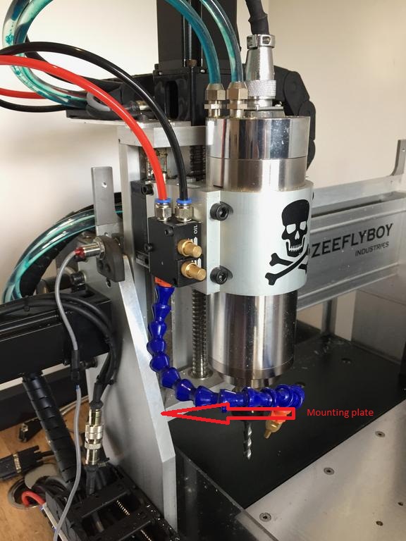

    Bit confused about what you are asking, what you linked to is literally just an inert container designed to hold oil and add it to a compressed air system to lubricate air tools.
    You need a compressor, regulator (most compressors will have the regulator), an on/off switch (whether electronic solenoid or manual), and a nozzle. If you want mist, then really the best way to do it you will need two lines, one supplying coolant and one supplying air, ideally at different pressures (the coolant line only needs a very low pressure in my experience) and a mist coolant unit on the machine.
    What you linked to wouldn't really be much use imo, the tank capacity is tiny - I use a 1 litre swimming pool filter container.

    Yes I want mist! I will want to mill aluminium to the best quality I can do given the limitations of my machine. I will have the machine in an industrial unit which has a compressor airline point next to the machine which for my purposes can be considered always on with more capacity than I could ever need.
    Do you have a pic of how you linked yours up?

    Actually as luck would have it I did recently post some pics here:
    http://www.mycncuk.com/threads/10658...1180#post91180

    Lovely setup ;)
    How thick are you mounting plates Click image for larger version.
