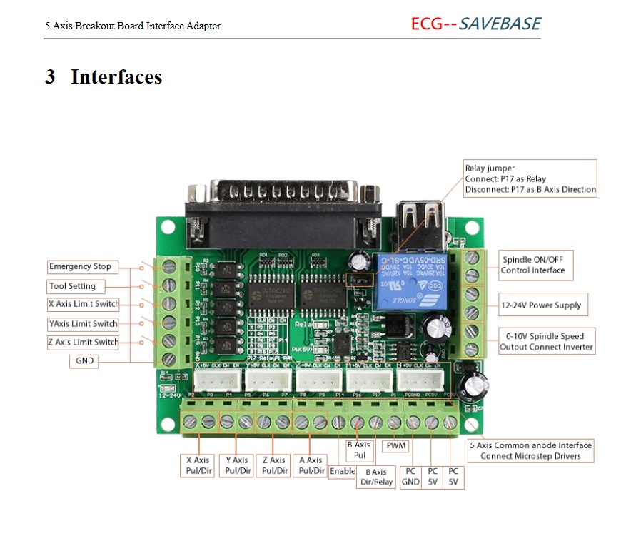

    Quick question the 12/24v spindle input on my BOB which is + and which is -? I assume left would be - and right +
    have you looked under the board on one of those that I have it is printed on the pcb. On mine +ve is third from the cap and -ve is forth. I am talking about the power supply input.
    No I didn't before I bolted the BOB to the plate and the plate into the box lol, but I have an identical BOB luckily spare so will check that one ;)
  11. #430
    I think its like this
