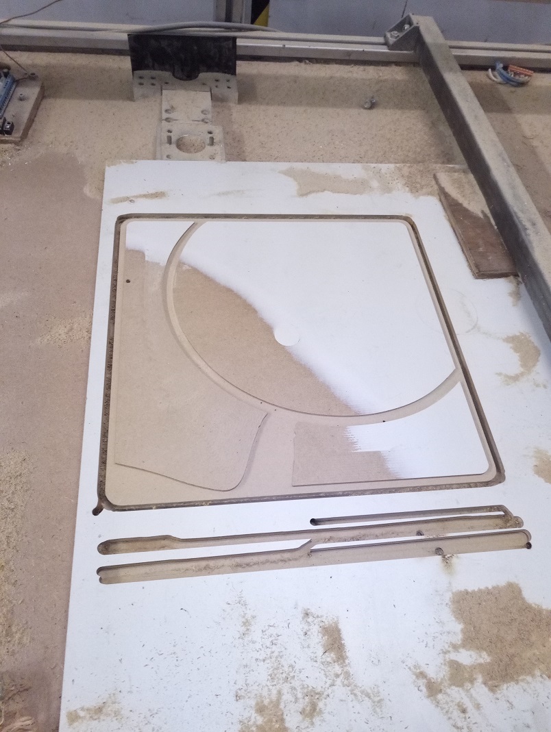

    Very impressed with the cut from the 2 flute 6mm end mill on the laminate I was expecting mega chipping.
    Because I only clamped one side it wasn't even so the white wasn't milled out properly but it was only a test with some scrap so happy how it came out as soon as my clamps come (Ordered 4 toggles clamps going to use 2020 extrusion across the bed instead of steel.)
