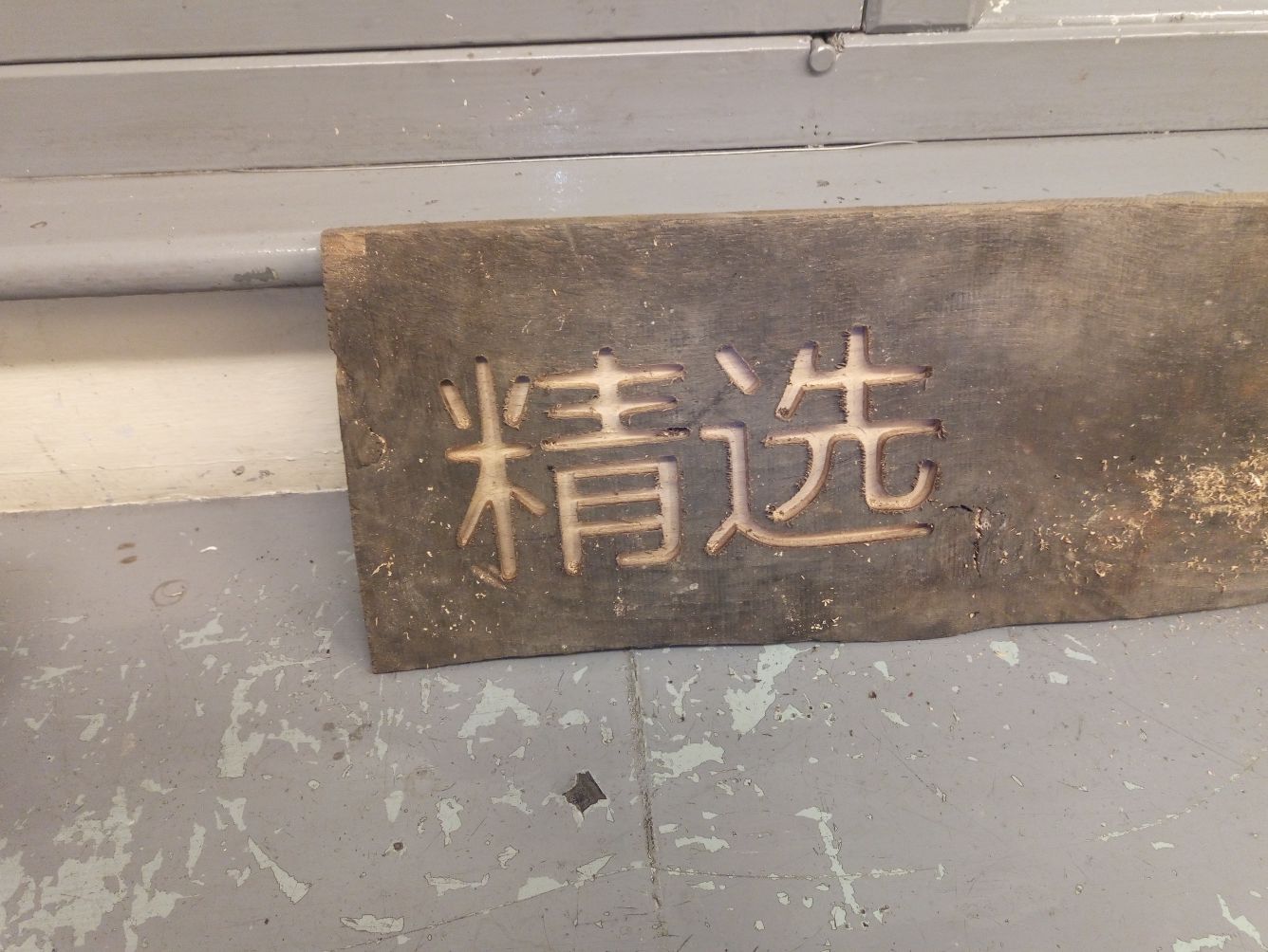

    2 flute carbide end mill, what bit do I need to get a better finish (Ripping) or it speeds? This piece of wood is at least 60 years old mate found it in a pile of wood his dad bought in the 1950's at auction. This piece of wood was far from flat lol. This is only pocket clearing with no finishing pass.

    This is just a guess but have you tried a downcut bit? As you are not cutting straight through it should leave a good finish on the topside?
  11. The Following User Says Thank You to Nr1madman For This Useful Post:
  12. #560
    As Robert said ,down cut bit, slower feed and............ put self adhesive tape at the side you cut, after the cut remove it and you will have a cleaner cut.
