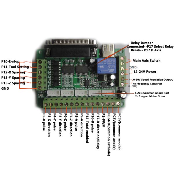

    I have built a machine following this and the Joe Harris build. I am using the same BOB and having read all the way though my question is, I am using a dual ball screws and could you confirm the wiring on the inputs for the limit switches.

    I'm going to assume you want to use the limit switches as home as well.
    What software are you using on the computer?
    Do you want to dual home the gantry?
    How many home switches do you have?
    On that 5 axis BOB I have P12, P13 & P15 you would normally use for X, Y & Z limits in linuxcnc or Mach 3 you can also assign these pins in software so what matters is you're wiring matches how you assigned the pins.
    If you want dual homing you can share the input as long as it's not the same axis. Needs to be set in software. You can also use the p11 tool setting as another axis.

    Cheers for the reply,I am using Mach3 as my software and have the machine working on it. I am at the stage of fitting the limit switches, I want to do dual homing on the gantry and keep the tool setting function.

    you have 3 inputs pins and 4 inputs X, Y1, Y2, Z
    Something like
    P12 X
    P13 Y1
    P15 Z & Y2 set as shared. Since you use Z the least seems the simplest solution. Setting the pins in Mach 3 should be easy but I don't use it so you'll have to ask others.
