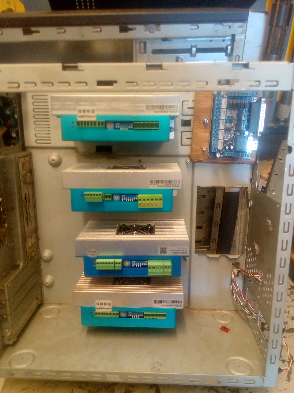

    Had a bit of time today so thought I'd start on the wiring but realised I'm missing 2 of the power input connectors on the stepper drivers, does anyone know what they are called?
    Not going to try and cram the transformer in after all would be tight in the case and I would worry about heat, got loads of space under the router more than enough for everything.

    Lives in Marple Stockport, United Kingdom. Last Activity: 10 Hours Ago Forum Superstar, has done so much to help others, they deserve a medal. Has a total post count of 3,347. Received thanks 620 times, giving thanks to others 90 times. Made a monetary donation to the upkeep of the community. Is a beta tester for Machinists Network features.
    https://www.aliexpress.com/item/Lead...530226703.html

    Nice once Clive ;) but I don't want to wait that long just trying to ID them from Rapid online catalogue.
    Hoping I can get them by Saturday so I can finish the wiring over the weekend have been busy last couple of weeks and she's so close to cutting now.
    The drivers have 3 plug in sockets, 2 of my drivers are missing all the plugs, 1 of my drivers has 2 6 pin plugs but missing the 2 pin, the last driver has all 3 plugs.
    e2a
    I think this is one set of 6 (P1)
    https://www.rapidonline.com/truconne...3-81mm-21-3094
    Pretty sure the 2 pin plug is not needed for my application.
    the other 6 pin (p2) I think is this one
    https://www.rapidonline.com/truconne...-pitch-21-2844
    Will try locally if I can't get them then will buy from rapid sure I can cut down a 6 pin to a 2pin if needed (Same pitch & profile)
    e2a just ordered from rapidonoline as they don't have locally, got some CY cable as I was short so will have to wait for delivery but hopefully by Monday.
    I assume I can use 2 core 0.5mm flexible cable from wilkos for wiring the AM882 drivers to the BOB?
