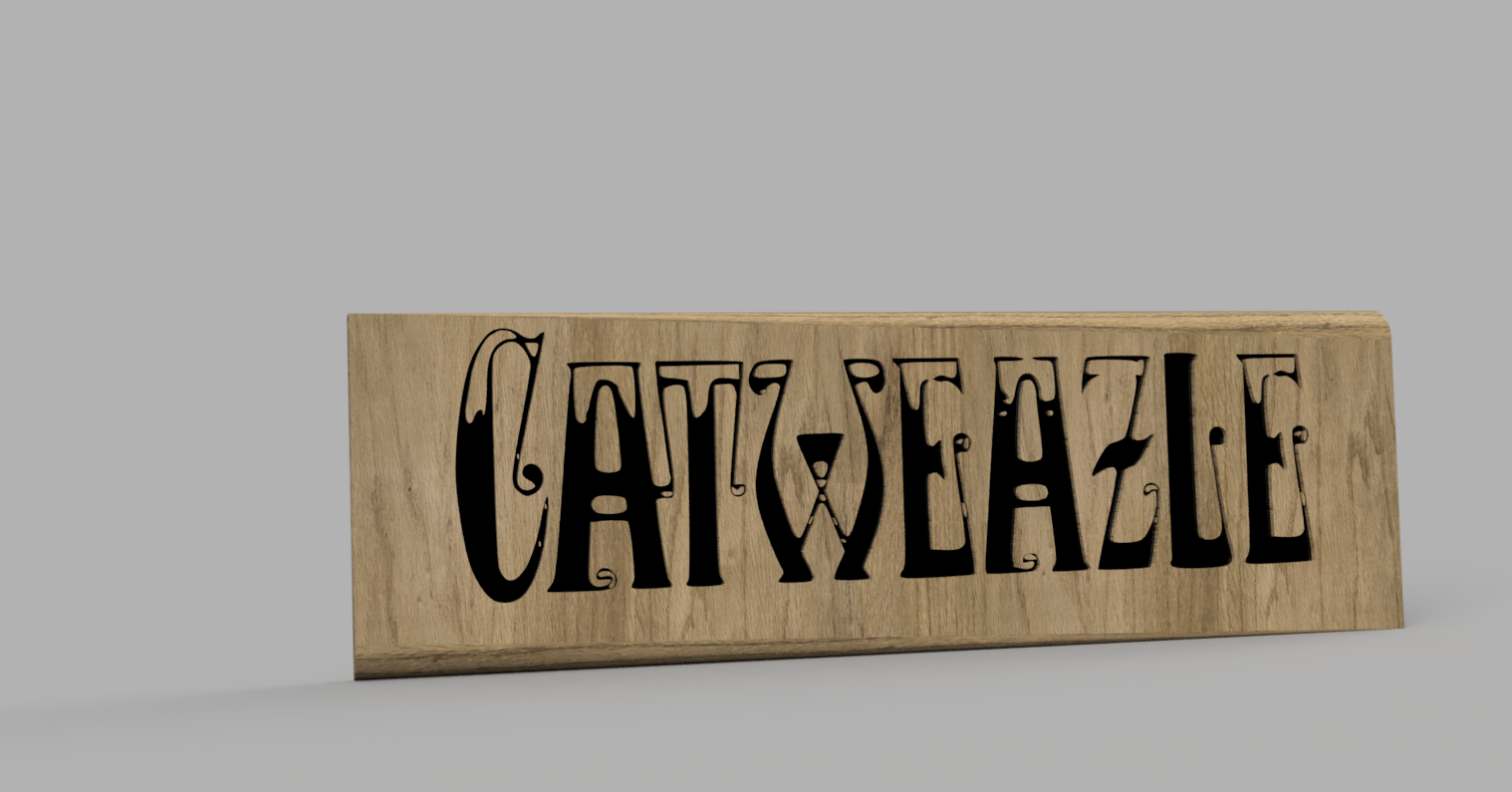

    Mate wants a catweazle sign to name his pond so mocked him a quick on up last night.

    Was discussing dust shoes last night and my mate suggested I buy a brush head cut the centre bristles out and drill 2 holes in it and add some magnets.
    Found the idea interesting and also very simple so going to see what brush heads I can get today.
    Have you seen these https://www.ebay.co.uk/itm/80mm-Spin...%257Ciid%253A1
