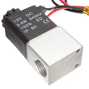

    I've been meaning to make this for a while - it's a laughably simple project (for all but the electronics simpletons like myself).
    So, I'm going to base my circuit on this one:
    http://www.555-timer-circuits.com/flashing-led.html
    ...except I'll be using a 12v PS and one of these instead of an LED:
    R1 and R2 control the speed at which the LED flashes - or rather (I'm hoping) the solenoid will open and close - as it is, the led flashes rather quickly - I'm planning to replace these two resistors with a couple of linear pots so that I can adjust open/close times - any recommendations for pot values I should be looking at..?
    Also, the cap value? As I'm using a 12v supply will I need to change the cap - what difference would a different value make to this circuit?
    Finally, will this work..?! Have I correctly assumed that R1 and R2 are independently controlling open/close times?
    Any advice appreciated..!

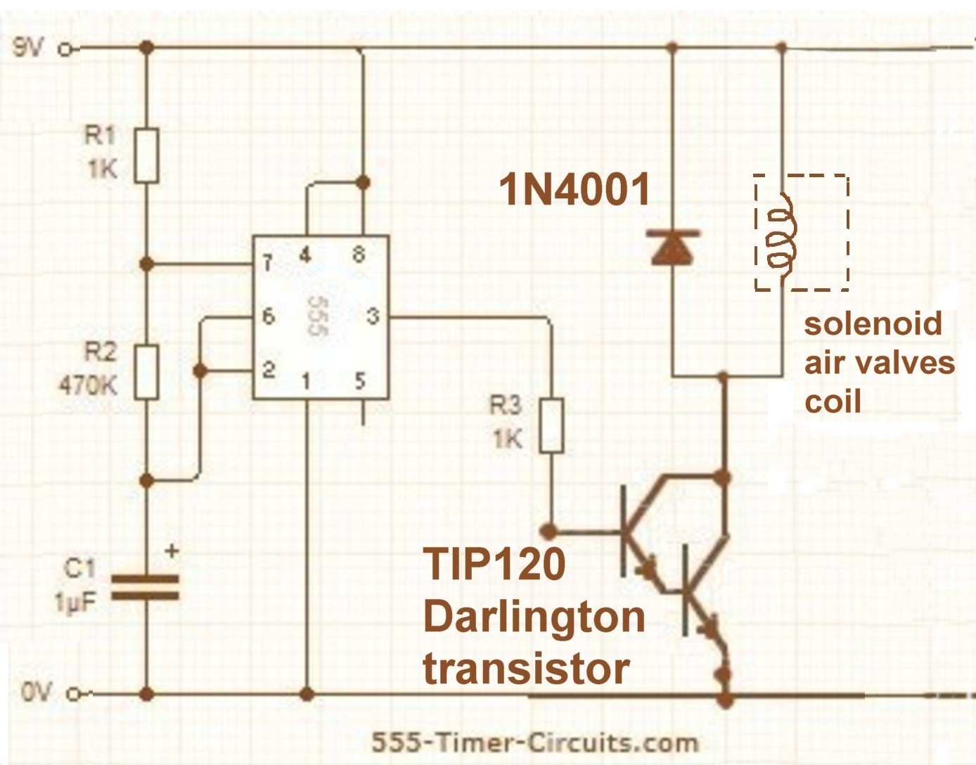

    I would expect the NE555 can not provide enough current to operate the
    solenoid valve without the addition of a high gain power transistor
    like the TIP122
    the 1N4001 across the coil is the flyback suppressor diode
    when the transistor is switched on the diode is reverse biased so it does not conduct
    when the transistor switches off a large back emf is produced
    the diode provides a path for the current to flow instead of
    driving the transistors collector more positive than the positive supply

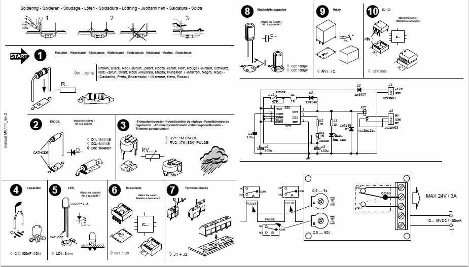

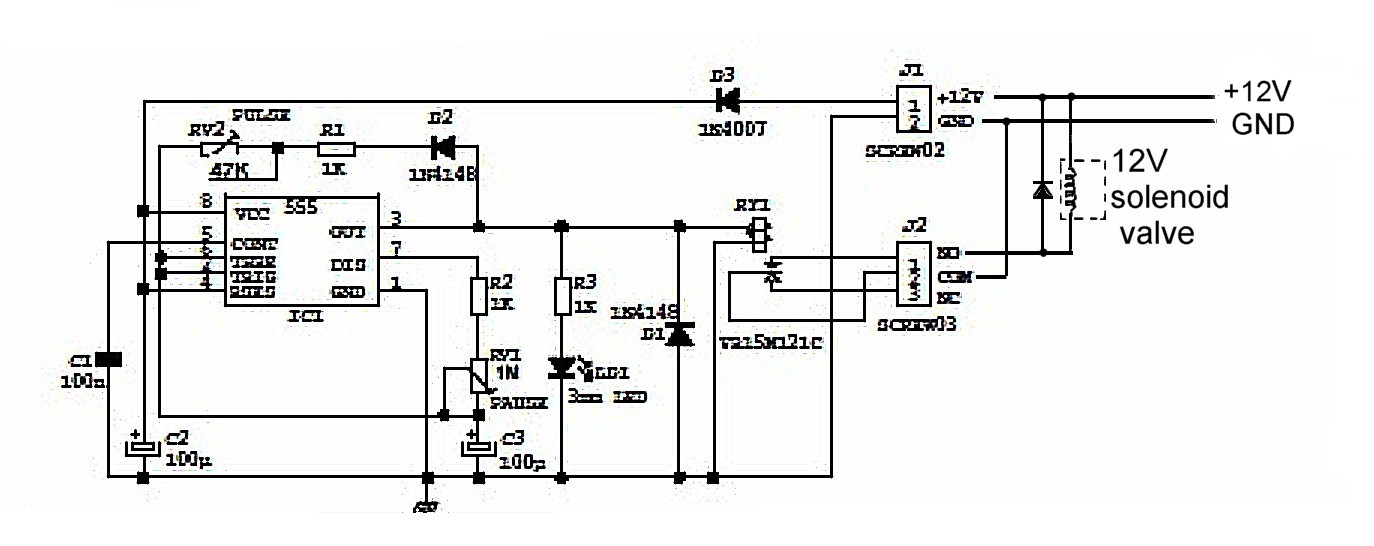

  11. #8
    Hi Wal
    the Velleman kit should make it easier
    looking at the circuit it runs of a 12V supply - ideal for your solenoid valve (don't forget to add the diode across the coil)
    MK111 kit
Name:	mk111 plus valve.jpg
    John

    Quote Originally Posted by john swift View Post
    John
    The 555 can source or sink up to 200mA, so should be OK to operate most relays directly. The 555 is a useful timer chip, but I tend to use arduinos, especially for really long delays.
    Cheers,
    Rob
  13. #10
    Cheers,
    Rob
    ...but 12V 6.5W is over 500mA, so if he is going to use the solenoid on the picture he needs a transistor, or a small relay in between the valve and the 555. The 555 is OK for small relays but not for solenoids.
